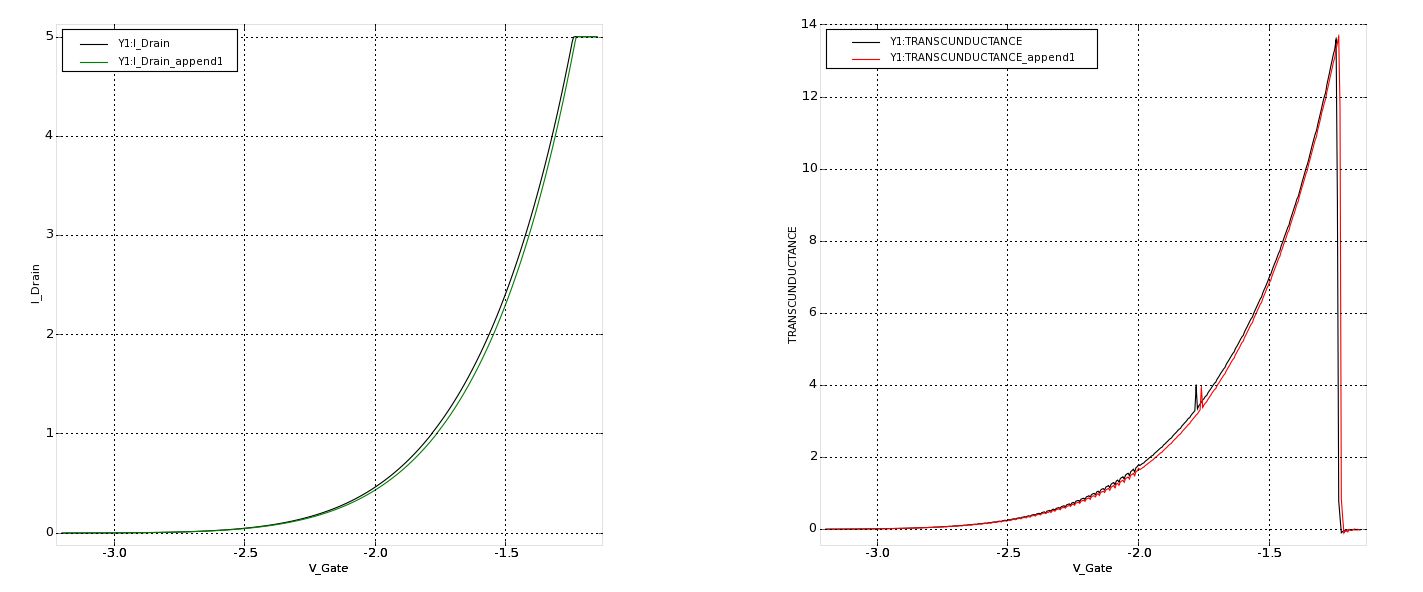

From running simulations of EUVL's model, it appears that the output clips well before 30 watts into 8 ohms. I had to raise the rails to + / - 26V to obtain the voltage swing (43.7v p-p).
The FW J2 manual states 200W power draw. That would be 50W per device. At 26V, that would be 1.92A. Does 1.92A bias sound correct?

I noodled around with the model with high bias. Too much power into 4 ohms to match the User Manual specs.
My guess is that the power draw is worst case at 60 watts output.
So, subtracting 60 watts output from 200 watts and dividing by 4 and then dividing by 26 volt rails gives 1.35A bias. This assumes zero power losses in the transformer, rectifiers, source resistors, etc.
I have re-worked EUVL's initial settings to achieve 30W at 8 ohms with nearly symmetric gain up to onset of clipping.
It appears to me that + / - 27V is required to achieve 30W at 8 ohms just before the onset of visible clipping.
Bias is probably still too high but much less than 2A.
It looks like gain is too high compared to the User Manual. Add more feedback.

Some observations. At 1.8-ish amp bias, the 8 ohm power output is 30w and the 4 ohm power is 40w.
At 1.35A bias, 8 ohm power is 29w and 4 ohm power is 22w.
To get to 15w at 4 ohms, bias should be reduced below 1.35A.
When I build, I am going to stay above 1.35A bias. I have the IXYS current source lashed up and trying various resistors to get the bias and proportion of the center tap that I am looking for. The proportion is 1/5 of total resistance at the top and 4/5 at the bottom. This will be for a first-pass to get the output signal on a scope.

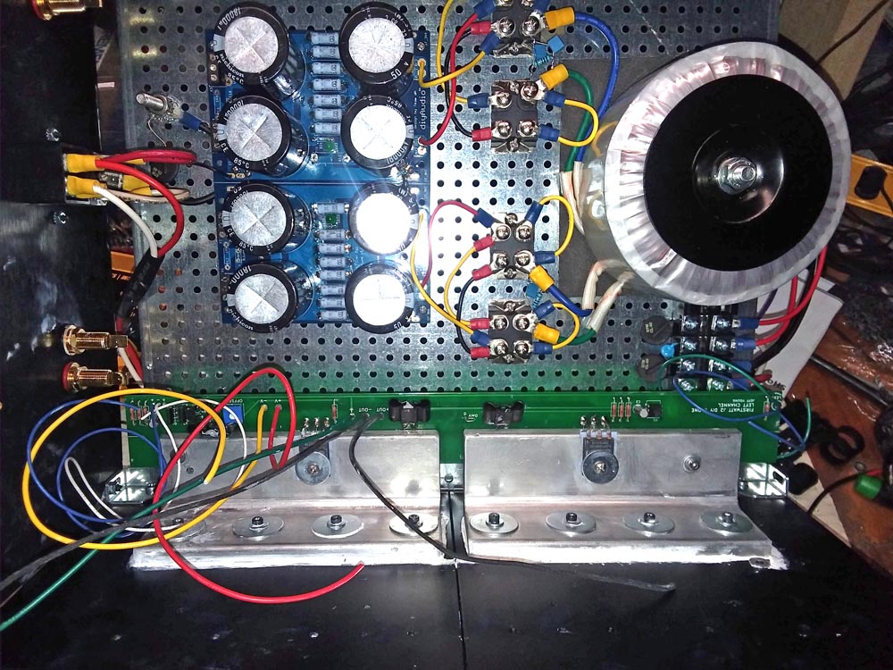

Well people, I'm going to put the power to the first channel tomorrow. I could do it today, but I love the process and am in no real hurry. So tomorrow is the day, let's hope there's no smoke!
More resistors than needed, but they were just sitting there, so... 🙂 Also, you will will notice an ah, unorthodox rectifier I had some expensive halfwave fast soft laying around, and cobbled them together for a full wave.
Also, per Jeff, I did not sink the resistors to the main sink, but got some snap-on. He said they really didn't get hot enough to worry about them, but I still thought it prudent, when they cost about .20.
You may also note, one of the bleed resistors doesn't appear on the board... There was a senior moment and the wrong value was installed. In the process of take them out it got a little harry, so I mounted that one on the bottom of the board.
