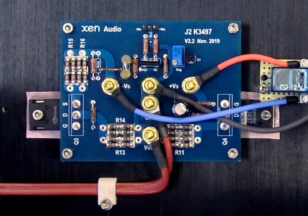

Someone asked for a larger image of the PCB.
Here you are.
