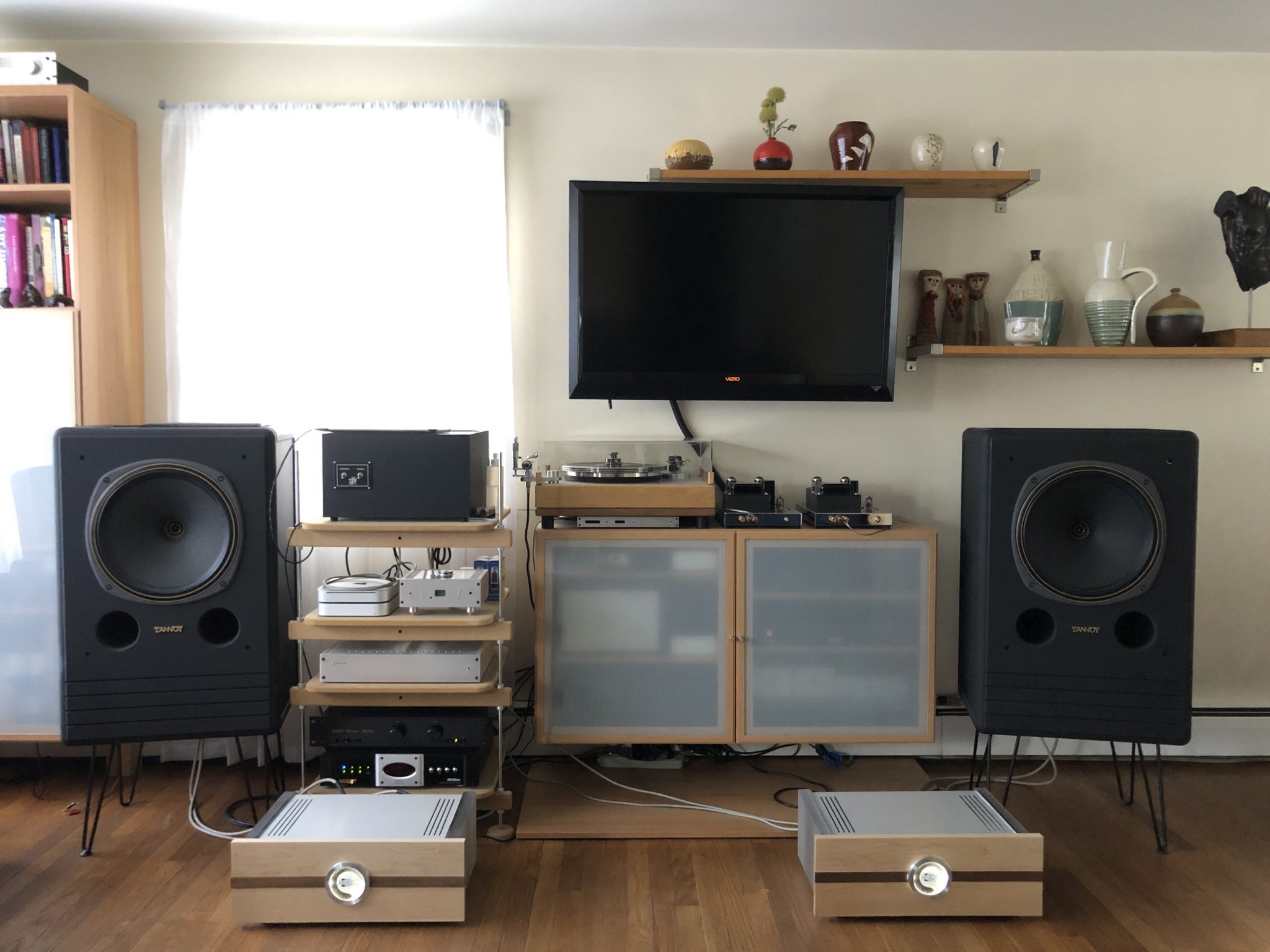

I have one pair of SS. If I can't get a second pair of Semisouths somewhere, I have an "emergency exit" with a pair of Toshiba from a GB. However, I am waiting patiently for the end of J2 production and I hope for the documentation will be available.
I’ve put aside some pairs of curve trace matched R100 and some j109/j74 in case, by miracle, production ever ends and the circuit is made public and blessed by Papa.
I’ve also hoarded some other matched and unmatched pairs.
I’ve got a bit if a JFETish.
So in the mean time, I build using sockets to avoid damage to my unobtanium so I can reuse them in different designs.
Most recent build is a pair of Babelfish J2. I’ve built them all IRFP first for testing…still troubleshooting some noise in one. Once they are both good I’ll plug in the SS and make appropriate resistor adjustments and reset bias and offset.
I’m curious to compare ZMs all IRFP to SS down and possibly an all SS version.
I also have Jeff Youngs J2 boards that I wanted to try.

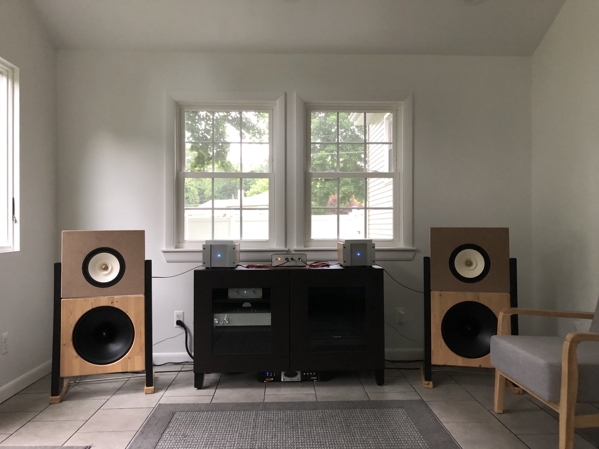

Currently using F2J in my sunroom system with OB and the J2 were last in the main system bi-amping Tannoys.
I’ve tried SS down in ACA as well…they added the usual improvements. I left them in for now even though I don’t use them much. I would like to build two more channels and bridge them along with SS to see the results.
I work slow…🐌
