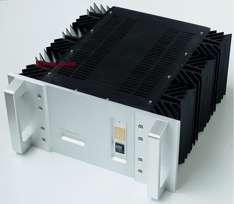

Now this is a beautyfull chassis. I like the construction. Selfmade? Where can i order this?.
Everything works according to plan.
So mission accomplished.
Patrick
Classic engraved MARK LEVINSON ML2 full aluminum amplifier chassis enclosure JC3 | eBay
But without the ML marking.
Special order from Breeze Audio direct.
And of course you can use 2x Tx for fully dual mono build.
We use 1x 300VA only because we have them in the store.
Again, no need for 70µm copper PCBs.
Actually better than 70µm as 2x 35µm has less inductance and skin effect.
Patrick
Seems this is a moving target - new link now.
But look, 340 mm wide. The original black ML-2 chassis is 19" wide. So engraved or no, it is not an exact copy of the original. But still fully usable as a chassis for some amp of course. If so, I would have purchased a l"no logo" version.
/RK
The original ML2 looks like this (attached on the left).
I don't think you can call the one I bought a carbon copy, despite whatever has been engraved on the front plate or not.
It is a pity that they have still left the engraving on at ebay offers (under the same description but different addresses).
But you can find a lot of nice chassis on offer from WeiLiang :
Power amplifier case - Shop Cheap Power amplifier case from China Power amplifier case Suppliers at weiliang audio Official Store on Aliexpress.com - amplifier case,aluminum amplifier case,breeze audio aluminum,amplifier chassis,breeze audio,aluminium chassis
including 480x500x215mm ones :
Brise audio 50W ClassA verstarker aluminium chassis/fall BZ4822A|aluminium chassis|breeze audioaluminum chassis case - AliExpress
Postage is unfortunately a big chunk of the total price.
Patrick
