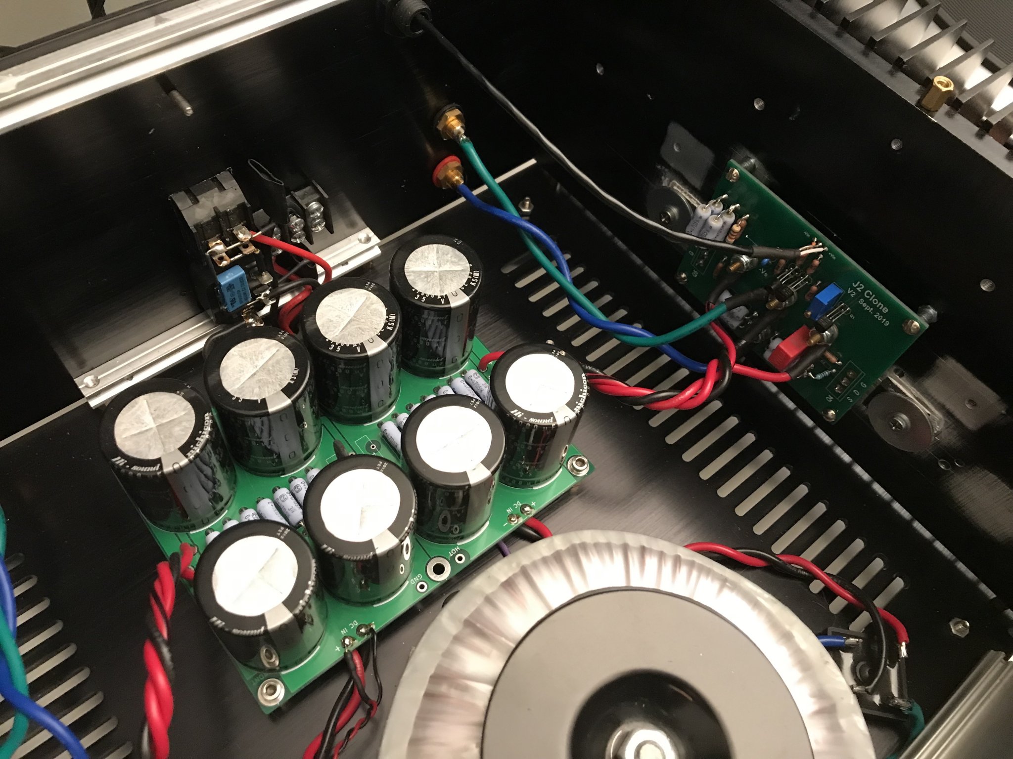

My J2 is finally up and running! J2 Pcb from EUVL, psu updated and beefed up with Jeff Young pcb, jfet from Punkydawg, on the output IRFP150 and most of all the SS generously given by Mr Pass last year. It’s running at 1.35A at this time.
I have been listening to the M2 and the Vfet part 2 for most of the last year and I must say that the J2 is sounding really really good. Nice extended bottom end, super sweet extended top and a quite a lot of power.

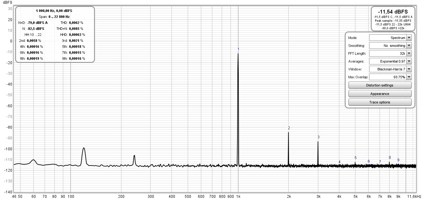

I was finding the J2 to sound a little muffled and flat at first, but after testing it with DiAna for the phase of the second harmonic I’ve realized that I was listening to the amp with a positive phase second harmonic. I’ve reversed the polarity at the input and output and now I have the negative phase second harmonic. I can’t believe how big of a difference that make!
Question : I know there is some people that have altered the ratio of the resistors on the output to get the right 2nd harmonic phase. Is there a real difference between what I have done the get the negative phase and changing the resistor ratio?

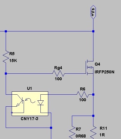

Just to be shure that I’ve got that correctly. Does increasing R5 on this partial schematics would reduce the gain of the mu follower? I already got the degeneration of the negative output device a little bit lower to 0R11

If you adjust the ratio between the two power resistors in the positive current source you will get what you are looking for.
Their sum needs to remaIn the same (or close). If you really want to play, string a series of .1 ohm resistors to that sum and tap the output off the individual points. As the upper resistance increases the gain of the upper transistor goes down.
That all make a lot of sense. I will experiment around this and report back. From my ltspice simulation it seem like a small change can make a difference. Thank you again!If you adjust the ratio between the two power resistors in the positive current source you will get what you are looking for.

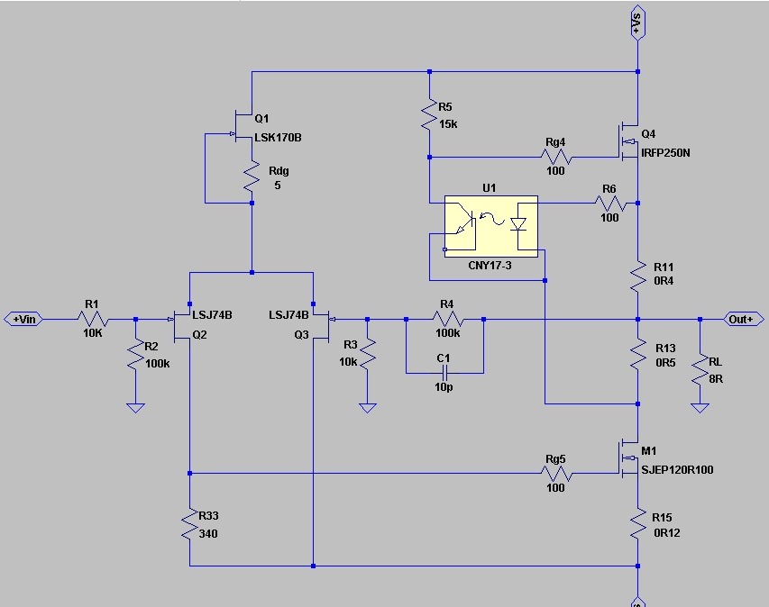

post exact schematic you're using, and I'll comment on that
btw. Babelfish J2 is far from original J2 schematic, even if some crucial values are xerox from Pa's ( no wonder)
Oh thank you Zenmod! It’s running at 1.35A approx with standard fw psu. The 2nd harmonic is positive and I think it could be a little bit higher compared to the 3rd to be closer to the spec of the real J2.
you also need small or bigger elco cap, connected across C-E of opto bjt
(maybe it is just missing on LTSpice schm, not in vivo)
anyhow - ref. to schm you posted, you need to obtain (0R4+0R5) sum of R11 and R13; so while you have sum of 0R9, vary their (R11, R13) ratio and you'll vary contribution of Mu follower in output signal
more for R13 (less R11) Mu is working more ......
when you're happy, stop and use these values for good
Pa gave you nice trick - for test - made that R11 of 4pcs of 0R1, then just tap output from various stages in 4*0R1 string ....... easypeasy

Ah exactly the help I was looking for. You’re right the cap is missing on my simulation. Now it will behave a little bit more like the real thing 😅 I don’t know how I could have missed this.. Thank you!

I’m using DiAna with a focusrite interface to analyse the harmonic spectrum of the amp in vivo. Here’s the result before I inverted the input and speaker output of the amp to reverse the phase of the 2nd harmonic. It seems to do a good enough job to help tweek the ampNext step, get or make a simple distortion analyzer. Spice is reliable, but the semis, not quite so much.
