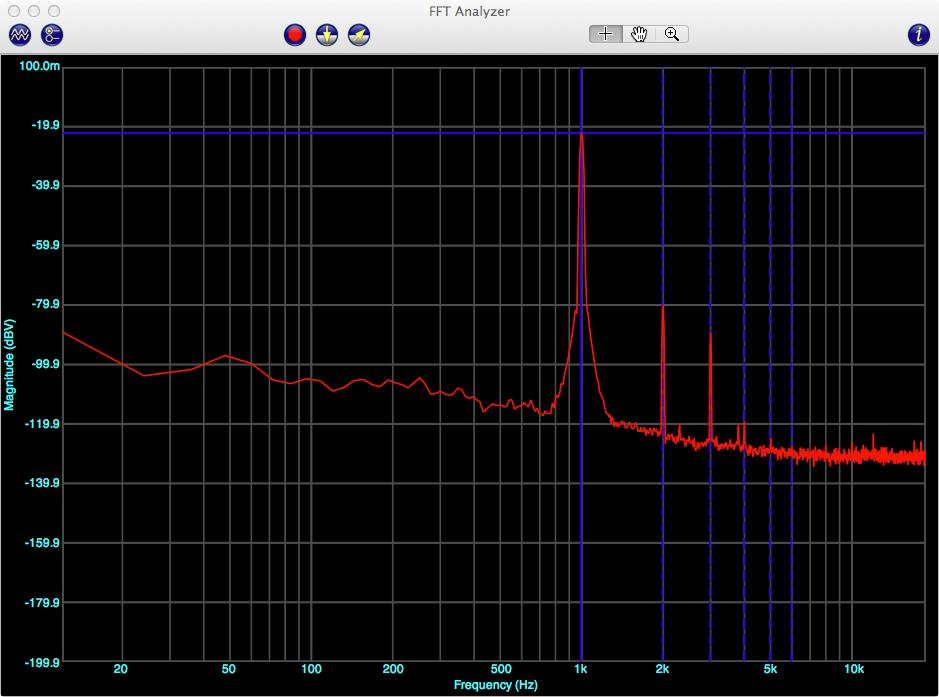

That looks just pretty good: somewhere around 0.1% THD with H2/H3=10dB. I assume that spectrum is for 1W into 8R at 1kHz.adjusting k2......

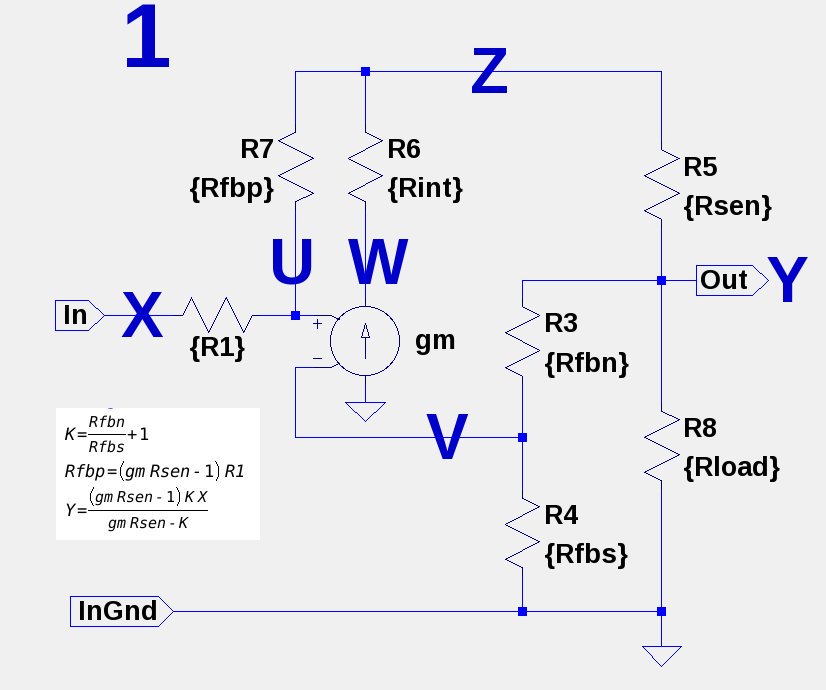

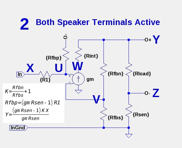

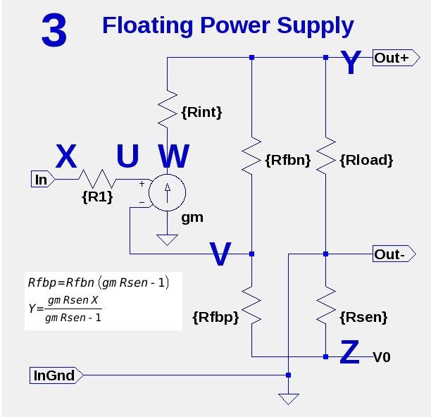

I have figured out the equations for the 3 circuit topologies shown in post #269 http://www.diyaudio.com/forums/pass-labs/275921-first-watt-f7-review-27.html#post4565114. In all cases the solution is that which makes the output insensitive to the load resistance, i.e. infinite damping factor. These equations are simple enough that the topologies can be compared.

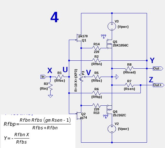

Something like this?
Mine was a little different than that.

Can you please explain what Rint and R1 actually are ie: what values they are.
Rint is the internal resistance of amplifier, and gm is is its transconductance. In my earlier posts I was incorrectly using a voltage=>voltage amplifier model, where Rint is necessary parameter to characterize its behavior. With the correct Voltage => current model, gm incorporates the output MOSFET transconductance and internal resistance model into a single gm parameter.
R1 is an free parameter in the design for use both as a gate-stopper to the JFETs and to tune the -3dB rolloff of the amplifier.
