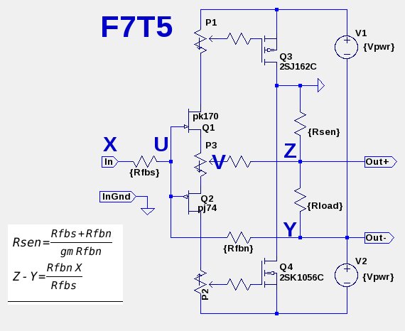

The circuit in post #397 is totally bogus. But here is an abstract version that appears to work. This circuit has an inverted output and infinite damping factor.
From the Y equation , R1[input Z] =10K [spec], and RfbN =47 K for a gain of -4.7 [close to spec]. These two R values are then plugged in the Rfbp equation to give:
Rfbp = 8.25 {Gm x Rsens -1}. Rsens is/has to be small in value; say 0.5 Ohms, and make Gm = 5 A/V. So, Rfbp = 8.25 x 1.5 = 12.4 K
The value of Gm needs to be known with certainty. If not, then start with a high valued Rfbp using standard resistors; say 47 K, and decrease its value to 39K, 33K, 27K, 22K, 18K 15K, 12K 10K...until the amp oscillates if this design allows it.

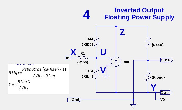

And here is a circuit that simulates fairly well for the abstract circuit of post #401.
Is the suspected PSU in F7 two floatings ones for L and R channels? In the equation to determine the value of Rfbp, set the value of Rfbp to an arbitrary 1000K [1 Meg]; meaning a trivial extent of positive feedback; meaning it defaults to a phase- inverting diyF5. The resultant value of Gm x Rsense ~ 122. If Gm has an actual value of 5 A/V, then Rsense = 24 Ohms. Since Rsens = 0.5 Ohms [can't change it], then Gm = 244 A/V.
Damping factor is defined as the impedance of the load divided by the internal impedance of the power amp driving it. A damping factor which has an infinite value requires the internal impedance of the power amp be equal to zero; which is appears to be a principal objective for diyF7.
Going back to Post#365, plug in the two given equations zero Ohms for Rint. Granted OLG and CLG are exactly known, then the unique value of RFbp is calculated which satifies Rint = amp's output impedance = zero.

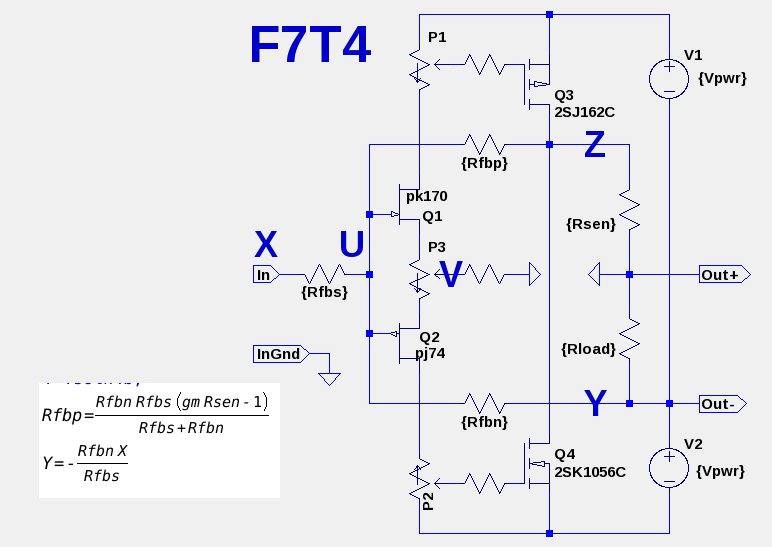

And finally, I think I have the circuit Nelson eluded to in post #392, which has fewer resistors yet.
Interesting circuit. The power output Mosfets operate in the common drain [grounded] configuration. This means that the phase inverted power output voltage emanates from the naturally low impedance of the Mosfets' opposed sources. The open loop voltage gain of this amp is solely from the complementary JFETs; because the voltage gain of the Mosfets is 1
The node at the joined JFET's gates is a virtual ground or a summing junction of two out of phase AC signals. Except there is an AC feedback voltage [from OUT+] to the joined sources of the JFETs. The JFETs now do additional/independent amplification operating in the common gate configuration; essentially generating the closed loop gain which is lower in value than open loop voltage gain.
Interesting circuit. The power output Mosfets operate in the common drain [grounded] configuration. ...
Actually the output FETs are running common source with the power supplies floating. If you look closely the gate-to-source voltages (Vgs) are defined by the currents thru P1 and 2, whose wipers connect to the gates and another terminal connects to the source.

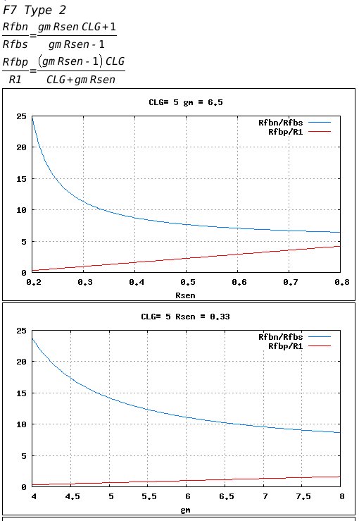

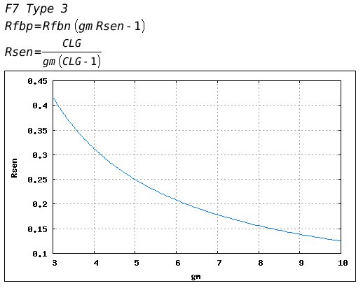

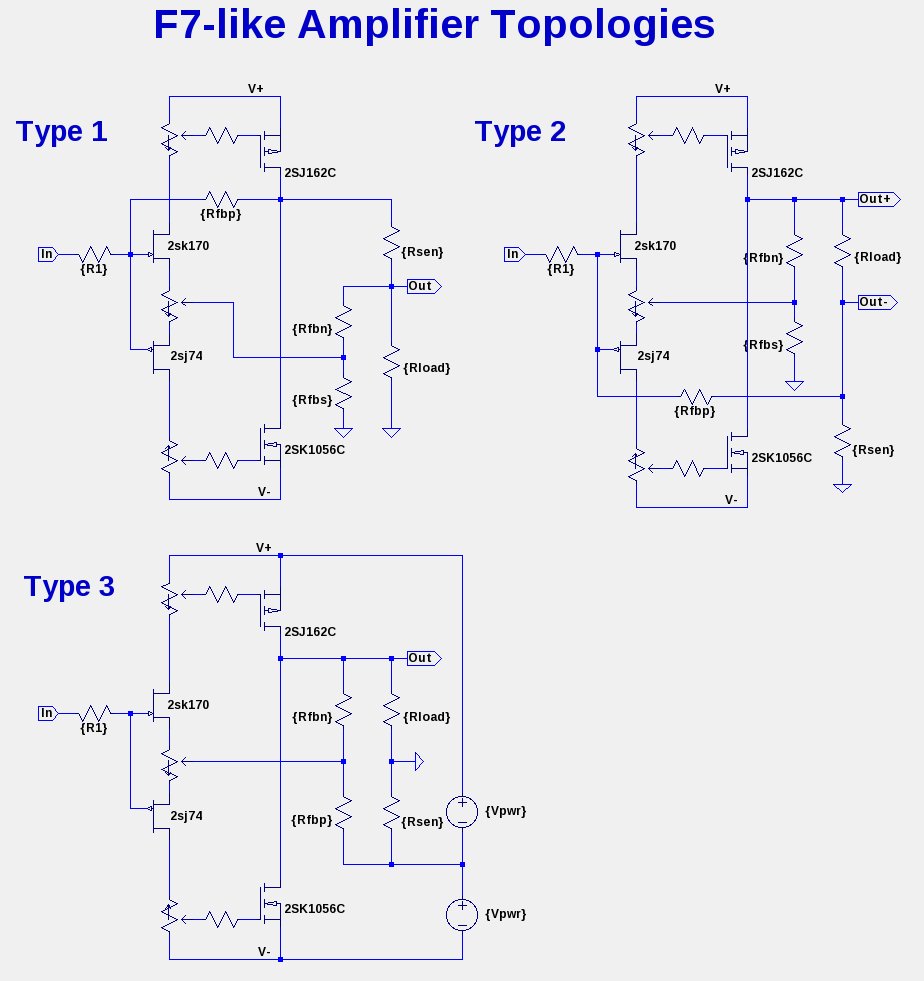

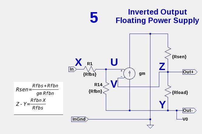

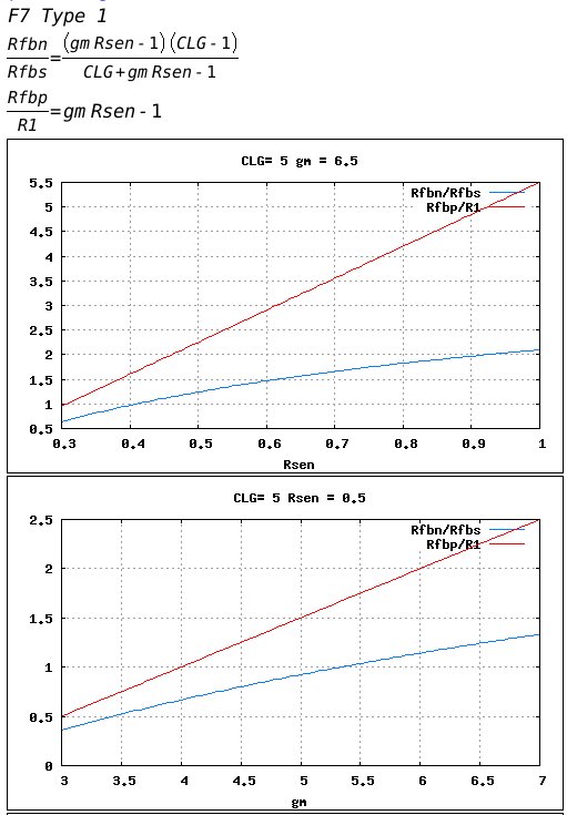

I have done more analysis and simulation of the feedback topologies for amplifiers of the F7 variants, such as shown below. Here is a summary of my findings:
Type 1: Simulates fairly well, but might be too sensitive to resistor values.
Pro: Negative speaker terminal is grounded
Con: Sense resistor must be .5-1.0 Ohms
Kfbn negative feedback resistor must be relatively small
Type 2: Simulates well.
Pro: Good resistor values and performance with small Rsen values
Con: Negative speaker terminal is active
Type 3: Simulates well.
Pro: Simple parameter relationships
Low value sense resistor
Con: Floating power supplies - probably disqualifies this choice
The equations and plots below are for the resistor values with an infinite damping factor. The Type 3 topology is unique in that the Sense resistor Rsen is determined from gm and CLG alone.

Nice work lhquam - my vote goes to typpe 2 😀

Thanks lhquam for this concise summary of your valuable knowledge which you generously granted DIYers.
