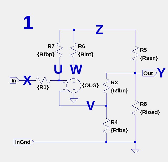

The schematic shows an idealized version of the amplifier of post #136 that combines both negative and positive feedback. I generated and solved an idealized set of equations for the underlying circuit that assume a perfect differential amplifier with a gain of OLG and output impedance of Rint, and that the positive and negative feedbacks present negligible loads to the output.
I found a solution for Rfbp (R7) that created an infinite damping factor for the overall amplifier. That is, the output voltage is not affected by the speaker load resistance Rload. The solutions for the positive feedback resistor and the output voltage are interesting in that they only depend on the open-loop gain OLG, CLG, and the ratio Rint/Rsen. CLG is the approximate closed-loop gain given by negative feedback network:
CLG = 1 + Rfbn/Rfbs

Thank you lhquam for this excellent and admirable work. Suppose R7 [for +ve feedback] is removed. Then Rint + R5 [sense] may be summed as they are in series to equal a new internal impedance for the amp. The resultant amp is a diyF5 which is the accepted parent or precursor of diyF7. How do the objective data for this diyF5 compare with its resulting diyF7? How many dBs of positive feedback are you allowed before this diyF7 oscillates?
I found an error in circuit model. The differential amp I used was a voltage amplifier Vout(V+,V-) , but it needs to be a transconductance amplifier Iout(V+,V-), corresponding to the behavior of the output MOSFETs. Stay tuned.

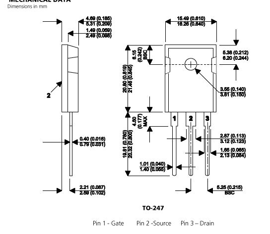

In the F7 4 MOSFETs share 160W, so each has to carry a load of 40W, which is times more than in other amps. Is it that we don't see additional MOSFETs on the underside of the pcb? Or are the ALFETs just tougher?

the drain and source of the Alf08N/P16 are changed, look here.....
one fuse killed....
Hu, hu two Alfs also dead....
I burried them at the same place as the fuse.......😡😡
But two pairs are still stored in the basement, so the show goes on.....this afternoon.
Mind the right pin order!
Thanks for the heads up on the ALFET pin order issue. I wonder why they did that.
All lateral mosfets have that arrangement (dumb bastards). hahahaha

The 6Moons photos leave you scratching you head about the position of the V+ and V- connections relative to the ALFET pins. It sure looks like rail connections to the 3rd pin with is now known to be the drain pin. Of course we do not know what is on the backside of the PCBs.
