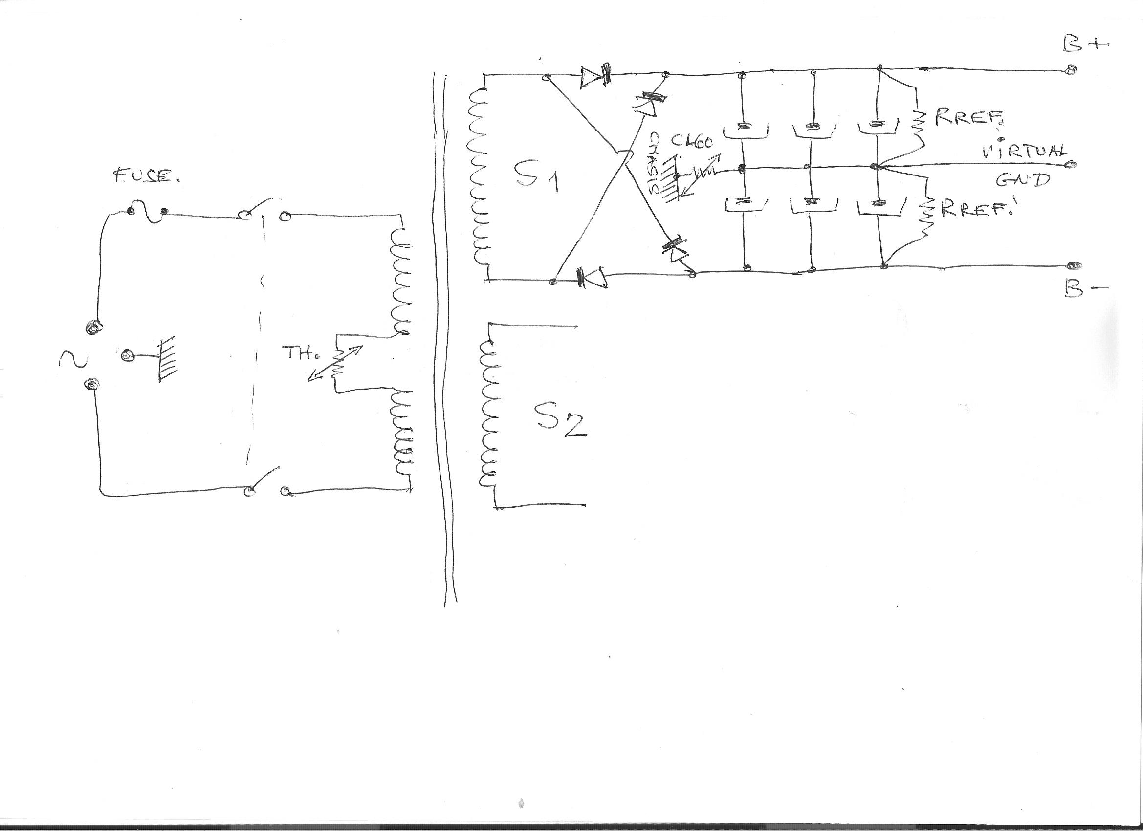

BTW , my kitchen 24/7 Revox-A78 a/B class amp PSU is done in that way .
Thanks for the idea of the power supply. I would like to use it to power another Push-Pull amplifier (M2 Firstwatt clone) from 40V AC single coil transformer. Is it safe? What are the advantages and disadvantages of this solution?

Hi, what I went after by starting to write about the power supply and especially the grounding was Papa's "found a clever way to further reduce the effect of high frequency DAC noise and environmental RF".
It is of course of much greater interest also for me to learn more about the actual amplification part.
Still, immunity to the more and more RF polluted world should be of great interest. (I do not want to open this can of worms, but I must mention that I happen to believe much of the "audible differences" between cables of all sorts can be addressed to RF. But you do not need to arrest me here in this thread because it is off-topic from what really matters here. The F7 topology itself.)
