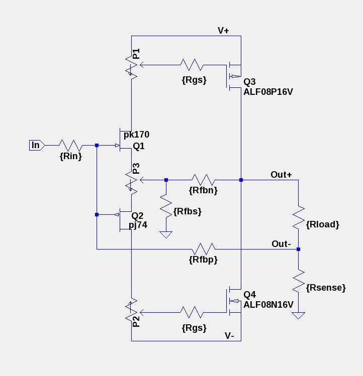

I have updated my schematic of post #218 using information gained from the 6Moons photos and everything simulates fairly well.
I estimate the open-loop gain of the jfet and output fet stages into an 8 Ohm load to be 42dB with all feedback removed. This was measured as the V(Out+,Out-)/V(gates,fbnode), where gates is the jget gate node, and fbnode is the wiper of potentiometer P3. With a closed-loop gain of 14dB that means that there is 28dB of negative feedback, which is a huge feedback factor. Perhaps I am incorrectly estimating the open-loop gain, but that gain factor is fairly consistent with the F5.

What is the function of P1 & P2 pots ? , it serve for biasing of output LatFet`s pair ? , or ...?
Output FET bias adjustment, similar to the same pots in the F5, but without the additional resistor, thermistor, and current limiter circuit.Ihquam

I guess than P3 serve for output AC balance adjustment ?
and additional question , if let`s say we supply that F7(#317) with +/- 24VDC ,and with OPS - Iq = 1A , what is the approximate values for P1 & P2 than ?
Edit , I think that now you are very close to original F7

That will depend on the Idss of the jfets, the jfet idle current with degeneration, and the output fet Vgs at 1A. It is a pretty easy calculation:
Rdrain_load = Vgs_1A/Ijfet
