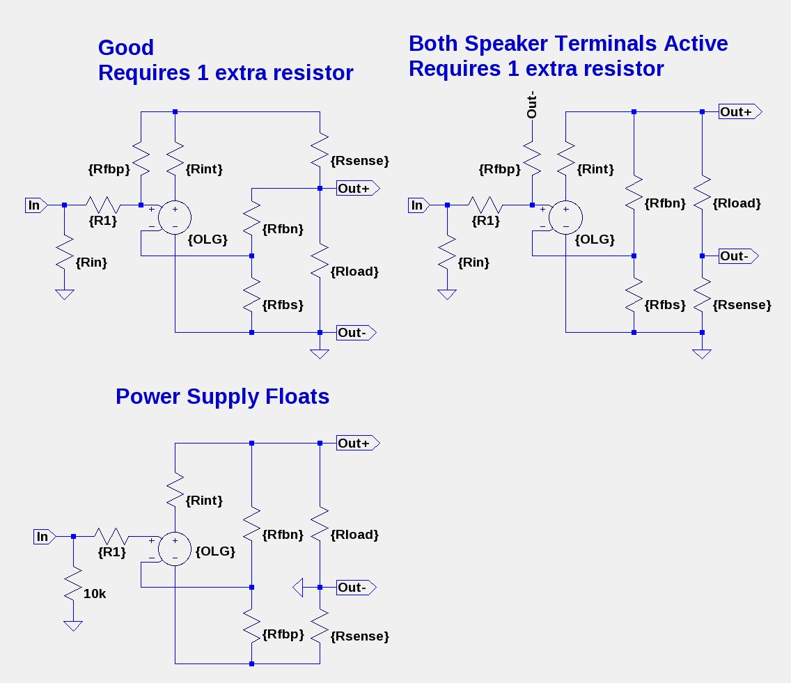

The circuit in post #136 cannot work. Both feedback +/- signals are essentially the same and thus the result in partial cancellation with no change to the damping factor. The Rsense resistor introduced in the later circuits is necessary in order to improve the damping factor.
Hint: If you carefully think about the 20W into 8 Ohms specification (rather than 25W for the F5) and the "smooth clipping at 40W/4Ohms" plot in F7.pdf you will realize there is something going on in the output stage to lower the maximum output. Perhaps the Rsense resistor.
Here is a summary of the circuit topologies that I have found to meet the F7.pdf specifications when given the proper components.
The 3 circuits show explicit pathways for positive and negative feedback. Please confirm that the net contribution to output power from both pathways decreases the net power output [20 W/8 Ohm] versus 25 W/8 Ohm for diyF5; as a signature per your hint in an earlier post.
All three topologies appear to be capable of meeting F7.pdf specifications, including the distortion, output power, soft clipping waveforms, closed-loop gain, damping factor, and -3dB rolloff frequency. Of course, each circuit required as different set of resistor values.

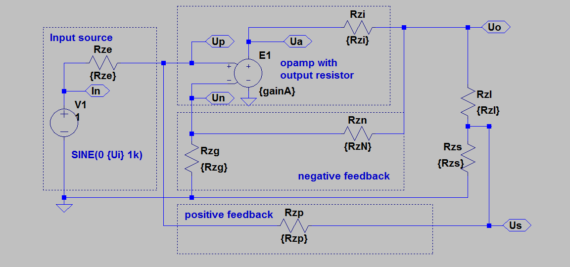

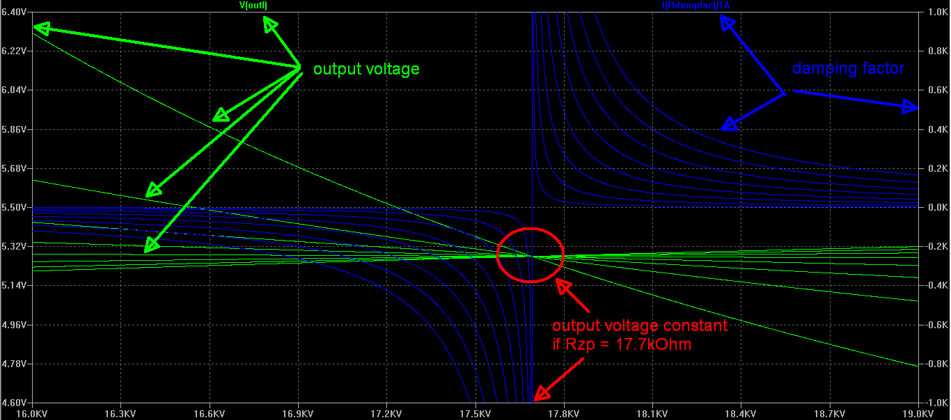

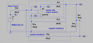

Here is an easy way to simulate the correct value of the positive feedback resistor Rzp. Schematic in post #218 was transfered into a generalized form, given in Mitkopplung20151230g0.png, which is largely expanded in the asc file, see below.
In Mitkopplung20151230g.png a simulation result is shown.
While most of the values of the resistors are given by practical reasons, especially the influence of Rzp and the load RzL are critical on the damping factor and the output voltage. Thus and to keep simulation effort low, different combinations of the 2 resistors shall be simulated in one go. But in LTSpice simulation command DC sweep only active sources can be specified and not resistors. To solve that problem the load resistor and the positive feedback resistor Rzp are replaced in the simulation each by a controllable current source. (Idea: At a given voltage a resistor determins the current according to Ohms law. So a resitor can be replaced by a current source which current is determined by the voltage dived by the resistance, which value is specified by an active source.)
Please notice that as a result the value of Rzp is given on the horizontal axis as kilovolts but is of course in kOhm.
The zip file contains the asc file with explanation and 2 plot files.

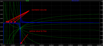

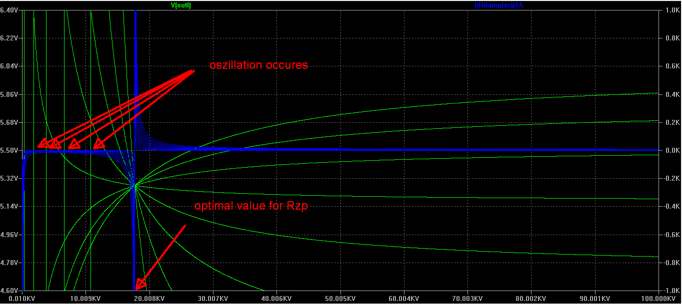

To zoom out the simulation result, the command
.dc VTunableResistor1 16000 19000 1 VTunableResistor2 1 8 1
needs to be changed for example into
.dc VTunableResistor1 10 100k 10 VTunableResistor2 1 8 1
Mitkopplung20151230g1.png shows the result.
