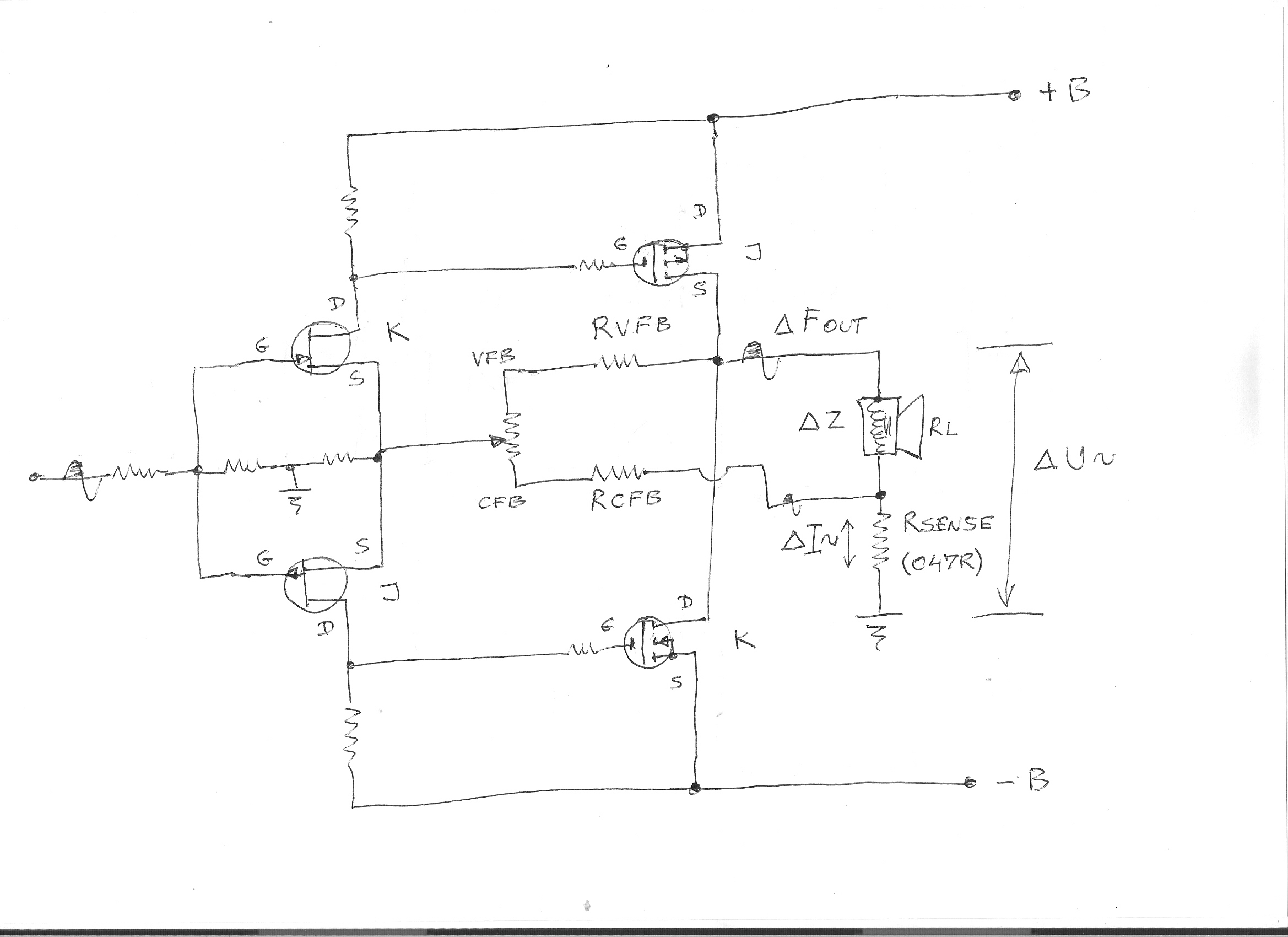

It is nothing very common with F7 except of insertion of PFB ,
it is basic and approximate principle derived from some very old tube amps types which have extra manual control and extra option for amp operator to gradually adjust and found so called `LS critical DF `point .

Thanks for showing that circuit. I was not aware of that trick, and I am still not sure that I understand how it could work. I see that it mixes voltage feedback with current feedback (voltage across the Rsense resistor), but both are negative feedback in that circuit.

Hello banat. Thank you for your reply. If I remove the resistors of the current feedback path in your schematic, the resultant circuit defaults to diyF5. I do not see positive feedback. Please note that the D and S labels on the upper Mosfet are inadvertently reversed.

By default that CFB loop should be negative feedback to , but in real interaction of delta Z of LS in function of delta F-out that loop it is PFB sometime ;) ,
BTW , yes D and S labels on top output power MosFet are reversed but not intentionally .

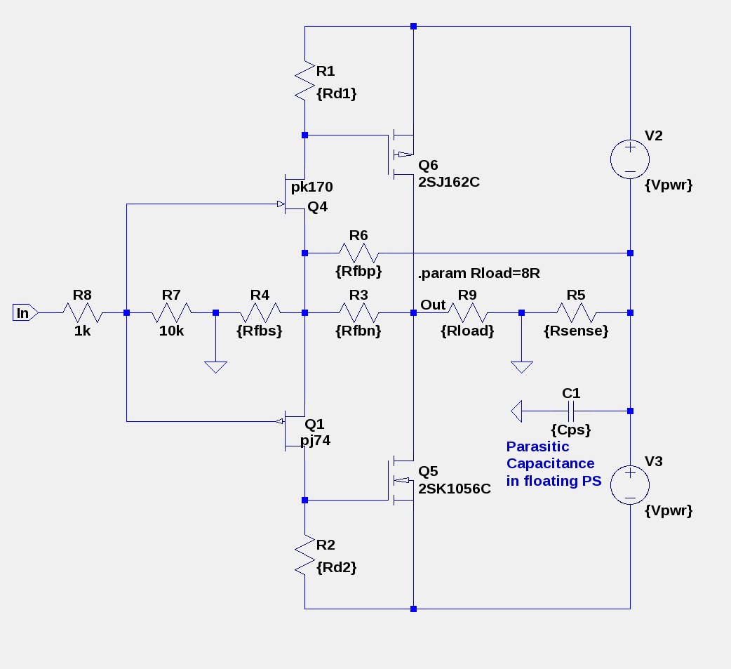

The circuit you show appears to be similar to that in fig. 3 of https://5ad7b68329ae8ddd591c555bf9d.../Loudspeakers_and_negative_impedances-HIk.pdf.
I ran simulations based on that circuit, and found that it would increase damping factor only by floating the power supplies as shown in this schematic. The overall performance based on this circuit looks excellent but it requires one resistor more than the circuit in post #218.
