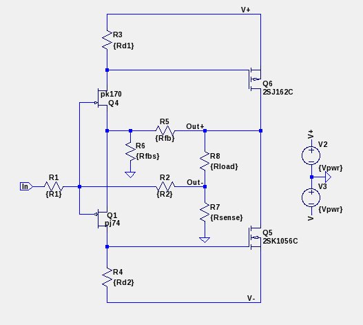

I just discovered that my circuit in post #143 when tuned to obtain the F7.pdf specifications has a problem: The input impedance is -10K Ohms.
Oops!
I have another circuit that appears to work that has an input impedance of +10K Ohms and otherwise behaves properly, but suffers from a different issue: neither terminal of the speaker load is connected to ground. I guess that isn't really a problem since balanced (bridged) amplifiers have the same issue.
I will show that circuit after I am convinced it doesn't have other issues.

Here is another try at the schematic which now has a +10k Ohm input impedance and otherwise good specifications when populated with the right resistors and fets.
The only issue is possible sensitivity to noise on the speaker outputs. Perhaps this is the issue Nelson addressed with this comment in F7.pdf:
Also, I put more capacitance in the power supply and found a clever way to further reduce the effect of high frequency DAC noise and environmental RF.

Hello lhquam.
Does/should your diyF7 circuit invert phase at its power output?
The 10K input impedance suggests that the gates' joint node of the front end JFets is a virtual ground [VG]. VG was derived when two independent signals [one from input and the other from power output] merge such that they are out of phase and mostly equal in amplitude. It follows that R2 in your schematic is equal to 47K to give~ X5 gain like the spec. of F7 given by Mr. Pass.

It's non-inverting, so the R2 would be the positive feedback resistor. For a gain of five, R5 = 100, and R6 = 25, for example.
