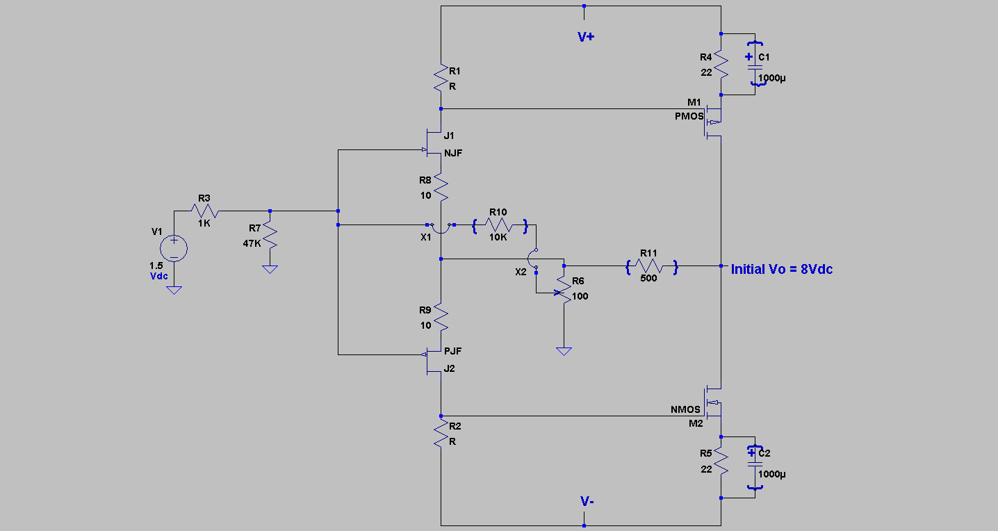

Experimenting with +ve feedback in diyF5
The front end of diyBA-3 [BA-3 FE] power amp may be used to understand the effect of positive feedback on the performance of a diyF5. Here's an explanation.
1. The left view is a simplified schematic of BA-3 FE.
2. The pot in the parent interconnecting the JFET sources was removed.
3. This is a low power circuit which may then be used to assemble the circuits advocated by lhquam and pr.
4. The emphasis is to initially practice a low instead of a high power amp, and get a feel for the systems' reaction.
The BA-3 FE simplified schematic is then modified by adding the circuit elements which are enclosed in parentheses as follows:
1. R11 = 500 Ohms to make it a mini diyF5 having a closed loop voltage gain =6.
2. Each of the 22 Ohm source resistors of the power Mosfets; is shunted with a 1,000uF electrolytic capacitor. The DC stability of the Mosfets is preserved, and the AC gain of the Mosfets is increased to look/be like that in the concept schematic of diyF7.
3. The fixed resistor R6 = 100 Ohm in the parent is replaced with a variable 100 Ohm.
4. The wiper of R6 is the point used to inject positive feedback via the added resistor R10 = 10 K to the joined gates of the JFETs. The article by Mr. Pass on F7 suggests that diyF5 is agreeable to accept some level of positive feedback.
Testing is done as follows:
1. Vi = 1.5 Vdc AA battery, and the wiper of R6 is at ground. The load is the negative feedback resistors = 600 Ohms. Use initially a PSU of +/- 15 VDC to protect them.
2. Establish steady state, and measure/catalog the quiescent DC voltage at all nodes.
3. Inject positive feedback by advancing the wiper of R6; say 1/8 turn. Establish a new steady state, and measure/catalog the new quiescent voltage at all nodes.
4. It is possible to change the value of R10 [10 K] to manipulate the sensitivity and range of R6.
5. The expectation is that the mini amp will eventually misbehave; like the output will latch at one of the[+/-15 Vdc] power rails, and/or oscillate. Quickly back off the wiper of R6.
6. Reverse Vi, and collect a similar set of measurements to get a feel for symmetry.
6. These objective measurements are then used to calculate DC gain and make other useful connections; like the maximum tolerable +ve feedback.
Eventually one may use the resultant stable mini amp [I am not calling it a diyF7] as a front end to a perfect buffer [or other] and listen to its subjective performance at different points within the useful range of positive feedback.
