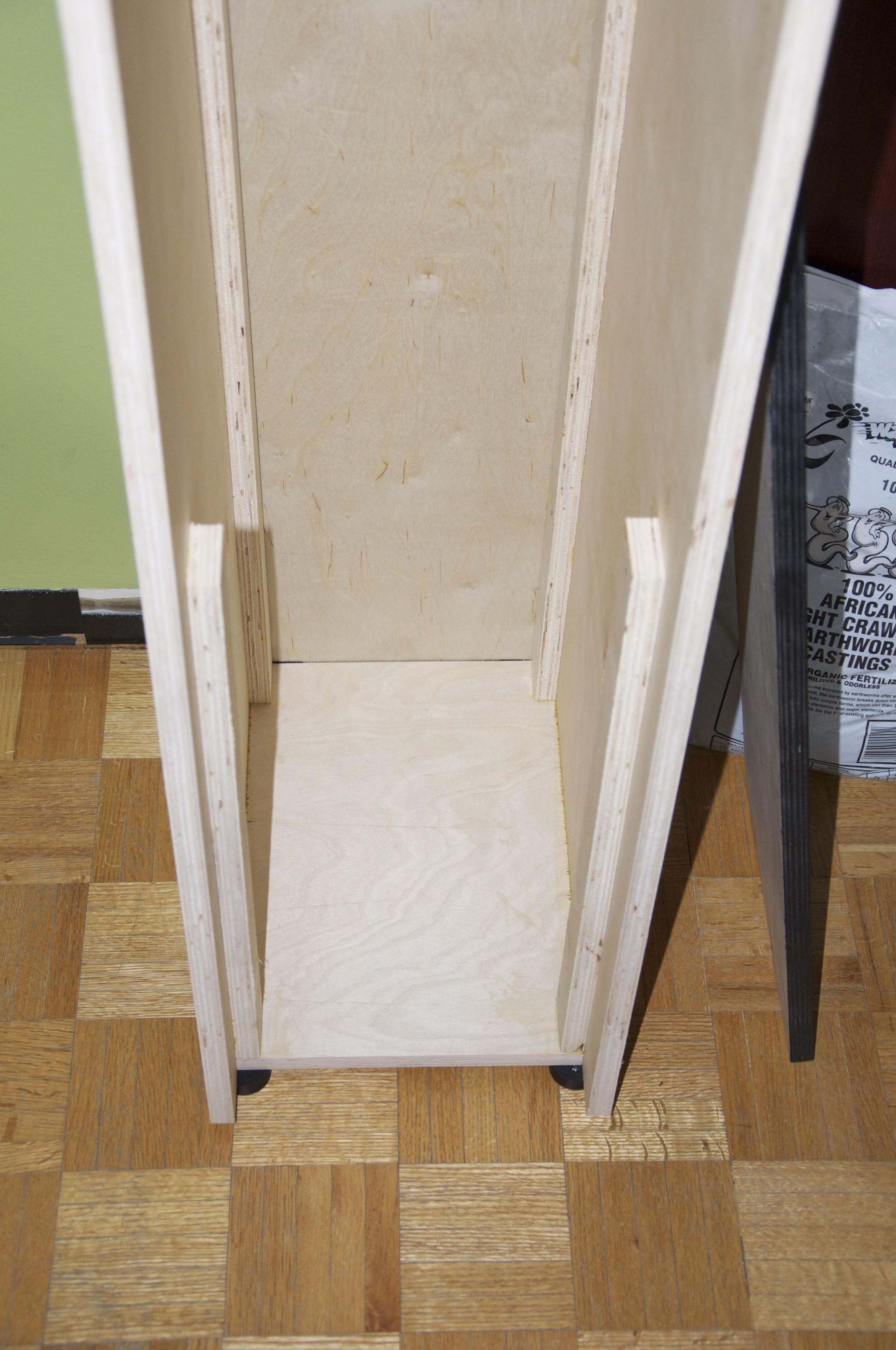

Hi Zman, here is what I've done:
1) The front panels are removable.
2) I used a combination of glue and nails for most connections. Places where I wanted removable I used screws. (Like the front.)
3) I used single layer 19mm (3/4") for everything except the front where I doubled up. (The black part is doubled.)
Hope this helps! good luck.

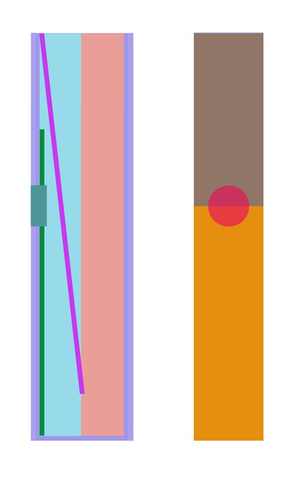

Platplaas,
I am attaching a diagram of my planned BIB. These are 2D images and one is a side view, the other a front on view. I have tried to draw to scale.
My questions are on the building technique:
1. Please note that I have drawn 2 layers for cabinet front panel and back. How to fix the 2 layers to make one double thickness layer? You used nails and gue or after making the cabinet screwed these on?
2. Your front panel is removable - it has screws. Have you put some cleats at the front of the cabinet for this? I have drawn the cleats in green - looks ok or I need to change? If you have used any other method, would appreciate you sharing.
-Zia
-Zia
Zia,
gluing two layers together can drive you to drink or drugs. They get very slippery and as soon as you apply pressure they drift away.
Not a problem though.
Use very thin nails (one mm or less), hammer two of them into one board.
Then nip them off and just leave 1mm standing out. They will keep things fixed when you apply the pressure.
And use strips of 5cm x 5cm hardwood. One clamp on each end of the strip and you have pressure on the whole length instead of only on two points.
Pit

Fastening Methods
Hi Zia,
1) I first screwed one front panel to the cabinet, then I screwed the second panel into the first panel.
2) I used narrow strips of wood inside the cabinet. The strips are glued and nailed to the side panels. The strips help align the front / back panels and give you something to screw into. The attached picture will maybe make this more clear!
Hi Zia,
Platplas, thanks for the pic - I was intending to the same - only my strip of wood (green line) was much longer. Guess I can use shorter strips on the inside like you have done here.
Pit, thanks for the advise on gluing 🙂 After gluing, probably I will put screws near 4 corners also to keep it tight.

I used full-length long pieces where I could, but where I ran out of wood I used the shorter pieces instead 🙂

Talked to my cab-maker today. Our plan is to:
1. Cut the pieces of the marine ply according to plan
2. Drill holes for screws in required places (these guys don't use clamps - screws will have to the tightening!)
3. Glue the pices together to make the cab
4. Insert screws and tighten up - leave 'em to dry
5. Fix second layer of ply boards for front on back with help of glue and screw (using "soft" ply boards for this and front one will be a veneered one=less work in finishing)
6. Color, varnish to make them look nice... not sure if I'm going to veneer the sides though - might go for a darker stain for those

The side panels are fastened to the bottom panel and the internal baffle. These are all glued and nailed. Holds together OK - but definitely stronger once the front and back are screwed on!
And yes to your interpretation of a compressible rubber gasket 🙂
