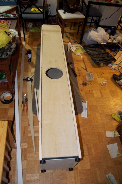

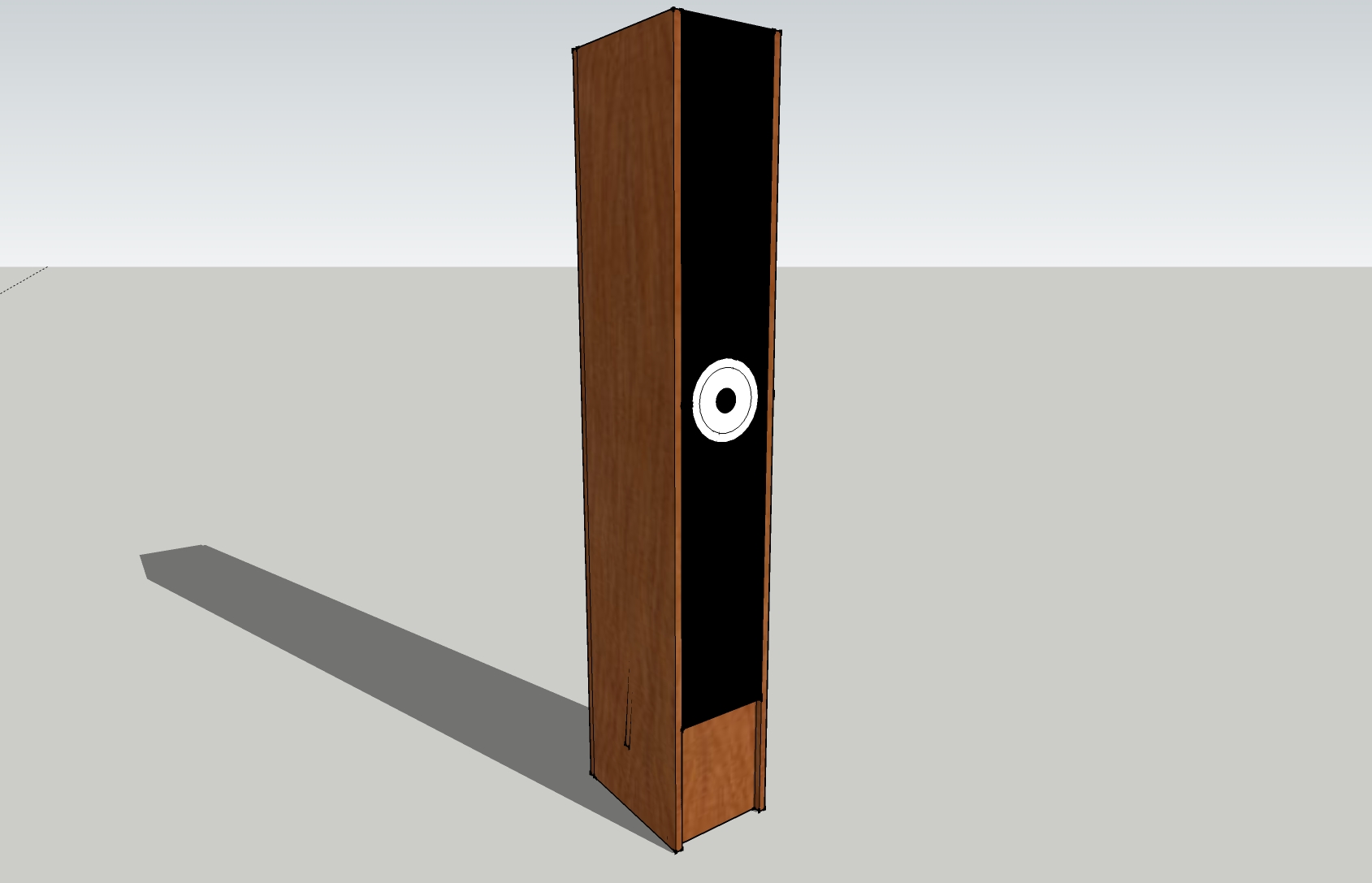

Here is a picture showing what I'm going for...I plan to install black phase plugs later on.
I am doubling up the plywood on the front face (the black part) - with the scrap plywood - should I also double up the back faces? Don't think I would have enough to double other faces.
Regarding bracing - I'm thinking of running 2" strips of vertical plywood inside the corners to lend some rigidity to the structure. Would this compromise the sound in any way?

Doubling the front of your boxes always is a good idea. At the back, where nobody looks, you can do something even more efficient. Cut your wood into ~2" wide strips and glue them on not flat but edge on. Not symmetrically but at odd angles and distances.

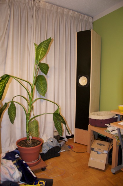

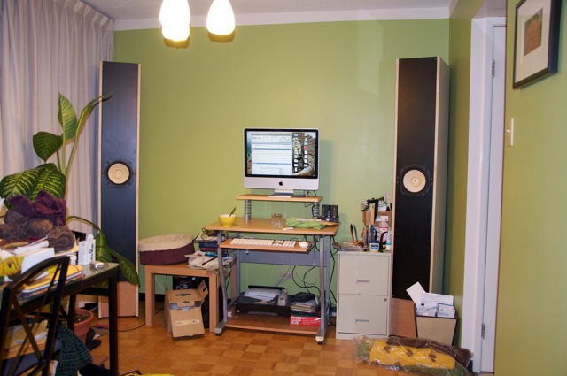

Here are the pictures...
Apartments a mess...now its cleanup time!
Cabinets have not yet been stained and varnished, but you'll get the idea 🙂
looks good, bass should be more than adequate since BIB, wonder about the higher freq response on this 8"...
gychang
I got my wife to listen to a frequency sweep on Youtube. Response starts around 30hz and could be heard up to 19khz.

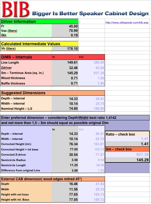

Cut sheet
I am attaching the cut sheet for those that are interested. Note that some of the dimensions (side panels) are larger than the dimensions on the calculator. This is to accommodate for the space lost when mounting the front and rear panels within the width of the side panels, similarly for the bottom panel.
Note that this design doubles up the front panel with two smaller half pieces.

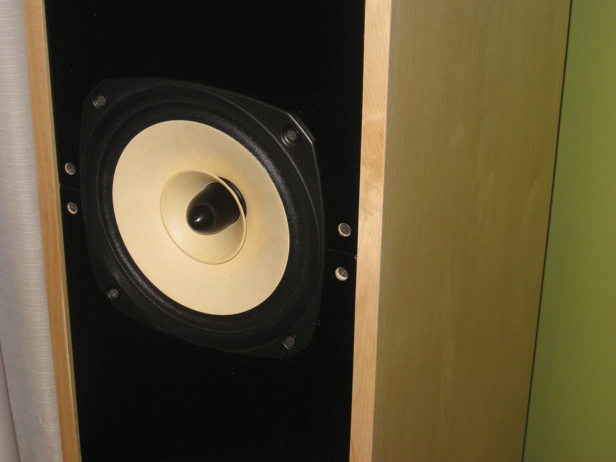

I've added phase plugs to mine - new picture!
Good luck!
