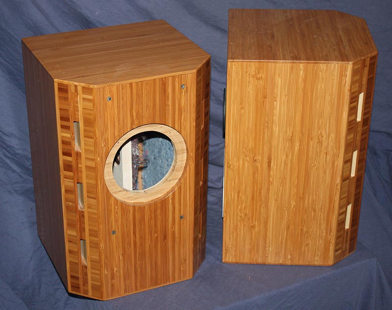

Stranded bamboo ply is a fantastic material for speakers.
dave
just a pita to work with, particularly when grain matching the more highly figured Plyboo Neopolitan pattern (photo, Dave?)
(cabinets shown are for Bud Purvine's Alpair 7s the more "common" Caramelized finish)
