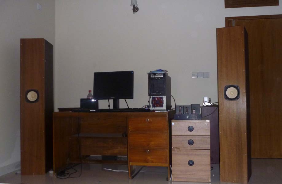

No Dave, I think I've got close to 50... I can expect bass to improve? In fact I think my evening listening session is giving me better bass than what was there early morning... or maybe I getting slightly madder than what I was to begin with 😀
One is around 8" from side wall and 30" from rear wall. The other 30" from rear wall and 36" from side wall. Pic attached.

Got it - I will place them as close to the wall as possible after I finish posting. But please note - I can give one of the speakers a corner, as there's a door on the other side.
Excuse my ignorance - I have heard the term "ripple" before - what does it exactly mean?
Got the speakers 6.5" from back walls. The one placed in the corner is also ~6.5" from the side wall.
Big improvment in bass and overall balance. Plenty of low end rumble. Speakers sound "big" now - they've added weight to the open sound stage. The mid range shout is much less pronounced now.

ripple is a description of the graphic representation of multiple periodic resonances in measured or calculated frequency response
depending on the actual frequencies involved, the subjective perceptions may not be as tragic as squiggly lines on paper or pixels might suggest
isn't it rather interesting how delicate the balance of placement and performance can be for designs that use rather than try to ignore room boundaries
