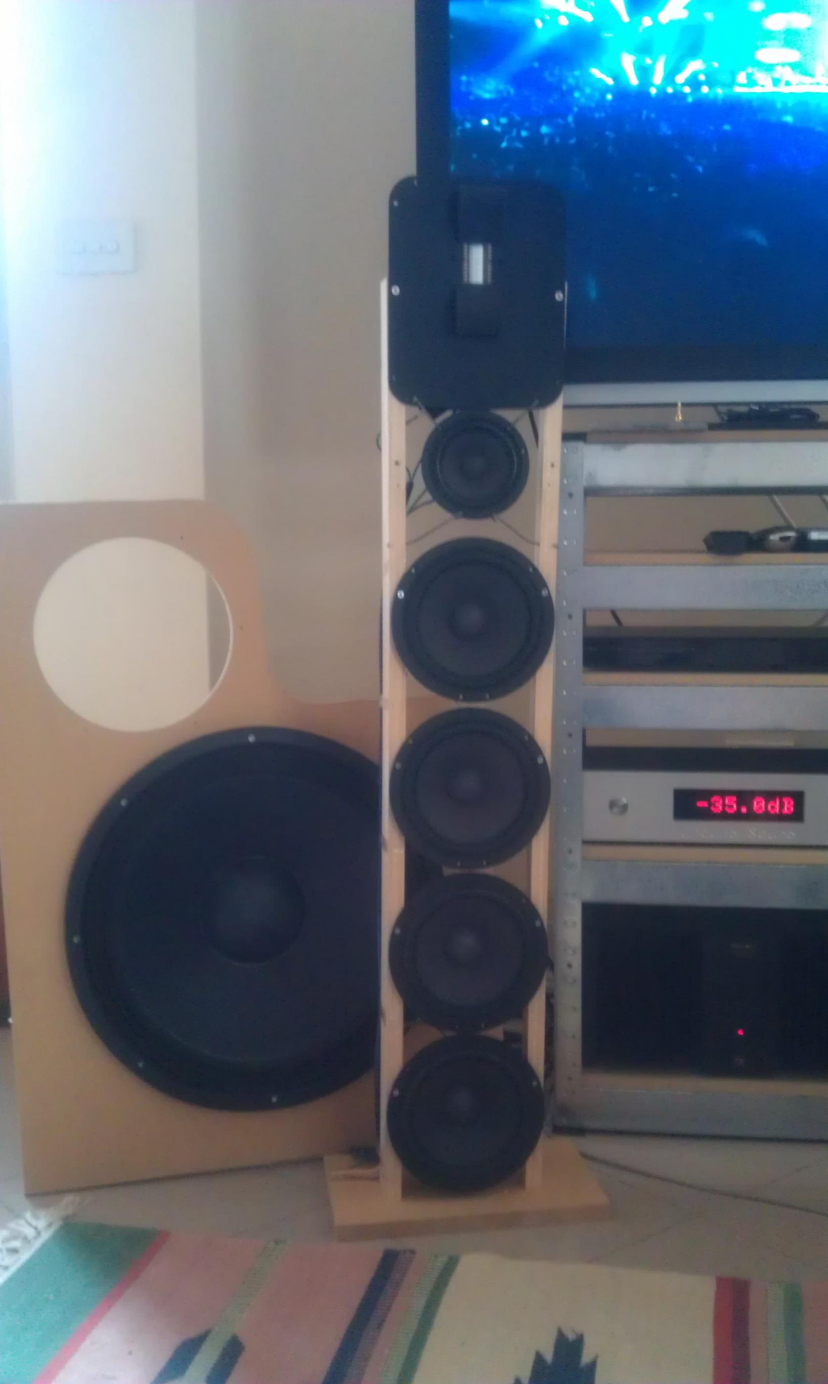

Four of the 18WUs turned up a few days ago and I got my first listen to the new arrangement.
Glad to report they did exactly what I was hoping for and that was to give the vocals a little more of a bass characteristic.
Rather than just running drivers and amps for the sake of it, I did some A / B testing through the active x-over software. With two copies of the software open I configured one x-over as a three way, and the other as a four way. I left the woofer and tweeter to crossover in the same spot in both configurations.
In the three way I set it up to cover the same band as the mid and mid woofer in the four way. After quite a bit of switching back and forth I came to the conclusion that despite crossing over in the middle of the vocals I prefer the sound of the four way, the 12MU has a very nice sound to it if not overly used, which I guess is very typical of a mid driver.
Due to order timing and Christmas I won’t have the other six 18WUs until next year, but for the time being here is a picture of the prototype speaker. The tweeter isn’t optimally placed, but to reuse the same frame I had to remove one of the 12MUs and turn the tweeter upside down.

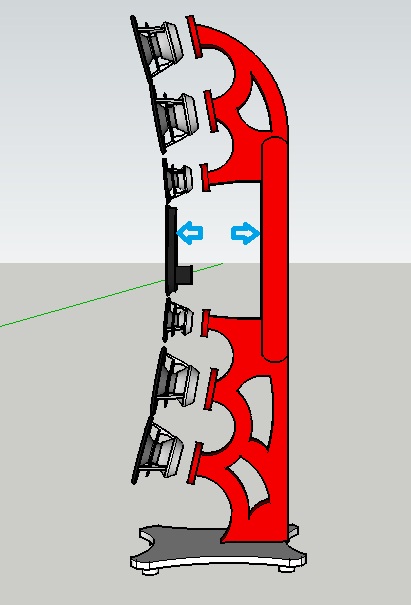

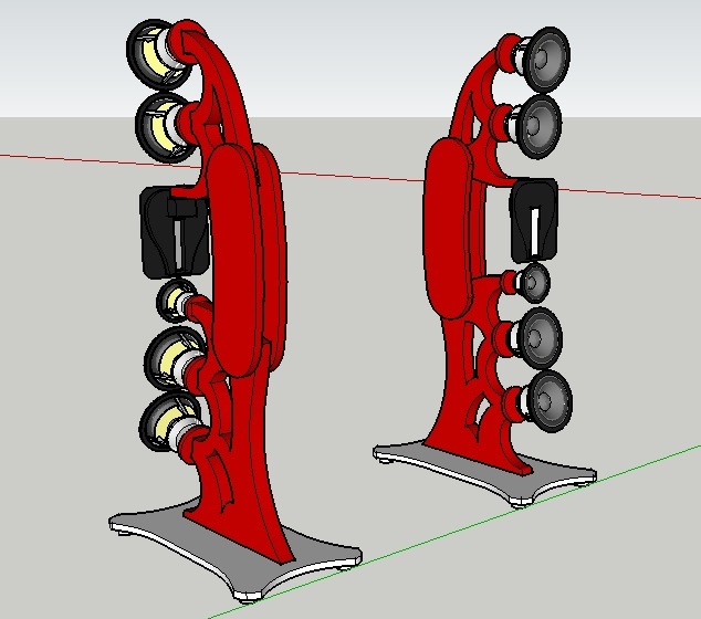

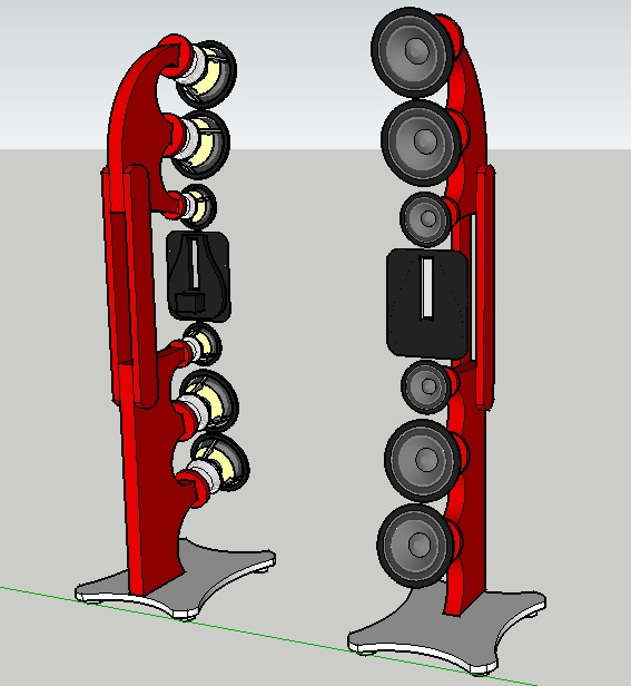

Now that I have settled on the tweeters, mids and mid woofers time has come to work out how I am going to put this jigsaw puzzle together.
I have put together what I think is a design that might work. The tricky bit is mounting the tweeter so it has a clean exit both back and front.
I would welcome comments on what I have put together so far.

Just paid $2000 for a pair of those tweeters, so replacing them is not an option. I could replace the two 8 ohm 12MUs (in series) with a single 4 ohm 12MU (I have both).
The area I am most concerned about is the area behind the tweeter, do you think it will allow the sound to travel unobstructed?
Sorry 🙁
The distance behind the tweeter must be longer than the largest dimension of the tweeter.
Here the diagonal is the largest dimension. I think it is the primary condition if you want to minimise the area behind effect/obstruction.
Keep your MTM 😉
