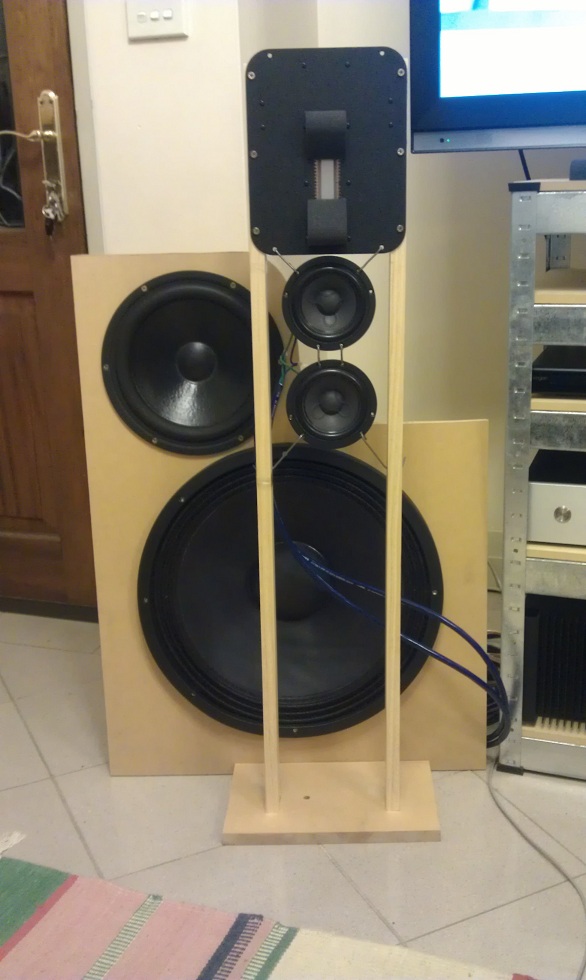

Just finished my latest incarnation of the test baffle...
Immediately it sound much more open and natural even without touching the crossover from its previous setting.
Will fire up the cross software in a minute to see what changes it makes but for now here a pic of the new stand.
Holy Dooley...its a good thing these speakers don't put out because my partner would be in trouble ;-) think I'm in love!
Made a few crude adjustments to the crossover and sat back and listened to some Pink Floyd. Listen to High Hopes with my eyes closed I nearly fell asleep I was so lost in the music.
I'm nearly scared to build the second speaker in case I ruin perfection. Ok so its not perfect yet, but it well on its way. I think it would be a close call between these and some $55k Gryphon Atlantis speakers I listen to a while back they sound that good.

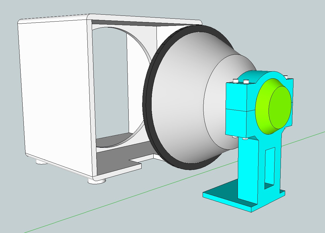

So I really dont want to add anything that wont help the end result. I do plan to vere slightly off the beaten path with the H frame, in as much as I plan not to mount the driver to the cabinet.
I was reading on the Linkwitz website about driver mounting Issues in speaker design - 2 and it gave me an idea, if I isolate the driver from the cabinet, I can then mount the tweeter and mids to the H frame without it receiving vibrations from the woofer.
Allowing me to kill two birds with one stone... improve the sound of the woofer and make mounting of the tweeter - mids easier.

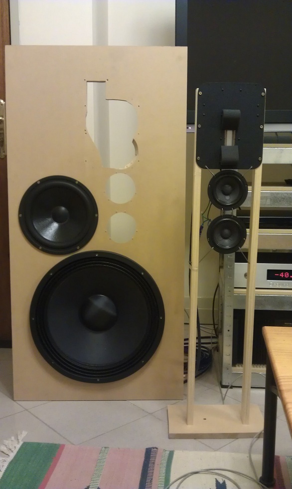

Sitting here listening to some music I cant help but feel that the two 8ohm 4.5" 12MUs are a bit small in cone size to produce a really balanced mid vocals.
Dont get me wrong the sound sweet as, but listening to the voices I cant help but wonder if they are slightly too high pitched to give a warm mid sound, tending to think they sound a bit too clinical.
I am also thinking about the 10" drivers I want to replace, and I keep comming back to running some 6.5" Illuminator mid woofers.
Basically that would be a similar setup to my Cremonas (1 x tweeter, 1 x 4-5" mid, 2 x 6.5" mid woofers), except I would be using an 18" woofer below the mid woofers and would want to run 4 x 4ohm 6.5" drivers (series - parrallel) to come back to 4ohm.
Just doing the Sd numbers:
1 x dipole tweeter = 22cm2
1 x 12MU = 58cm2
2 x 12MUs = 116cm2 (58cm2 each)
1 x 10" = 320cm2
4 x 6.5" = 616cm2 (154cm2 each)
2 x 10" = 640cm2 (320cms each)
1 x 18" = 1194cm2
Looking at the ScanSpeak 18WU-4741 data sheet I could cross over to the mid woofers anywhere from 2500Hz down. Giving more warmth the the mid vocals and tight punchy bass.

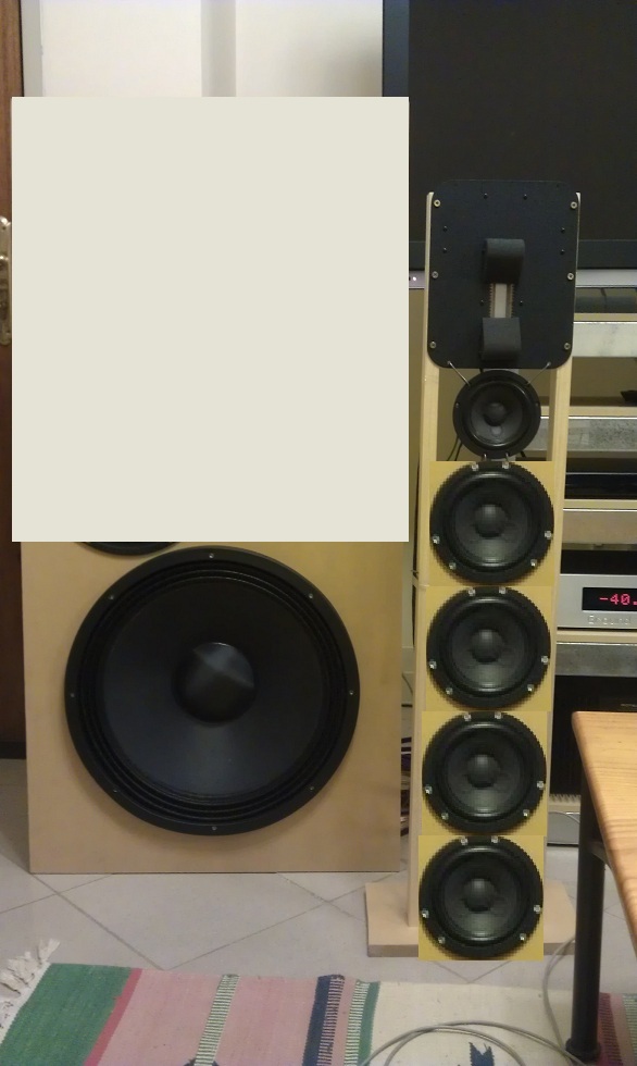

Agree for a driver of their size they do a pretty decent job, the only thing they lack is cone size... If you play the same frequency through a large cone and a smaller cone, they both may play the same tone at the same SPL but the tonal characteristics of the drivers sound completely different.
I think that is in part what I like about the TC Sounds 18" it delivers a good amount of tight bass, but it sound like it does it effortlessly.
Probably similar to having a huge cubic inch big block making a lazy 500HP and having a highly tuned turbo 4 cylinder making the same 500HP. Both produce the same final number but there is a world of difference in the way they do it, and the way they sound.
Same goes for the mids... I plan to cross over to 4 x 18WUs and let them carry some of the vocal duties to make it less squeaky and a bit warmer / fuller sounding in the vocals.
