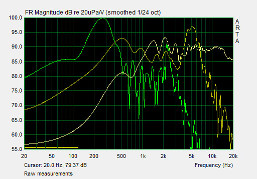

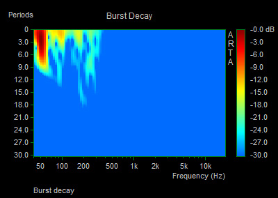

Rudolf : Stored energy... I made this project :
http://www.diyaudio.com/forums/multi-way/123512-ultimate-ob-gallery-68.html#post2643791
And I heard something wrong in the mid, and I notice a lot of stored energy (see attachments).
Easy for me to conceive, a mass of air cannot do mid, but good for bass.
I'm not alone to think this, See also the build discussions the S20z project of Gainphile on HT guide
Gainphile: S20-Z Compact Open Baffle using Zaph Kit
Why Linkwitz doesn't go up to 120Hz and now 90Hz with his Orion 4 ?
As I said some people can support the sound like MJK, you ? but for my ears the sound is not right. It can have exceptions but I have not heard it.

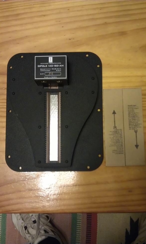

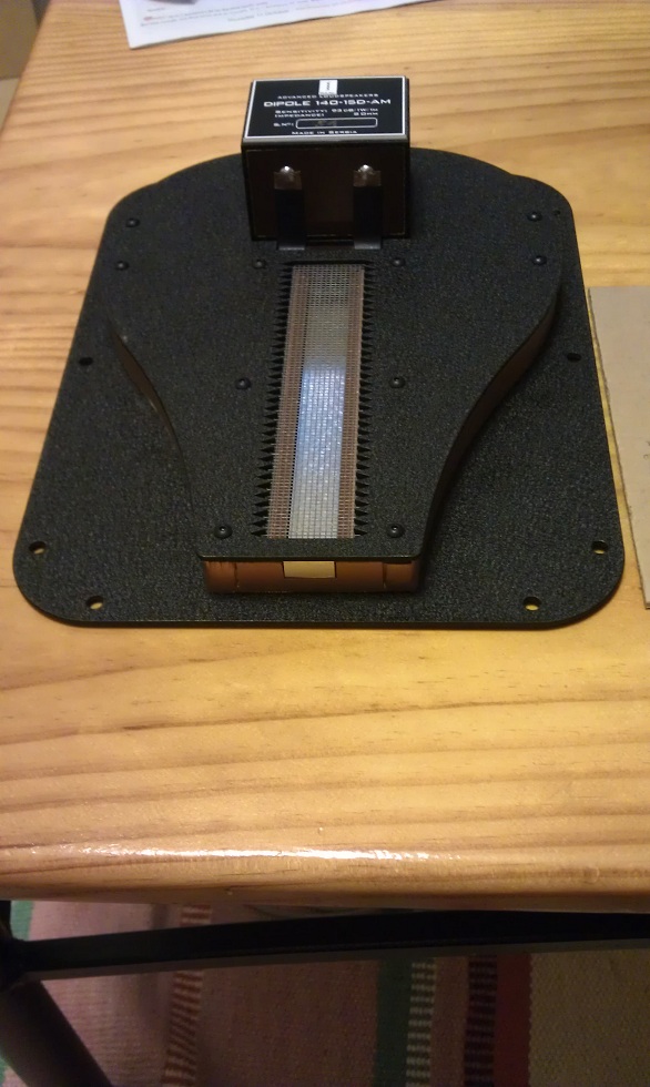

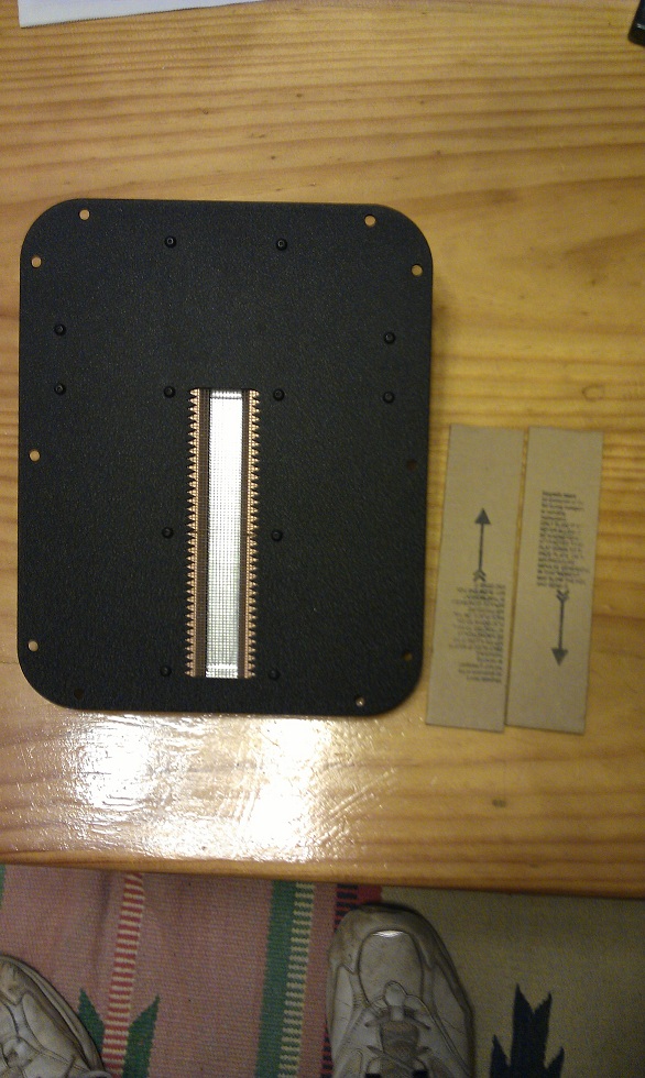

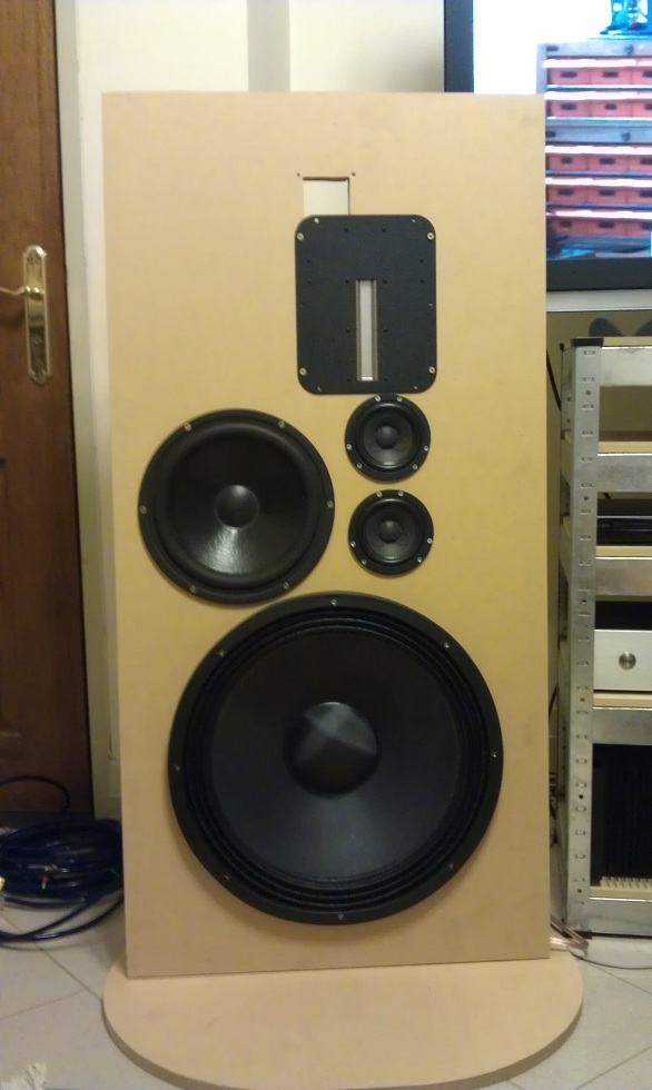

Got home and did a bit of a mod to the test baffle. I moved the top 12MU to below the 2nd 12MU (making the 2nd 12MU the top). I then put the new RAAL dipole partially into the old top hole. Which now makes the tweeter a little closer to ear height.
Here are a couple of pics of the new dipole and the moded baffle. Yet to do any real testing but very first impressions are promising.

No, its not really a resonance. The peak is caused by the front and rear radiation summing in-phase.
Have you measured the phase and group delay?
Yes I understand. But it looks a 1/4 wavelength resonance. Imagine the 1/2 x (2xU) tube as a pipe ... It looks like a transmission line ?
And Yes I made measurement and I have the SPL response, phase and group delay. But honestly I didn't need measurements to hear the problem.

Really not sure what to make of it at the moment. I seem to have inherited some contradictory traits…
The speaker seems more directional now than before, but at the same time sounds more open. I was just wondering if it now sounds more directional because I moved the top 12MU and the blending of the drivers is causing it to sound more source specific.
The other thing I noticed is that it really doesn’t seem to make any difference where I cross the tweeter / mids over.
With the monopole tweeter it made a huge difference when mounted on the baffle. Now I can cross over anywhere from 2000Hz to 4000Hz and can barely pick an audible difference.
I do have a theory about this that I need to try out… I think because the dipole tweeter is 2dB less sensitive than the monopole, I think the sound of the mids is drowning out the tweeter and is why I can’t pick it crossing over.
I don’t like the new sound all that much, but I don’t think it is the tweeter that is too blame, I think it is a result of putting the drivers too close together.
When mounted on a ¾” (19mm) MDF board the front and back faces are fairly flush. What I did find interesting is that the dipole tweeter uses the same aluminium element to radiate in both directions, same as a regular driver (I was expecting two elements for some strange reason, which makes no sense).

You can't get them too close together. Technically, the closer the better for intergration at the crossover point. This should not be the problem. Have you measured anything yet?
