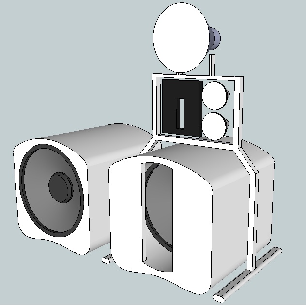

Ok what about this? lowers another 300mm bringing it down to 1 meter tall.
One thing intrigues me, what's the horn for?
The Raal already covers the whole upper range from 2-60khz....

The higher the crossover frequency between two drivers, the closer together you want their centers to be so as to avoid comb filtering.
In this case, it should be a priority to use the short side of the raal to mount it as close as possible to the driver to which it is crossed.

What about the two small drivers, are they covering the same freq range?
A better solution IMO is to get the twin drivers (perhaps use four/side in a tight square formation) to cover the 100-2500hz range and then cross them to the Raal beyond that.
You'll end up with a three-way that should perform really well.

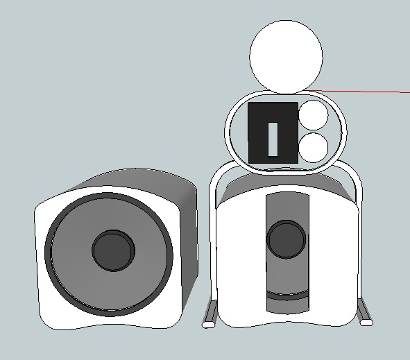

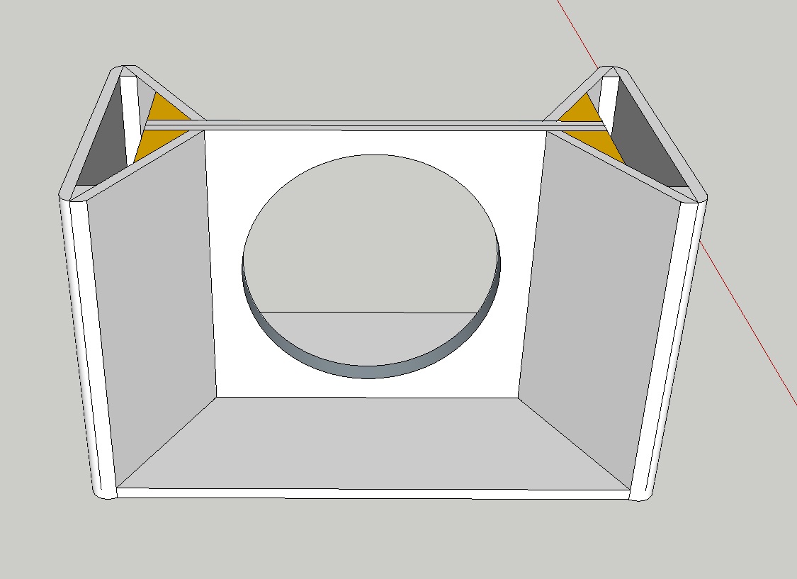

First steps first I am trying to design a baffle for the 18" that I can use now and refine down the track.
So the crazy designs stop with this one... Will see if I can make a start on it tomorrow.
(Top not shown to show internals on ends)
I hear what your saying Greg and I don't plan to purchase any more drivers until 1. I know exactly what I need, and 2. I have tested current drivers in a more calculated and methodical way.
That design looks suitable. Will the legs of the upper portion slot into the gaps on either side?

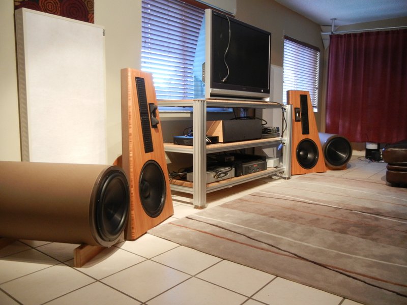

I moved my entire living room around 90 degrees last night to get the baffles away from the side walls and more symmetrically laid out.
Check it out.
Check it out.

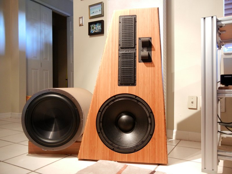

From a contributor on my own thread over at AudioCircle:

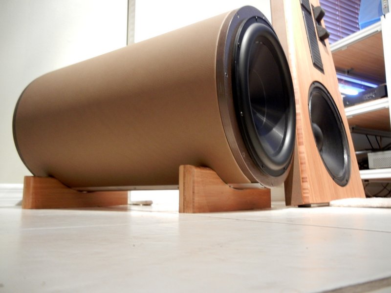

BTW I mounted a TC Sounds Pro 5100 18" Neo Subwoofer Driver on a 2' X 2' piece of plywood. The measured response at my usual 2+ meter couch listening location was surprisingly good - far better than the B&C 15" woofer! The 18" especially had far less distortion especially below 300 Hz, and the frequency response plot was smoother up to 300+ Hz (sorry, no pictures yet to post here). The TC Sounds 18" required much less EQ. IMO the 18” is not recommended for use below 50 or 60 Hz because my immediately behind-couch Velodyne DD-15 is preferred (again IMO because at very low frequencies a servo-controlled sub sounds good, and has measurably lower distortion).
Again, I don't know yet whether these measurements of the 18" Vs. the 15" indicate that the 18" woofer would subjectively 'sound' better than the 15" woofer. So far, it appears that the 18" should be OK as long as a steep low-pass crossover (say, 24 dB per octave slope) is used for below the 300 Hz area.
First generation is to screw top section to top lid or be separate, but had already considered two round poles feeding through top lid touching only top and bottom with some kind of absorbing material around to reduce transfer.
It would be cool if you could angle the top also 😀
Was 2am when I knocked that idea up, but yes had already considered doing that (was just too tired to draw it up) by putting a 45 degree angle on top of the 45 degree angled pieces and making the lid in two or four pieces.
What made me hesitate was the consequences of the driver above with the MDF sloping the wrong way.
Still thinking about it though.

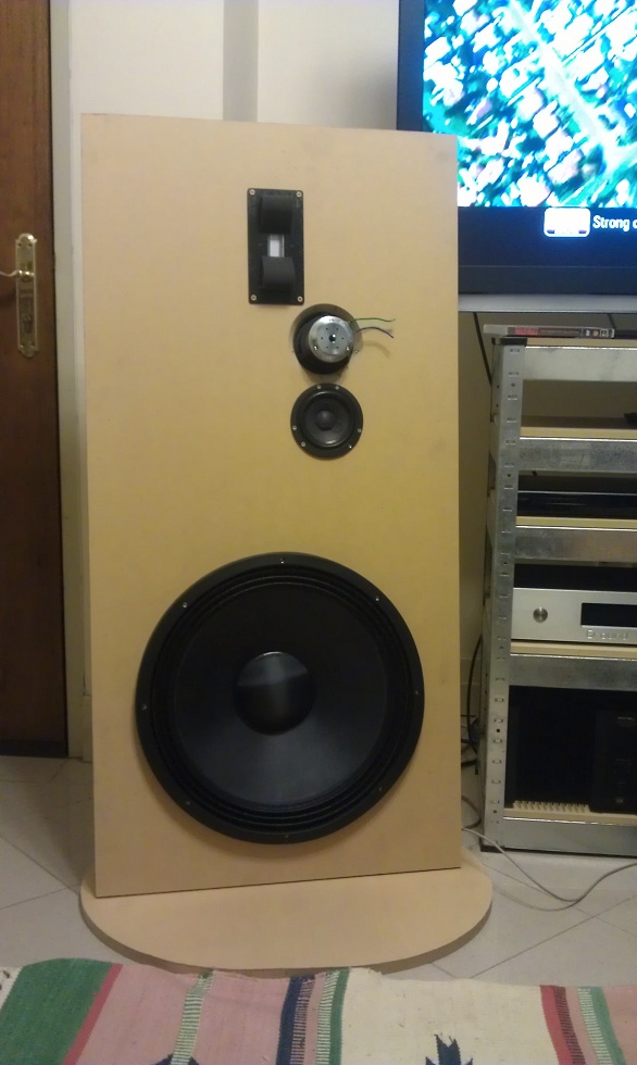

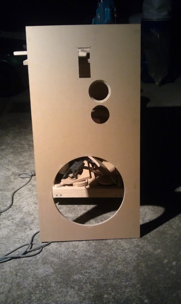

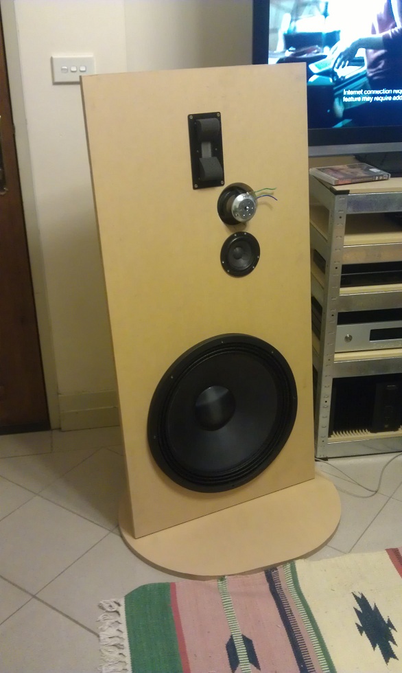

A baffle is born... Busy weekend planned, so knocked up a prototype baffle after work today. Still need to do some wings and mount the baffle to the pedistal, and rewire one of the 12MUs back in.
Sound different mounted in the baffle. First thing I noticed is that I have audible sound at only -60 (Ground Sound turn on level).
It got late so it didnt turn it up to regular level, but eveything sounds a little out whach like it needs to be reconfigured pretty badly.
Well this baffle is only a steping stone, and part of the learning curve to see what I do and dont like.
