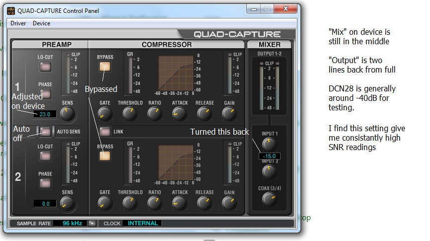

Tordenguden see pics for wiring. Instead of just replacing the loopback cable for another one, the Help says it is more accurate to use a Y adaptor.
I hope you are not planning to use an Y-adapter, to mix the loop-back signal and the output for the DCN28 - because that is what it looks like on the picture ?!?
The Quad Capture "only" has 2 channels running full duplex. And on channel, is used for reference in the software, so that more accurate result can be obtained. You may use an Y-adapter at Output 1, to simultaneously send signals to both left and right input on the DCN28 - but thats a different story.
The way I do it, could be wrong, but doubt it, since I'm getting pretty good results :D
Microphone goes to Input 1.
Loop-back cable goes between Input 2 and Output 2.
Output 1 is for DCN28.
Yes that is exactly what I was planning to do as that is the preferred option according to the Help.
That is how I currently have it set up but instead of buying a TRS to TRS cable I bought a TRS to XLR cable not knowing that it was not the same thing electrically.
How did you adjust the buttons - both front and back?
Back buttons:
Ground Lift = Normal
Phantom = 48v
Hi-Z (input 1) = Off
Front buttons: see pic

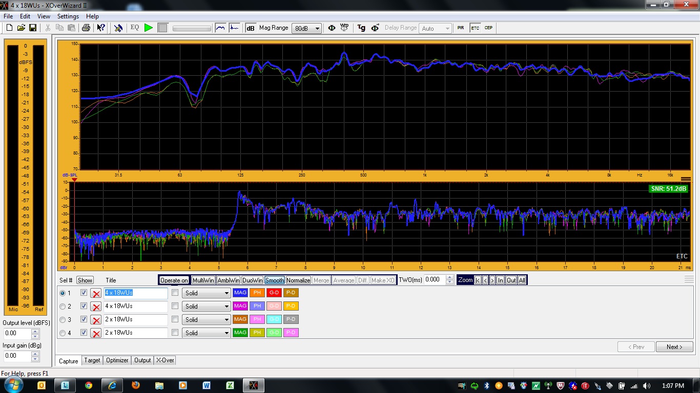

Finally got around to doing some comparative testing of 2 x 18WUs (8 ohm) vs 4 x 18WUs (4ohm).
I know some view using 4 drivers for a mid woofer as a bit of a waste, but I think the test results show a more preferable response curve using the 4 drivers.

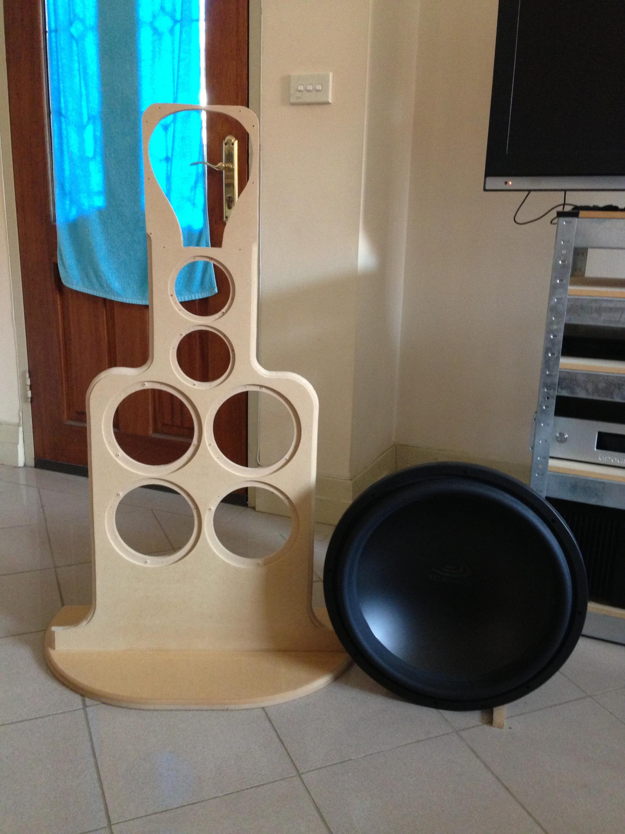

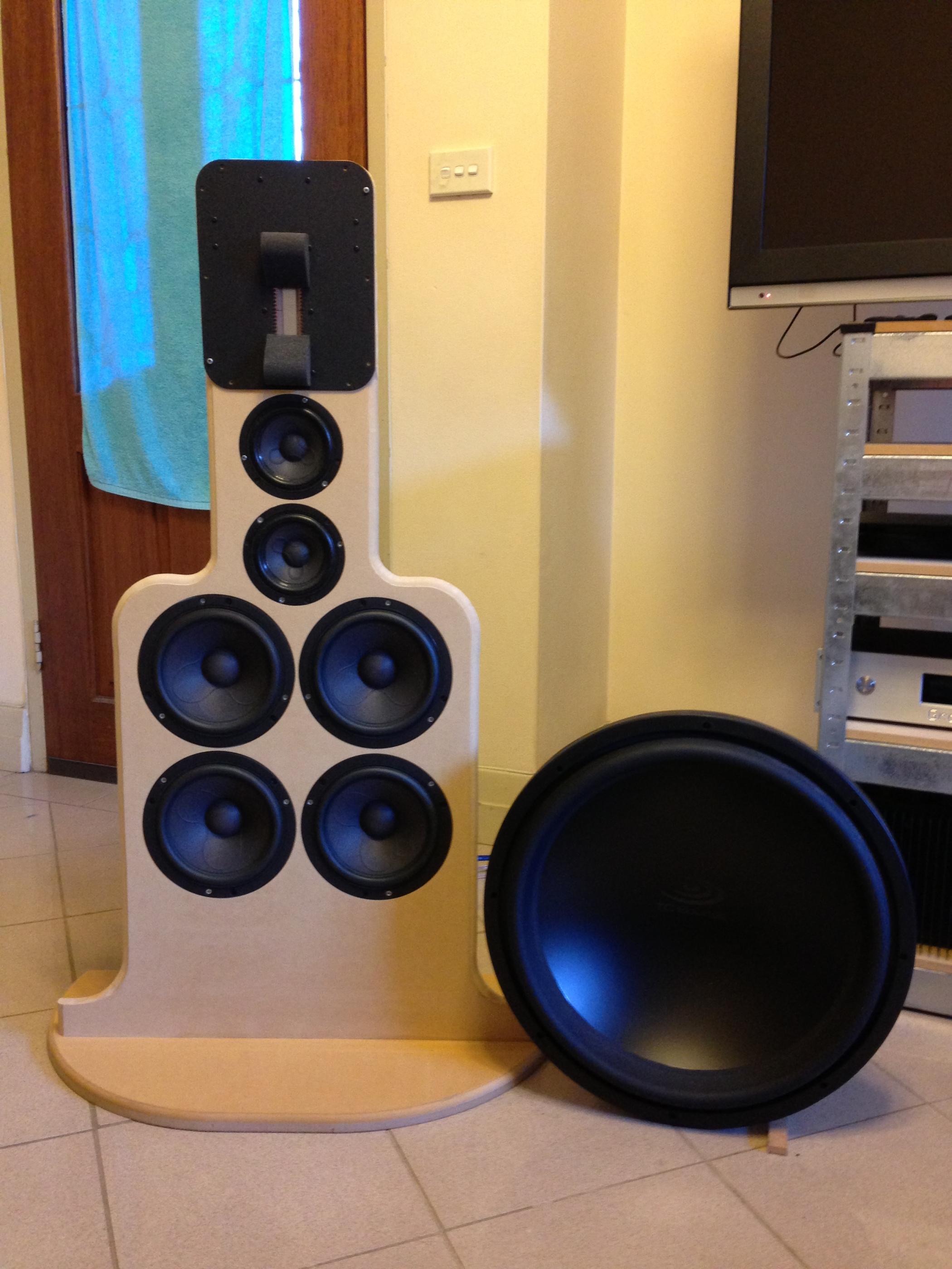

I plan to build a U frame similar to how they are laid out on the test baffle, and I may wind up picking up a bit more bottom end SPL, but that will just give me a bit more headroom to possible crossover slighly lower (~300Hz)
Already have an idea what the new speaker might look like...
The four 18WUs in a U frame at the top, with some kind of legs to hold it up, and provide slight angle changes.
Dangling bellow that the RAAL and the two 12MUs
Sitting on the bottom either the Pro 5100 in a H baffle, or two Dayton 15" reference series drivers in a slot loaded dipole.

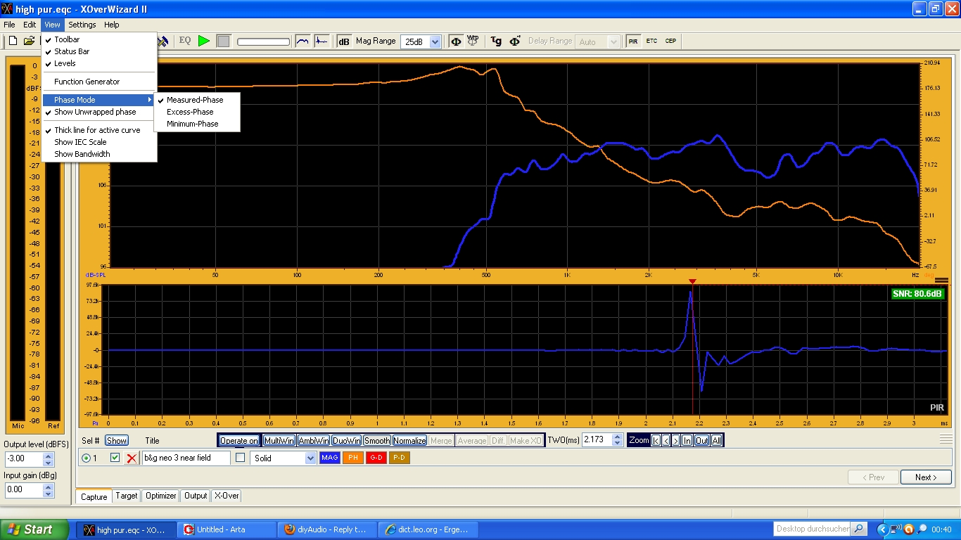

Hi Silent Screamer,
some commenst from my side:
1. There is a long long way to go for you... ;). I am now "digging in the dirt -of measurements and their interpretation" with my DCN28 & the XOver software since almost 2 years...
2. I am also using the 2nd output of the soundcard for the loop-back signal to the 2nd input. It´s precise enough, there is no need to use an Y-cable (right now, maybe 1.000 hours of measurements later). Other topics are much more important before considering about differences out of the 2 outputs.
3. Please consider the directivity index of your speakers first. It could save plenty of your time. Target is a constant directivity across all the speakers. The target curve at the listening position mostly depends on the directivity index.
4. Measuring positions: 1. fixed measuring on axis near field close to the speakers (~40cm) to measure the acustical phase. It is hard to get the correct phase out of the XOver software. Minimum phase is calculated and not reliable enough. You can get the correct measured phase when you move the red cursor to the peak of the impulse response and switch of "add propagation delay" in the FFT menu. Only with the correct phase definition a correct crossover prediction can be done in the XOver. Compare the phase measurement of XOver and Arta attached. Almost the same (above 600Hz) 2. Vertical middle between the two speakers to be crossed over. (check if the phase remains the same) to define the delay of the speakers. Note: filters and EQ´s will shift the phase sometimes more than 360°. The SPL then looks ok but the phase is not correct and the impuse responde / step respnse will be terrible - no punch/kick. Do not use 36dB, 24dB is more than enough. The higher the filter, the worse the impulse behaviour. 3. Wagged measuring at the listening position with > 15 averaged measurements finally gives you a good impression of the reality. A stationaire measurement at the listening position is useless. You can not measure the phase at the listening position because of the room, so don´t worry about the phase there.
5. Start to experiment with filters (24dB L/R). Then adjust the level as Robert already explained. Then the delay to get a good impulse response. EQ´s only at the end of the road after you found out the behaviour of your system.
6. Windowing with multiwin is not really usefull. A window of 2ms means a resolution of 500Hz (nothing below can be shown & 500Hz between each data point)

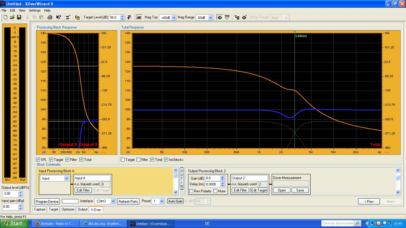

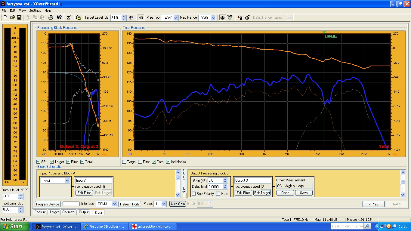

Attached an example: Prediction of the crossover function. Same speakers, same measurement. You can move the green cursor to adjust the takeover frequencies. Only if you have the correct phase information you can see what happens with the spl.
Recommendation: Use a second software to make control meaurements.
Try to measure the correct phase of your speakers. Try slightly different positions (+/- 20cm) to be sure to know te effect. I´ll go to sleep now.

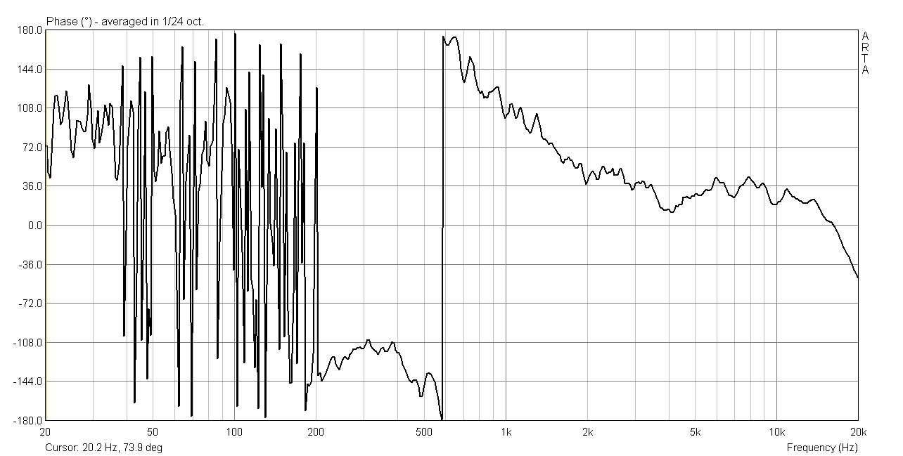

I have yet to understand what phase is and what it does, I have been aware of it for many years, but still don't know where it fits into the scheme of things. Would like to buy a book that explains the basics, but I find most stuff online delves into things too deeply before explaining the concept of it.

4.3 Ok phase cant be measured at listening position effectively.

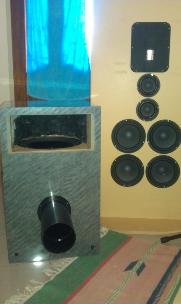

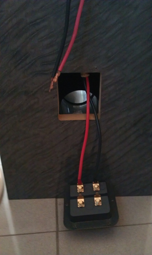

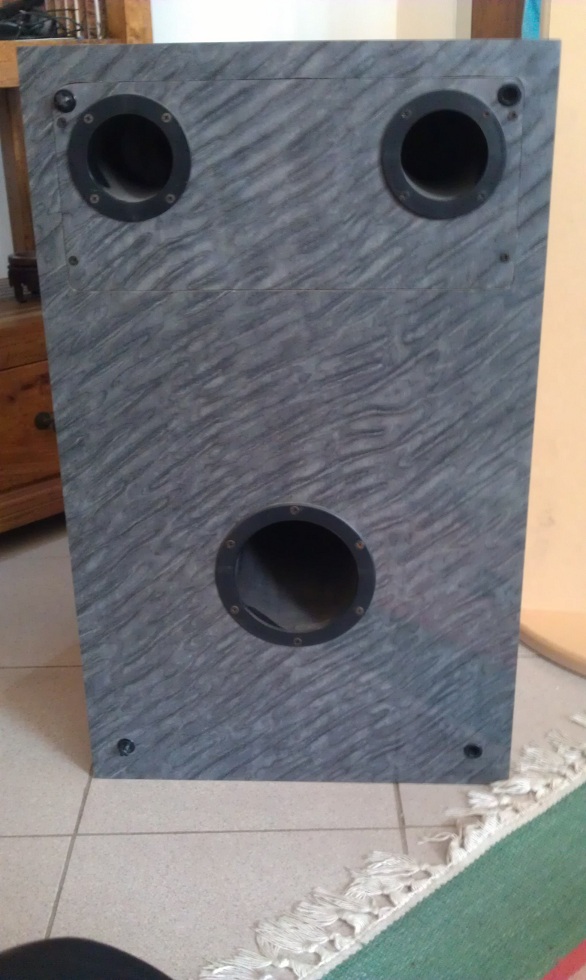

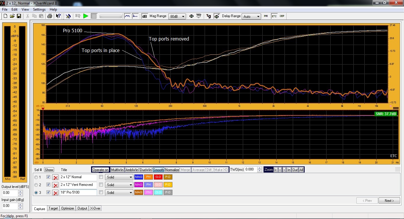

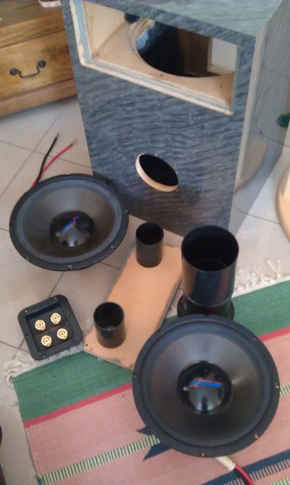

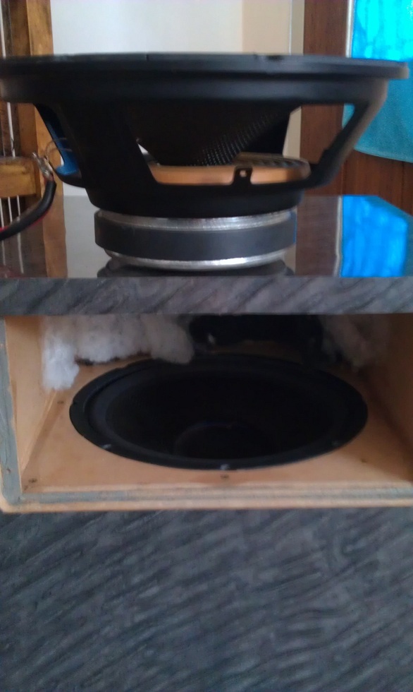

Having just returned from a long trip to my mothers place (~2000 klms round trip) I brought back with me a sub woofer I made back in the late 90's.
I did some measurements on it with and with the the top ports in place. With the ports in place it acted more like the double band pass (Isobaric push - pull) it is, but with the top plate removed it measured very similar to the Tc Sounds Pro 5100 18".
I just used the same woofer crossover point and amplifier so I could do a back to back comparision. There was still no real bass to speak of which has me wondering if the pre amp in the DCN 28 is putting out enough voltage to really drive the 1000w per channel amp properly.
Since neither speaker is really moving the cone a great deal I have to start looking at something to explain the lack of cone movement.

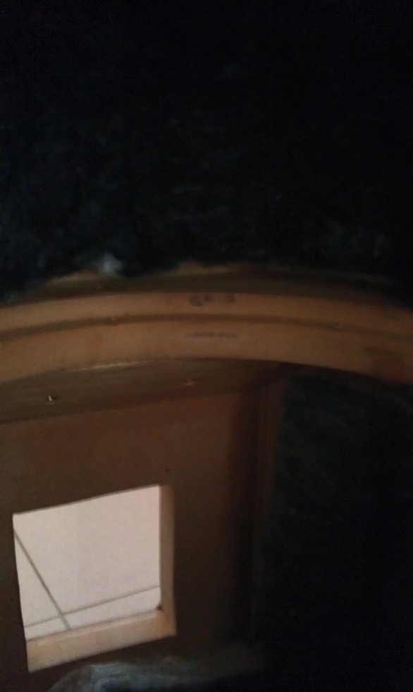

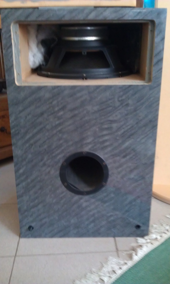

I tried both ported and sealed with a single 12" driver and there is no apparent difference between the old sub and the 18". Currently I am running one of both to do some listening tests.
I moved the port to the outside to make it easier to change between ported and sealed (port hole blocked off)
Try out the following: Make a blank XOver e. g. with two output channels. No measurements. Define filters with the and play around with the quality of filters, reversing, delay, and so on. You will see that every action shifts the phase more or less. See what 24db & 36db leads to - I tried it out. A dip in the SPL and a wave in the phase.[/QUOTE]

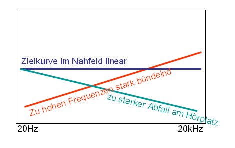

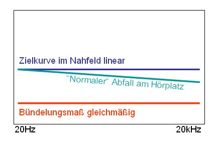

Why haven´t you choosen a vertical line up of all chassis B-M-H-M-B which leads to a cylindric wave front? Might be better with less elimination and better localisation?
Best regards and a good new year!

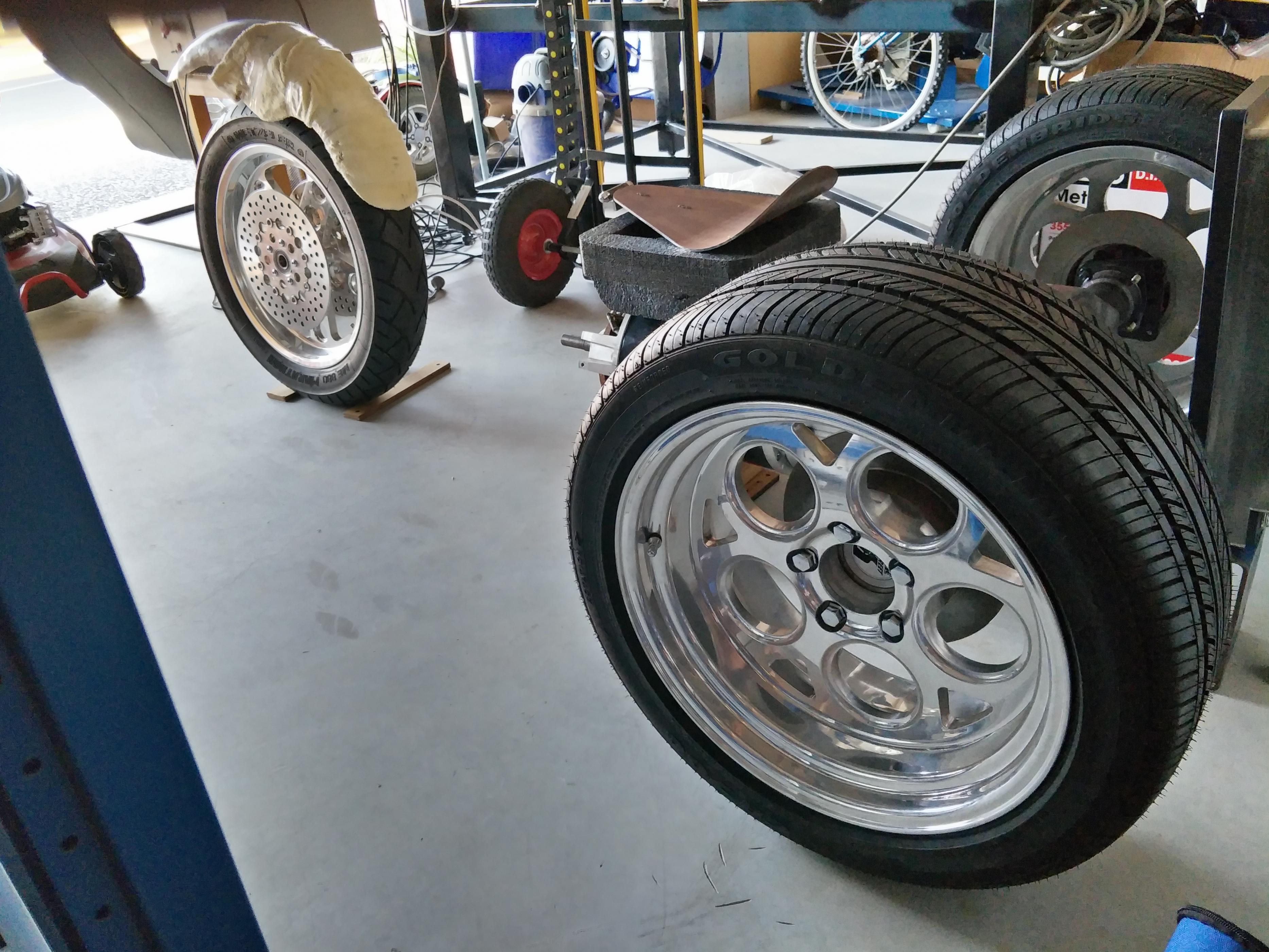

Ok, what I have actually managed to achieve in the last 5 years is build myself a fairly sizable CNC machine so should I ever get off my bum and get back into building speakers the job will be much simpler.

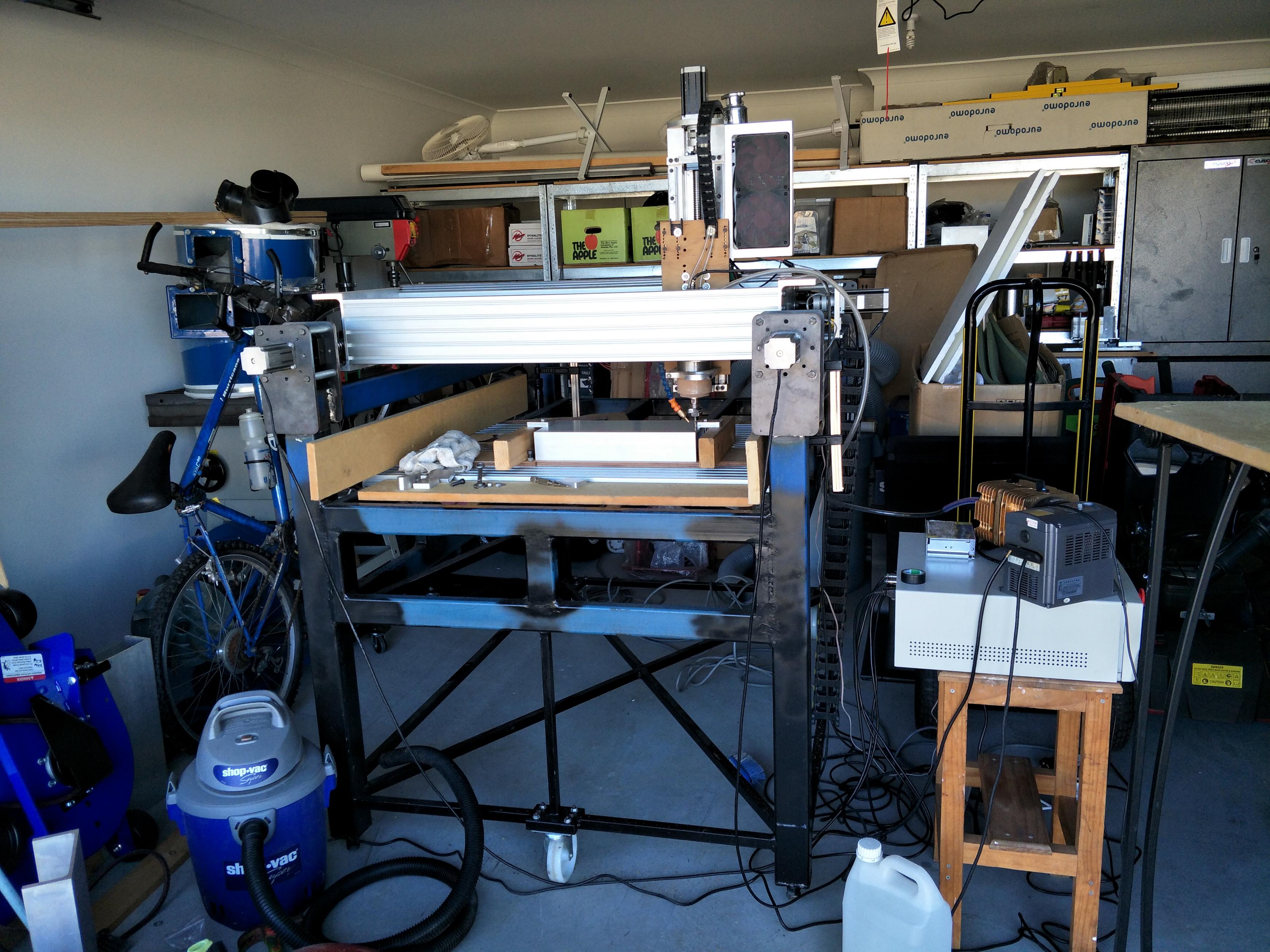

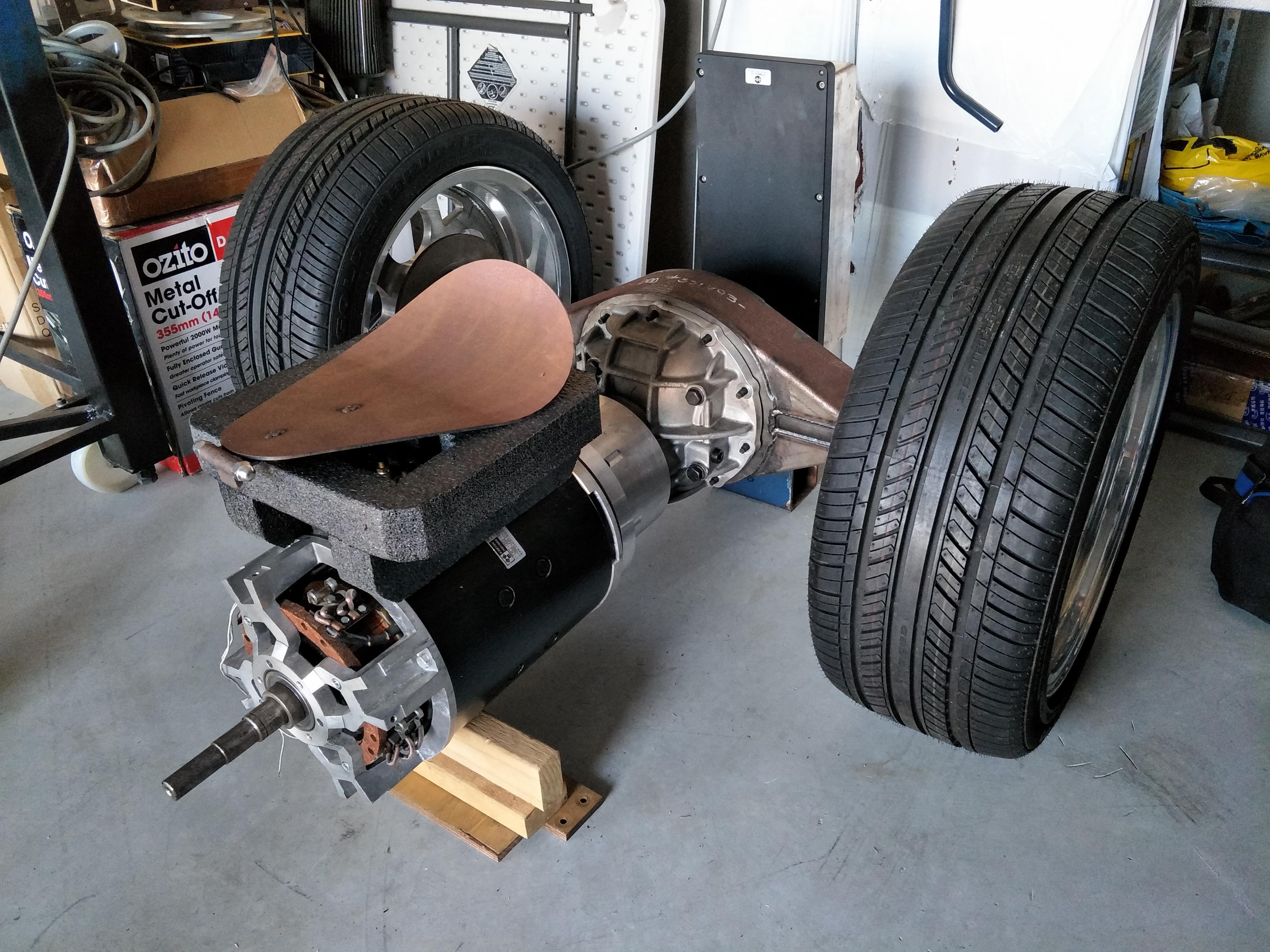

Tell me about it. I have an electric tilting trike I started about 9 years ago. The CNC has progressively been getting better and better for about the last 3 years. The plan was to build the CNC so I could finally use up all the drivers I have kicking around. So far all I have done is upgrade the CNC.
But I can feel a surge of speaker building coming on, it's been building up for the last 6 months.
