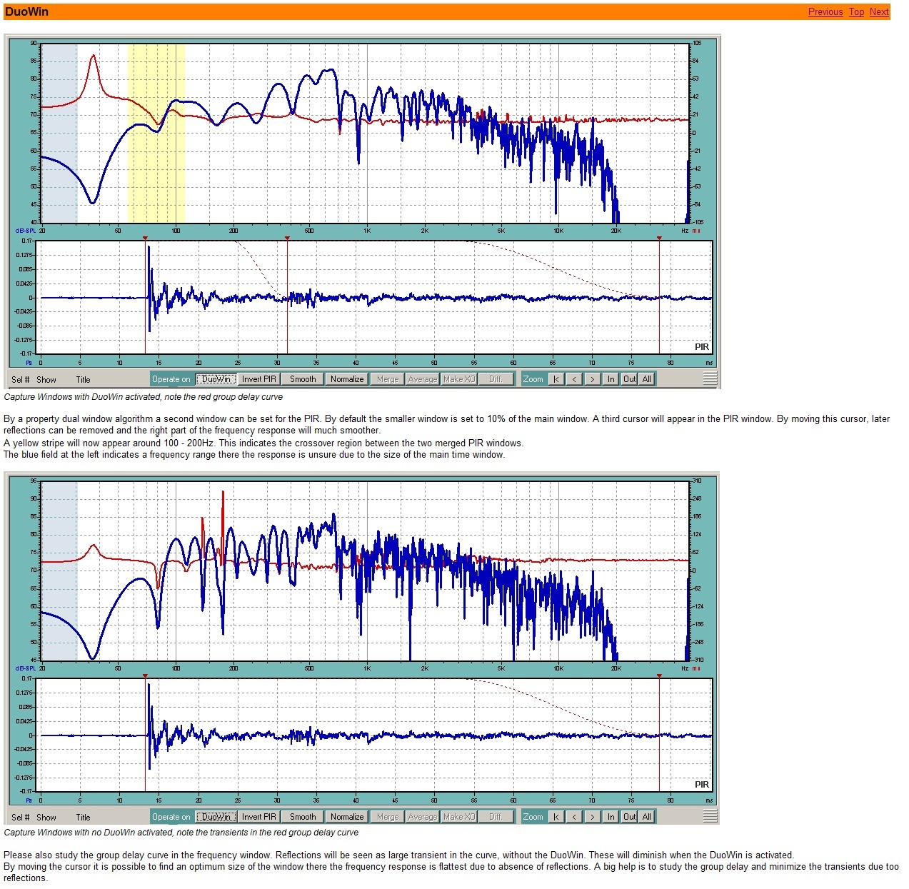

As i understand it. The first and last line indicates the outer borders. So for now, leave them "out" there 😉
The second red line should be placed right before the first floor bounce. It works here. There are still ripples at the measurement, when gating correct. These might be from your front baffel or driver design.
If you measure from your listening seat. You are including the room to much and therefore making the sweetspot very small.
Measuring a speaker, is about making the speaker working its best, in its enclosure - without the room affecting.
Hope it helps a little 🙂

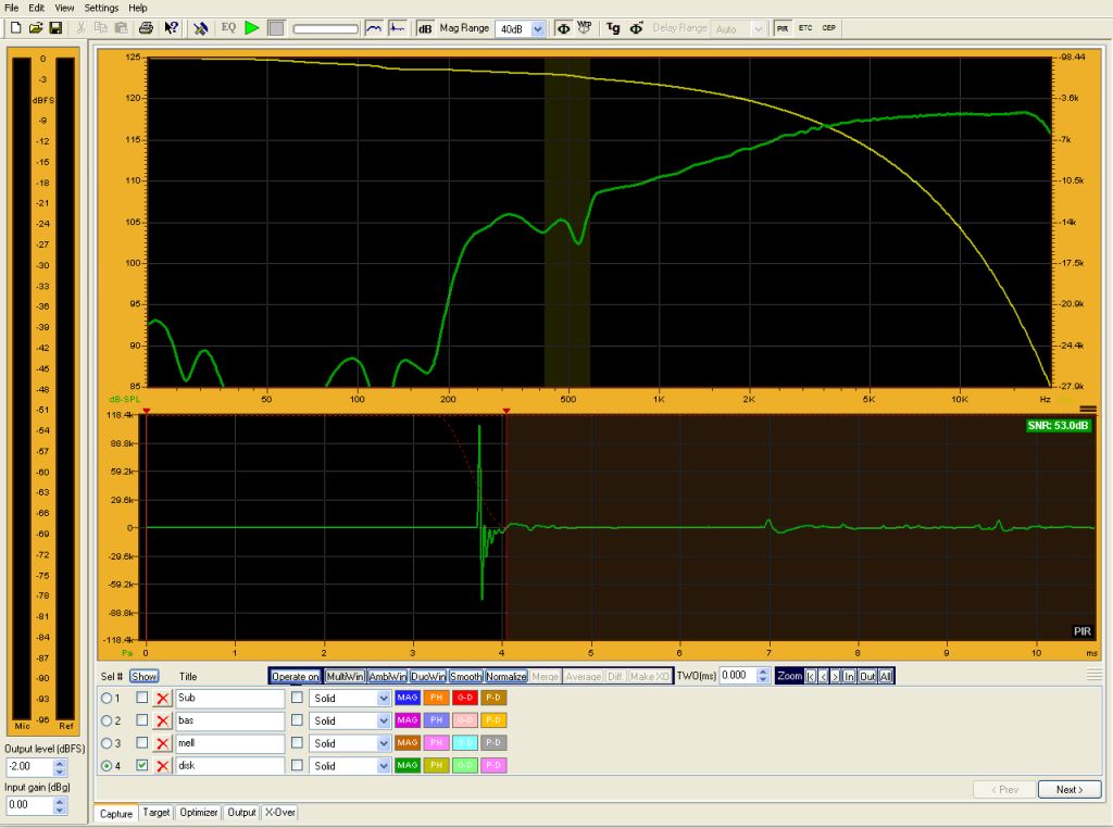

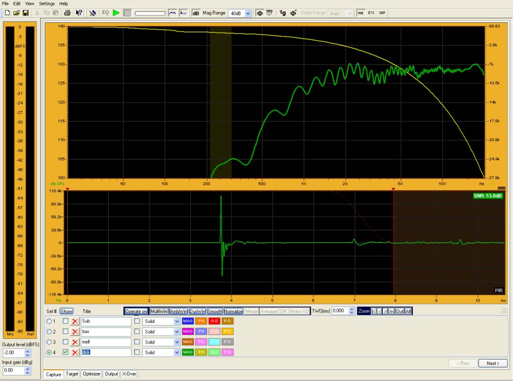

Hmmm... tried to make links for pictures. Did not work. Then I found out that I could upload pictures directly. And know I cant remove the links again.
Pic 1: To much gating = low frequency missing
Pic 2: To little gating = some room reflections included
Pic 3: Getting close. Some disturbance might come from baffel and driver design.

Paul – you can do it like Tordenguden show it. Even better is to use the ETC visualization (button in the toolbar next to PIR) then you will see something like the attached picture.
The first red line should be placed where the signal rises above the noise floor and the second red line at the first reflection. This will give you the frequency response of the driver without room.

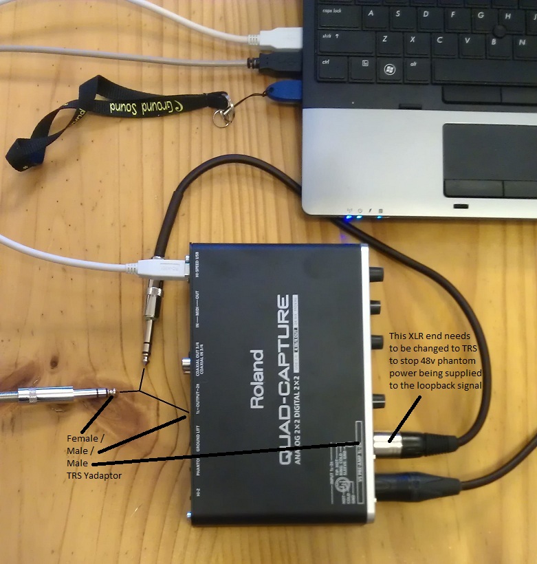

Hi Robert, unfortunately no I still don’t have the cables sorted. I am still waiting on that new TRS Y piece to turn up from the US. I can see it was posted on the 8th of December, but once it leaves the US there is no tracking on it. I hope it turns up soon, as I am eager to have the cabling problem sorted properly once and for all.
I have the feeling it probably won’t be long enough anyway, and I might need to order some additional cables, as I ordered it before you explained why I needed the TRS-TRS (no 48v phantom) it was just luck that I guessed the right one to order, but going off the picture it doesn’t look long enough to loop from the front to the back, which means I may need a TRS female to TRS male extension.
I have also been practicing a bit more with the Roland 55 AU to get the SNR up. What I found was while I had high readings on the tweeters by the time I got down to the mid woofers and woofers it had fallen below an acceptable level, so I believe I now have it tuned in a way where I have good solid green readings on all of the drivers, which showed immediate improvement in the flatness of the captured response, especially in the lower frequencies. I am now also using the ASIO mode like you suggested.
I had a quick go at what you described and I think I have it right… From your picture I can’t see what button you have pressed down the bottom to get your third line. Are you using the same version of software as me?

Still looks weird - but I think it will clear up, when you get the rigth cable. SNR will allways be worse, the lower the frequency - it's the reflections and long wavelengths again 🙂
Why did you buy in the US? Don't you have music-gear-shops down there? It's just a 1/4" jack to jack cable, at about ½ meter. Should be extremely common in the music business.
Could you post pictures of the soundcard with cables and the buttons. Then it will be easier to figure out, if we are doing the same thing 😉

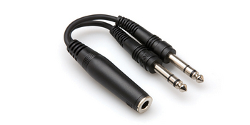

Tordenguden see pics for wiring. Instead of just replacing the loopback cable for another one, the Help says it is more accurate to use a Y adaptor.

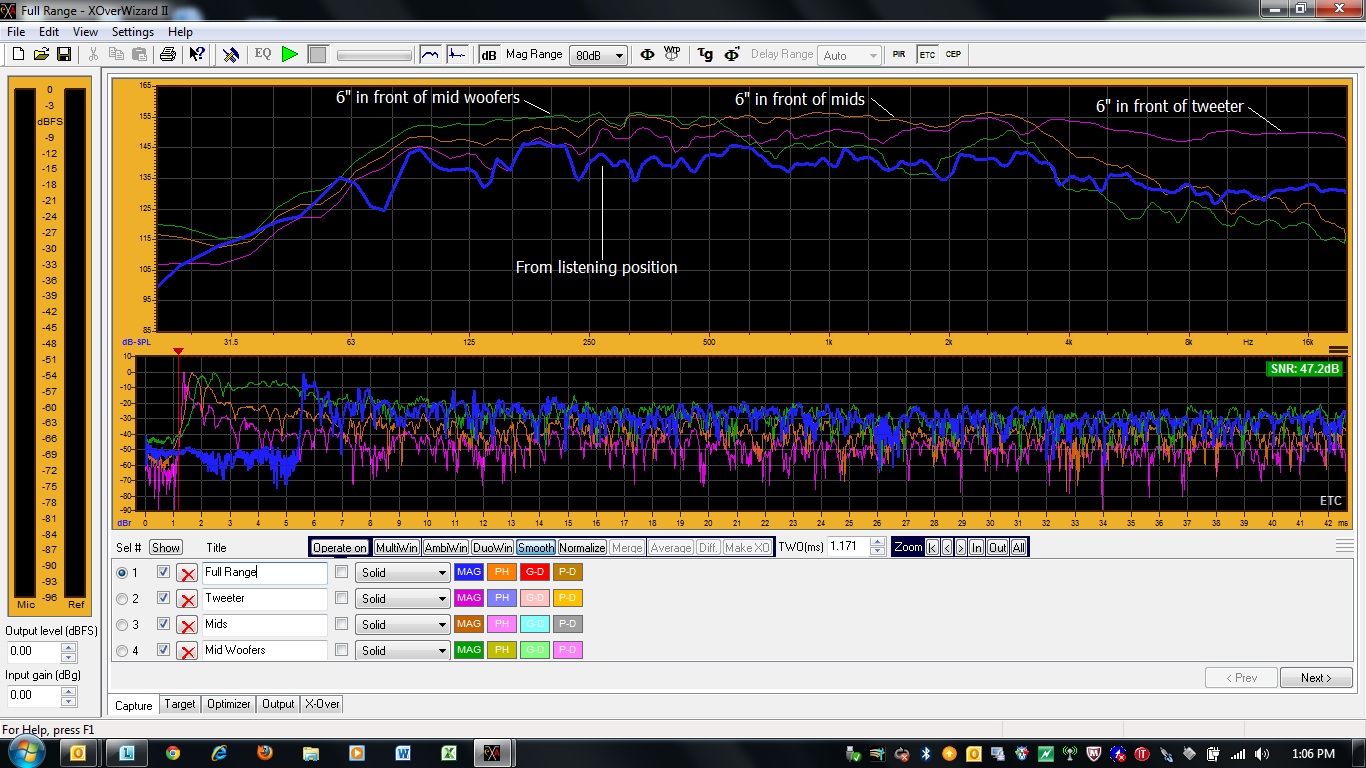

Just looking at the full range graphs in posts no's 356 & 360 and it looks like I might be able to drop out two of the 18WUs, as it is a few dB higher, as an alternative to attenuating the channel.
Been doing some more measurements this morning. An interesting observation when measuring each of the drivers in its “optimal” mic position (on axis ~6” away)… each driver is a lot flatter then when it is in a not so optimal position (measuring another driver).
Which has me thinking again while it is great for speaker manufactures to measure their driver in the ultimate light that makes them look fantastic. Unless all of the drivers are clumped in one spot to some degree you have to be listening to some of the drivers in a vertical off axis position.
Which makes me further think any correction should also be done when measured from the listening position. I won’t get it as flat as if I was measuring near field, but I don’t plan to listen to the speaker from 6” in front of the tweeter, I plan to sit down to listen to them.
Do I want to know what I really have in my seated position? or have a dead flat response to say it looks good? I listen with my ears not my eyes, so I am thinking what is right is from where I am sitting.
I'm a noob when it comes to this kinda of stuff, however I'm a believer in listening from the intended listening position. What good is a freq response curve that looks great from say 1m, when at 2-3m off axis the whole picture falls apart.
I do believe that near-field measurements are great for getting crossovers correct, measuring at the intended listening position and of course your ears should be the final say so.
I know for a fact that my setup isn't ideal, however it sounds great so far with very minimal "tuning" and I'd be hard pressed to make any more changes to it until I have much more time on my hands. Also - the wife approves 😀
EDIT: The only downside as far as I can see about measuring at the listening position is discovering how "bad" a room can be to accurate frequency response...treatments and speaker position could be vital here more so than adjusting the audio source-to-speaker chain itself.
Yes I tend to think the answer lays in there somewhere...
I can't swing a cat in here now so there is no room for accoustic improvements, but that is not to say it isn't on my list of things to do in the place I will be getting.
I am just trying to convince myself it is a good idea because most of the people I think know what is going on seems to measure closer to the speaker.
When I try to do individual speaker measurements, then corrections, the corrections sound like crap, and the base crossover sounds better.
I have had some improvements with the corrections but I think that was when I was closer to the speaker, so it looks like more trail and error is required.
I also can't wait to get my cables sorted out because I have no idea how much that is contributing to measurement corruption.
