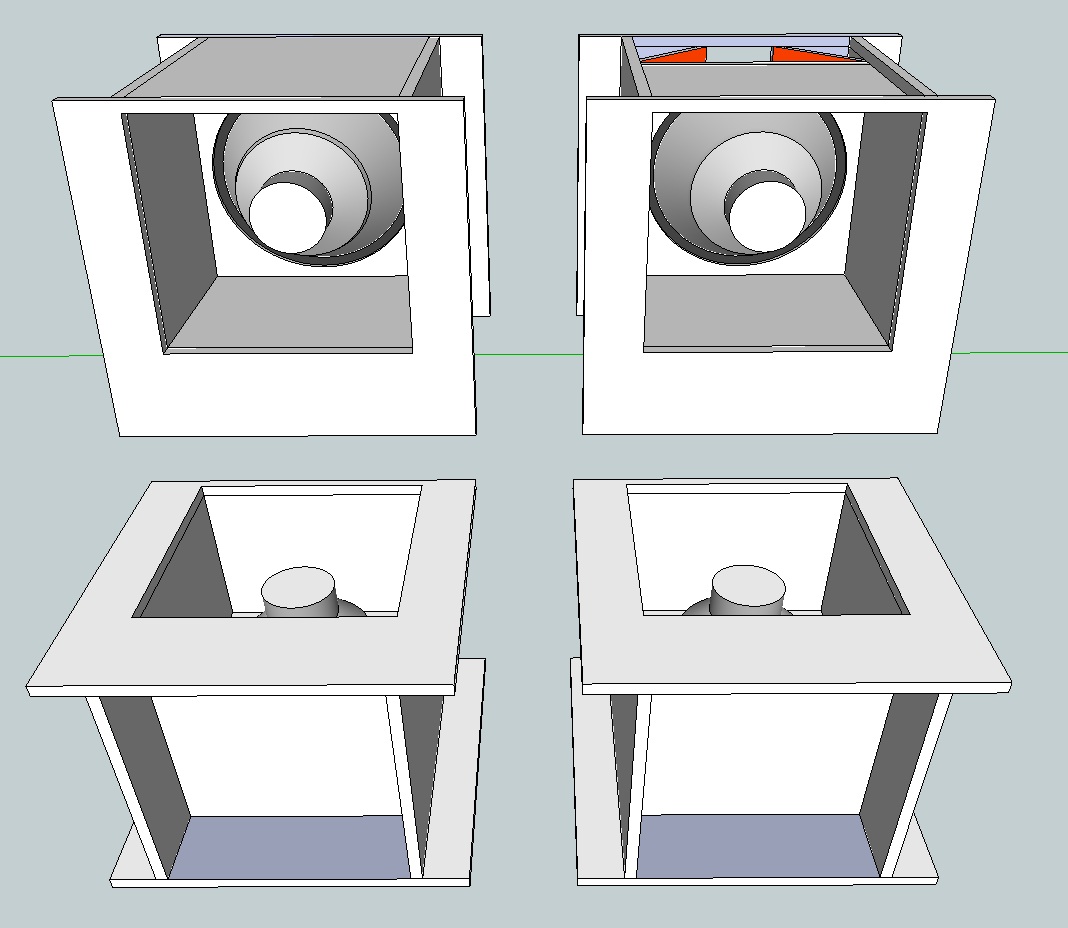

There are several way to get around the issue of accessing the screws.
1. Build a v with a -- top. Something like this -\_/- mount the two drivers to the v-baffle. Slide the whole assembly inside a [] box and put screws in from the side [] <-
2. Build the same box as 1 but glue it up and make it rigid. Have circular holes in both sides to allow fitment of drivers. Once drivers fitted screw on square or round side covers. What I like better about this idea is if you have really long drivers like the ones I just bought TC Sounds Pro 5100 18" Neo Subwoofer Driver 293-674 you could cut a smaller hole in the cover plate and let some of the driver (magnet) hang outside the box. Keeping internal volumes down.
3. Another idea I had was do the same thing with just one driver, use a H box, mount the driver from the back, and taper the front four faces in so the out volume is smaller than the back. Same effect higher out speed than rear.
A simpler way would be to make a regular square box and just make four tapered inserts for the front.
Anyone with fibreglass skills could probably make it as a removable insert allowing fitment of the driver from the front.
Maybe even add some kind of extended baffle plate to the insert?
Put together some Sketch Up pics of the single driver version.

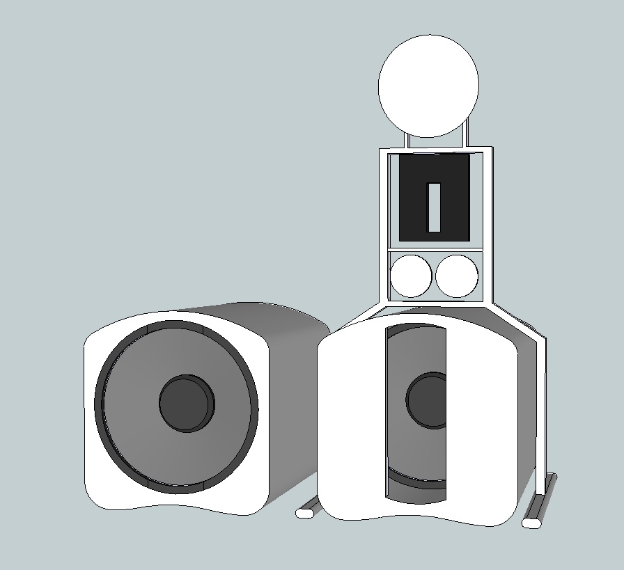

Thinking 2 x 96dB 10's is probably overkill, so mocked up a 10" and 18" cabinets.
Used this way each baffle plate would extend the other.
Green legs support tweeter - mids
Blue legs support mid woofer
Floor supports woofer

I would not run the 10" with any kind of slot restricting the output. It is running high enough that the slot may 'sound' bad. You can always start with flat baffles for the prototype and add a slotted piece over the front to see if you can hear a problem.
The problem with NOT using a pro driver for the 10" is that you will have a tough time finding a hi-fi driver with a sensitivity high enough to match the other drivers you've got. Don't be scared of the 'pro' thing. A good driver is a good driver regardless of the intended use. In the range you will use one, most any 10" is going to be flat. But if you must see the response, look here:

Greg if it’s recommended no compressing of the driver for the 10", then I probably wouldn't bother with an upper cabinet, I would probably just do a free air hang like one of the earlier 4 way pics of natehansen66 back in post #44.
Also would mean the tweeter would be further away from a radiating surface.

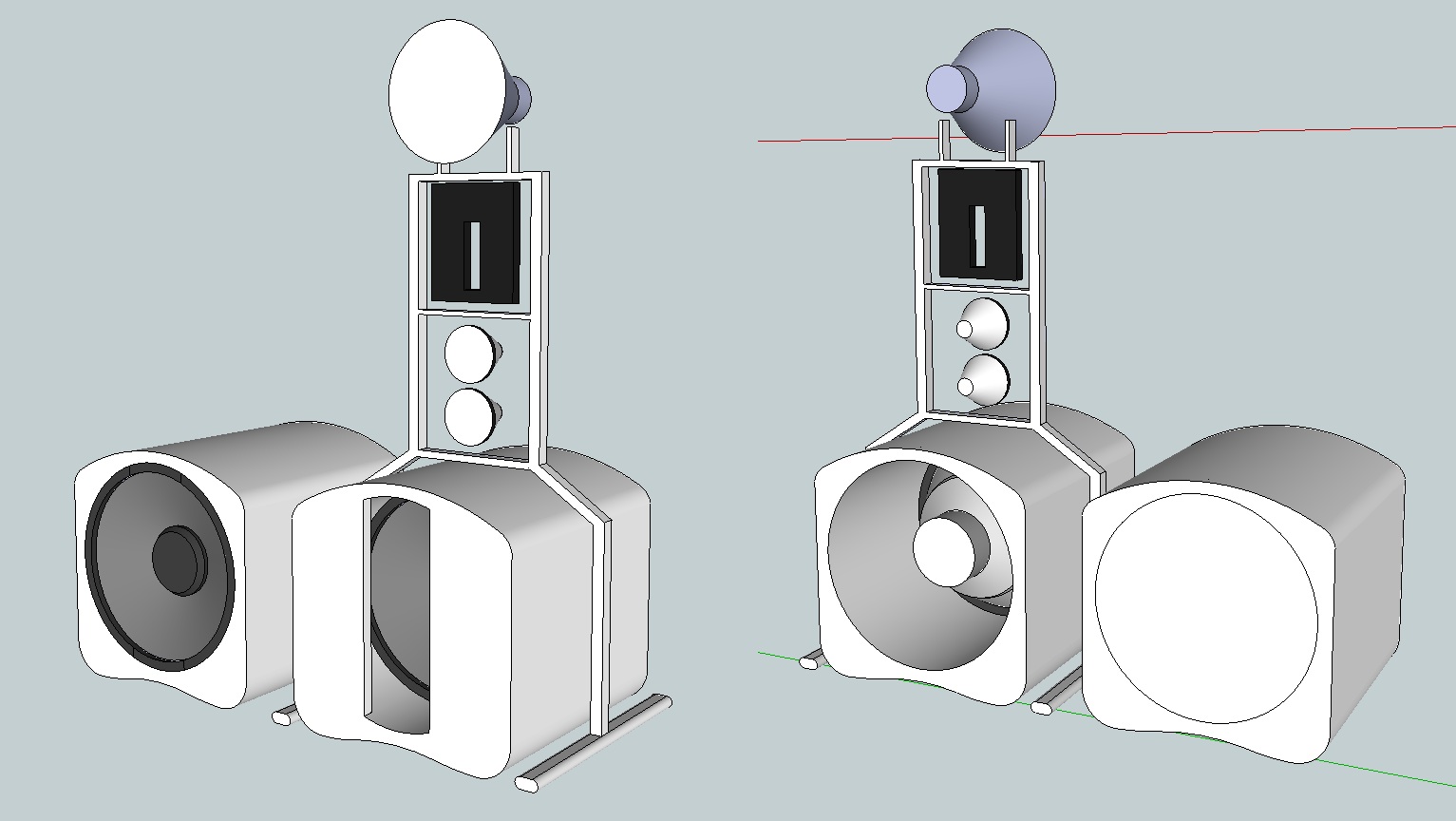

While I wait for the new drivers to arrive I have been busy playing Sketch Up. While the test baffle will probably be quite basic I was looking at what might be possible with a bit of imagination.
Using the slice model spoken about earlier, I could potentially make the sub woofer walls as thick as I want i.e. if I want them to be 4" thick I just leave 8" between outside diameter and inside diameter.
Of course some kind of common sense would need to be applied as I have to move it...
So here they are the latest musings...

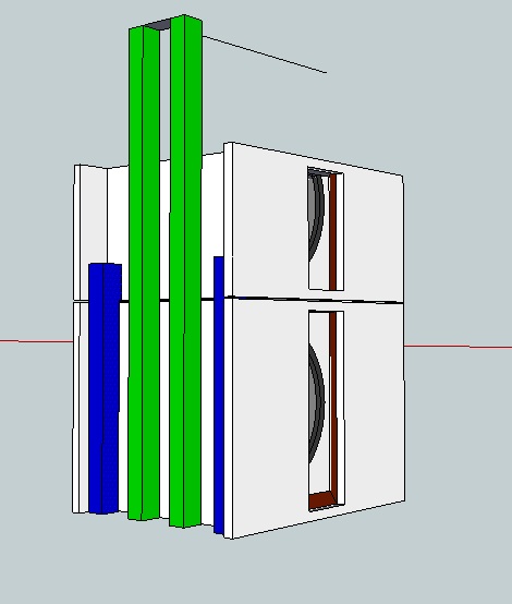

Just wondering if this would be acceptable... By putting the 12MUs side by side instead of one on top of the other I can save about 150mm or 6".
This measures up at 130cms or 51.25", which is about as tall as I would prefer to go.
