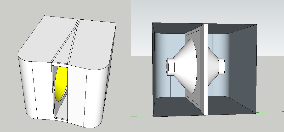

Ok time for a new design... I call this one "the butt crack" 😀
It's a modified version of the Slot Loaded Open Baffle.
Rounded front exit to smooth the sound transition. Closed in back to reduce baffle size.
Figure this would be fairly easy to make, two symetrical sheets of 10mm folded acrylic, glued at the centre back join (nice solid gluing point), and top and bottom plates...

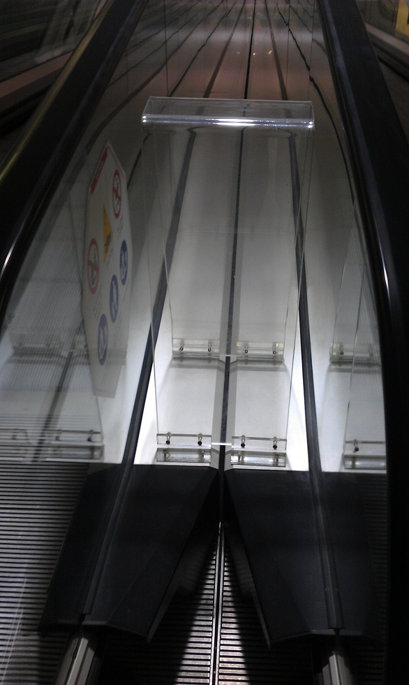

That flexible MDF would probably be an easy way to do a round tube..
But I do like the idea of using the clear acrylic. Just came back from the shopping centre and on the way out I spotted these.
Looked like 10mm so it gives me a good idea of how far it can be bent.

In the case of the bends shown, bear in mind that the acrylic is heated until it gets soft, and then bent at any angle needed.
The downside in your application is that the heated area will look wavy and distorted...
The pictures of the acrylic in the shopping centre looked ok, and I was thinking of fairly large radius like in the Sketch Up pic, maybe several inch radius. would probably use bendy MDF to prototype.
The smaller the radius(less than a couple of centimeters in the case of the shopping center bends), the less obvious is the distortion.
On a 20cm radius bend, unless you have specialty industrial grade equipment, getting it to look good will be quite a challenge.
The bendy MDF might be the best was to go.
P.S: have you thought about the acrylic's resonance? I have no idea what the intrinsic resonance frequency of such a tube would be, but it's a good idea to check it out first.
