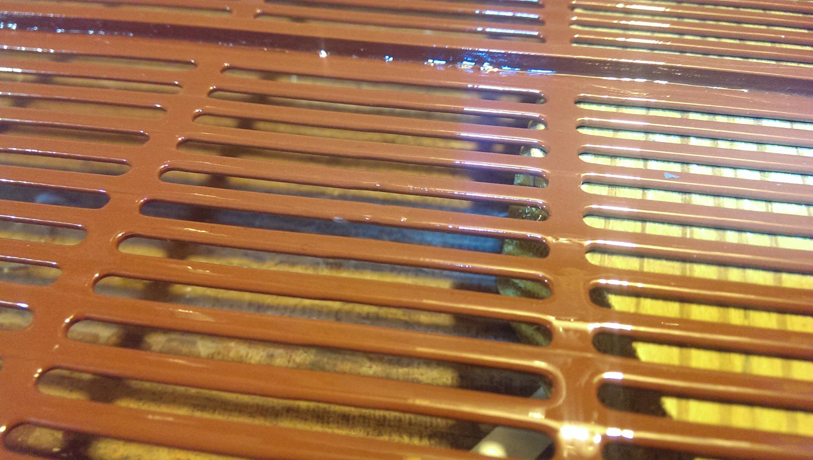

So I assembled the a single panel (with a diaphragm) a short while ago and I had some issues. I was getting a periodic clicking sound -> arcing from the bias to a stator. Anyways, it seemed to be only on one stator (I disconnected them to test). Not only was it arcing but it was pulling the coating off! The surface looks chipped in those areas.
I know that Jer had mentioned this happening with the coating not fully dry yet. I'm pretty sure that mine has been dry for about 4 days. Anyways, I disassembled them and I'm going to patch those areas with acrylic nail polish and then re-coat with clear spray acrylic. Then I'm on vacation for a while so it should have plenty of time to dry.

Is it a PET film or something else? Did you clean the film with alcohol or acetone before coating?
The Licron coating should be sufficiently dry in a few hours at room temperature, so that's not the issue. You did apply the Licron AFTER tensioning the diaphragm, right?
It is 6um mylar. Actually I just cleaned it gently with compressed air. Perhaps this was not sufficient. I got nervous touching it after tensioning. It seems like it is ready to burst at any second!
Charlie, I did apply the licron after tensioning, after the diaphragm was applied to a single stator. and my worry was not about the drying of the licron, but the curing of the stator coatings.
Sorry if there is any confusion. There was arcing between the diaphragm and one of the stators. It occurred with or without any signal applied to the stators. If the DC bias was powered on then the arcing would occur. This arcing was chipping the coating on the stator.
with two- or three-layer coatings of the stators this may occur.
When my panels just have been powder coated but not had their final wet top coating sometimes the effect occurs when arc testing.
The layers are a black colorizing top coat over a white functional base coating.
If the powder has not melted completely pin holes may develop.
When I test the panels I lay down a piece of aluminum foil on the panel and use a higher bias voltage than used later under normal working conditions, together with a rather low valued current limiting resistor of the bias supply.
In case of a pinhole or a defect the black top coating is literally blasted away at the arcing point.
Also the quite strong arc kind of hammers a small spot into the aluminum foil, thereby making identification of the position of the arc easy.
Panels arcing under this test will be rejected and only those passing the test will receive the final wet coating layers and undergo another arcing test.
So, I´m afraid that Your stators are still not insulated well enough.

I agree that the insulation is insufficient. It seems to be the only reason that this would happen. What surprises me is that I did not find any problems while arc testing the panels. I did not, however, use Al foil as you suggested. I simply used some frayed wire acting like a brush.
Also, this only occurred on one of the stators, and mostly on one particular side of the slot edges. Perhaps that stator/edge missed a coating or was insufficiently coated vs the other.
Anyways, I will be patching those problem areas and re-coating tonight. I may even add a few extra coats. Fortunately it was quite easy to disassemble them. I don't mind doing it, but I'd rather not do it too many times (wasting materials and my patience...). I will post some pics later.

Here is a pic of a spot where the arcing occurred and the coating was pulled off.
So I think that the problem is that the coating was not fully cured. The paint oem recommends 5-7 days at 70 Deg F, which I'm pretty sure I did not get. I did the thumbnail test on that panel and it wasn't fully hardened. Most of the time these were sitting in my garage (~50 Deg F) where they will cure slow. I placed them in my basement near a furnace vent for 2 days to speed it up but 2 of the panels did not have an unobstructed line of sight to the vent.
Anyways, I'm going on vacation so I'll finish patching that panel tonight and let these rest for about 10 days. Hopefully that does it!
Perhaps it's not clear in the picture: the damaged area is in the center of the picture, on the edge of a slot, it looks grey
There is another grey spot on the right side of the picture on the top surface. This is not a damaged spot, though it looks similar. It is some dirt or debris.
Thanks for the pic.
Based on your description, perhaps it wasn't that the coating was sufficiently thick but that the coating was still conductive since it hadn't fully cured.
