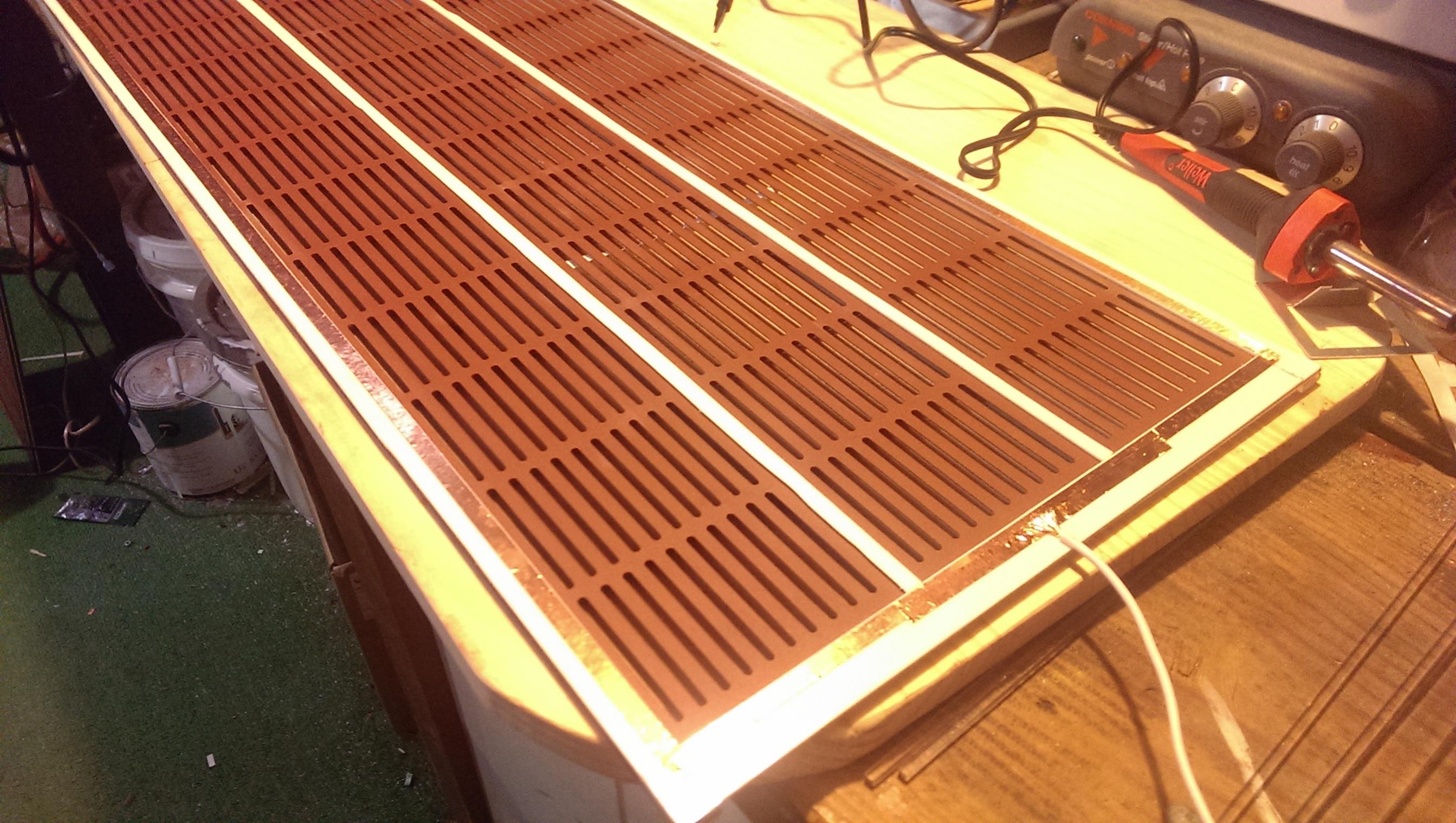

As you can see I machined the stators to perfectly fit the thick film SMD resistors. This resulted in a decent looking and organized segmentation at the bottom of the stators. Soldering was tricky, though. I had to time it just right to prevent the heat from traveling up the Cu and damaging the paint. Properly chosen solder, paste, and soldering temperature was the key here.
I wanted to use the garolite as my stator-to-diaphragm insulation as it has reasonable insulative and dielectric properties, and it is certainly more homogeneous than the rattle-can applied coatings on the other side.
The PCB is 1/32" thick, including the copper clad. Of course the copper clad is quite thin.

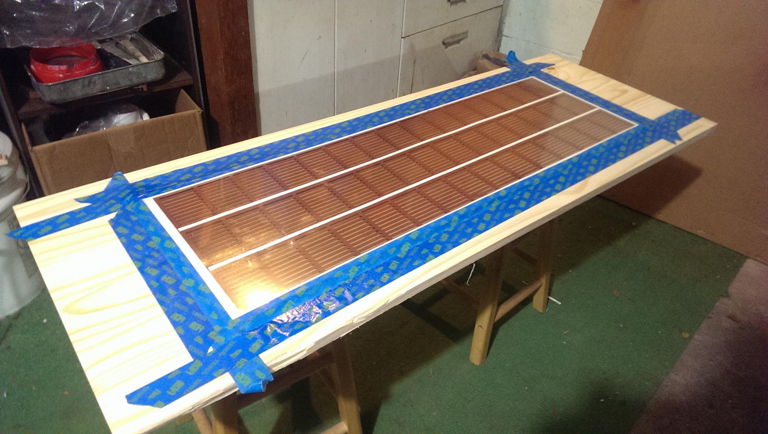

Btw, here are some pics of the stretched diaphragm applied to the stator with 1/16" thick tape. I have already coated it with Licron. Now just waiting 24hr for it to dry.

Each resistor between segments is 220kOhm rated to 500V. Of course both stators have resistors so these effectively double. I have 33 total segments.
I was a bit worried about this at first but the voltage across the resistors is quite low while listening to anything other than sine waves.

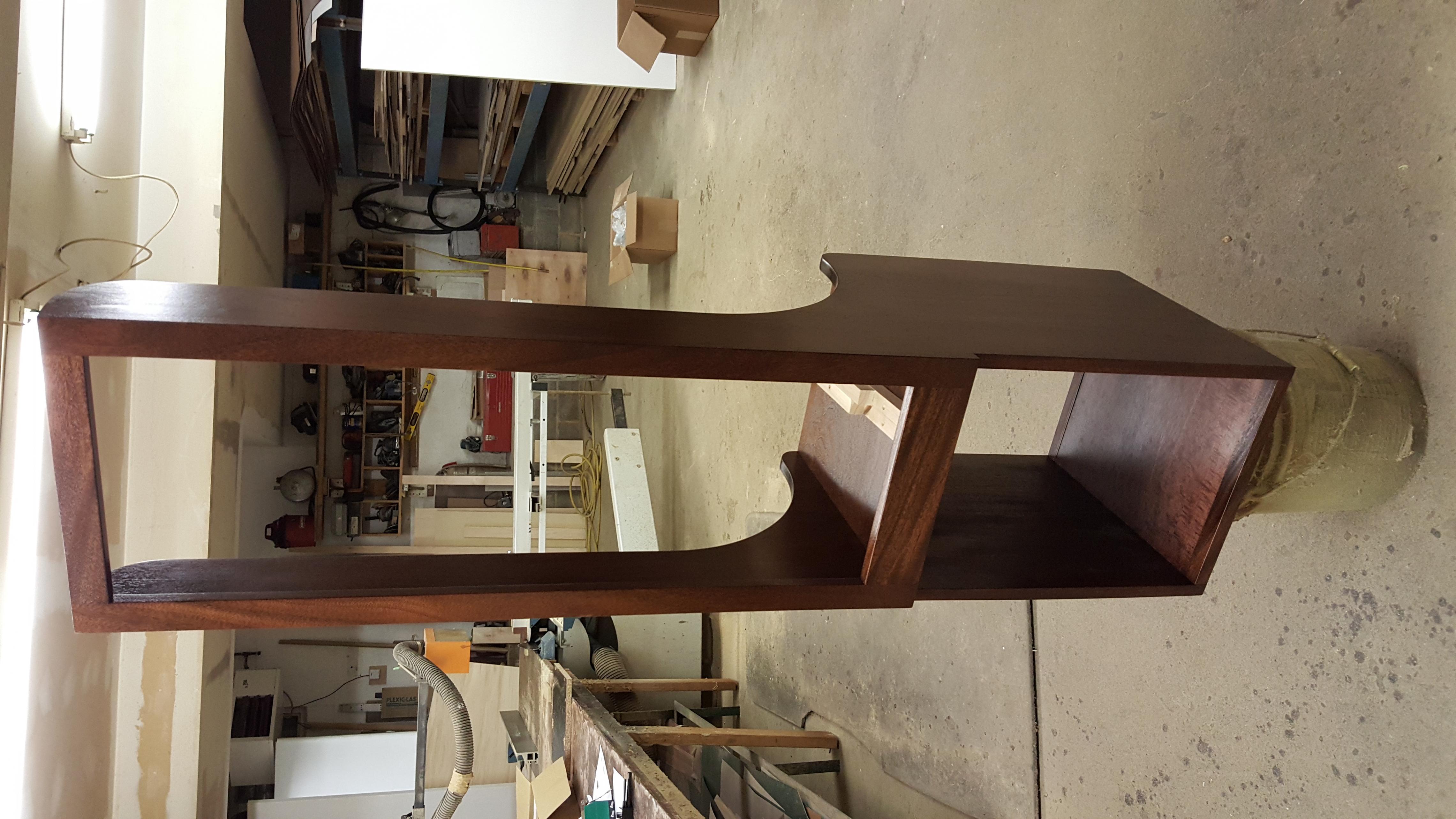

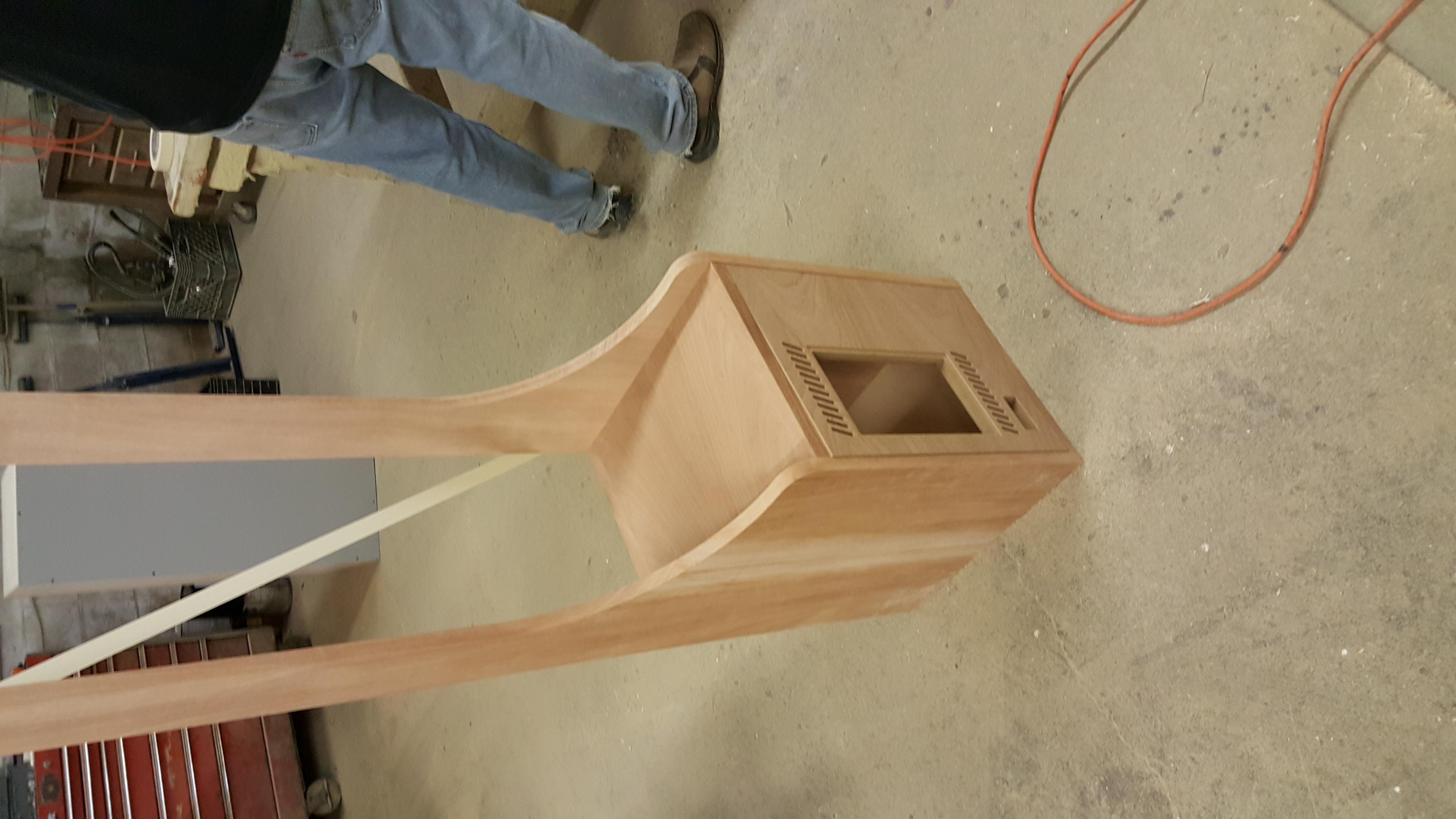

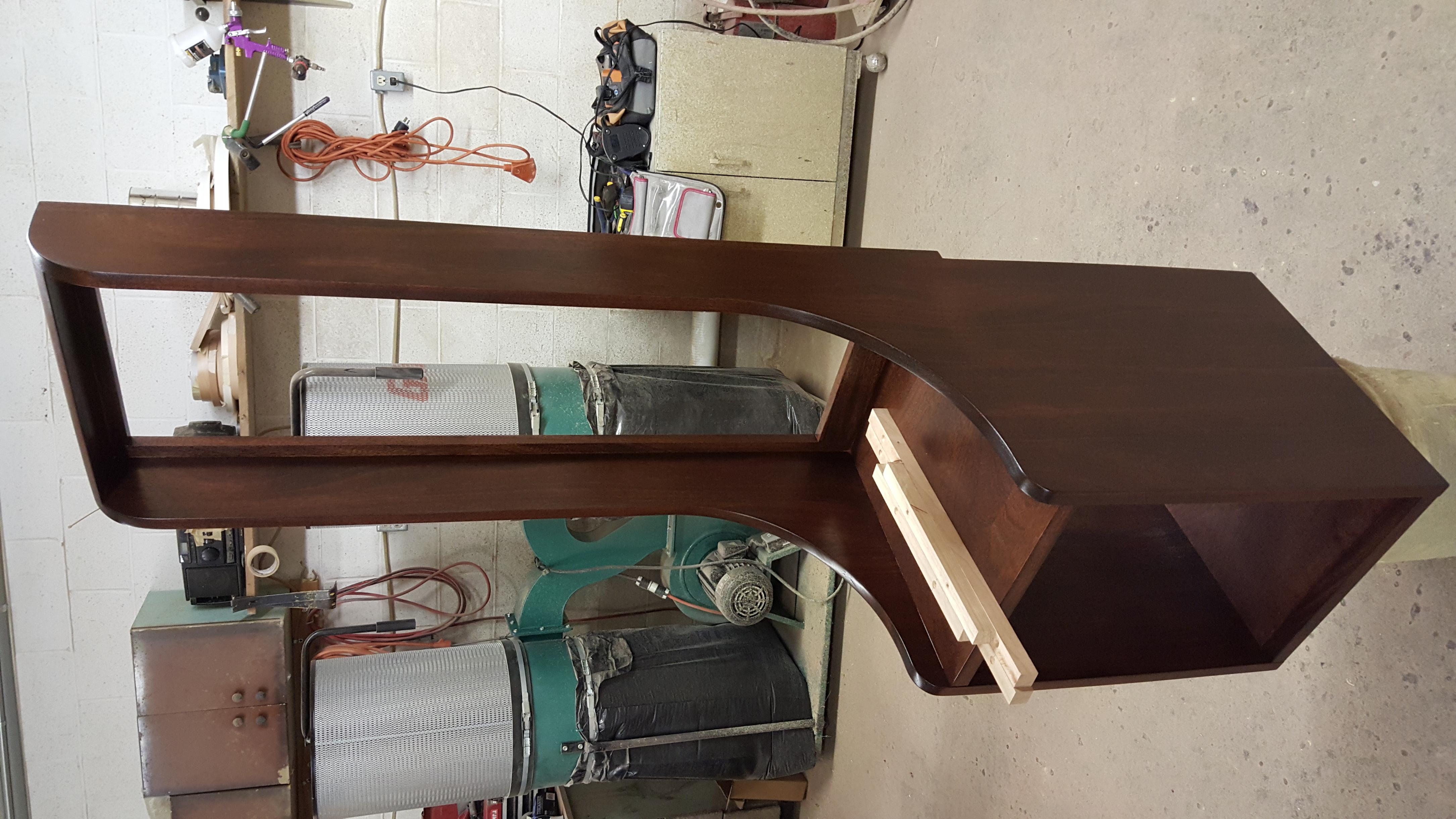

It has been a while since I've posted an update. I have been very busy with work and progress has been slow.

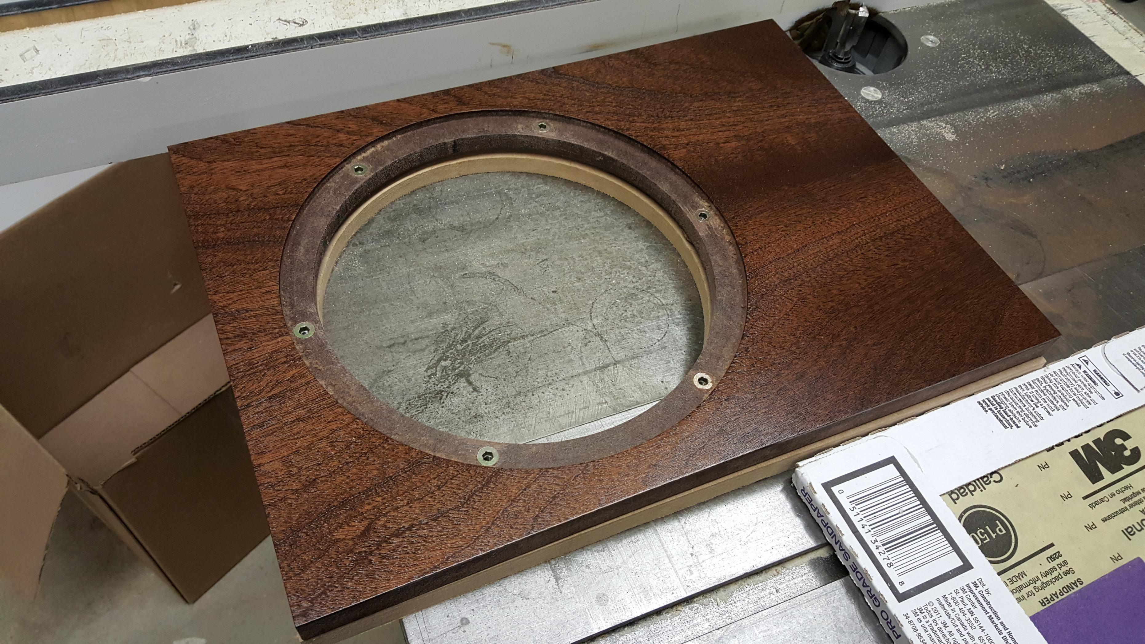

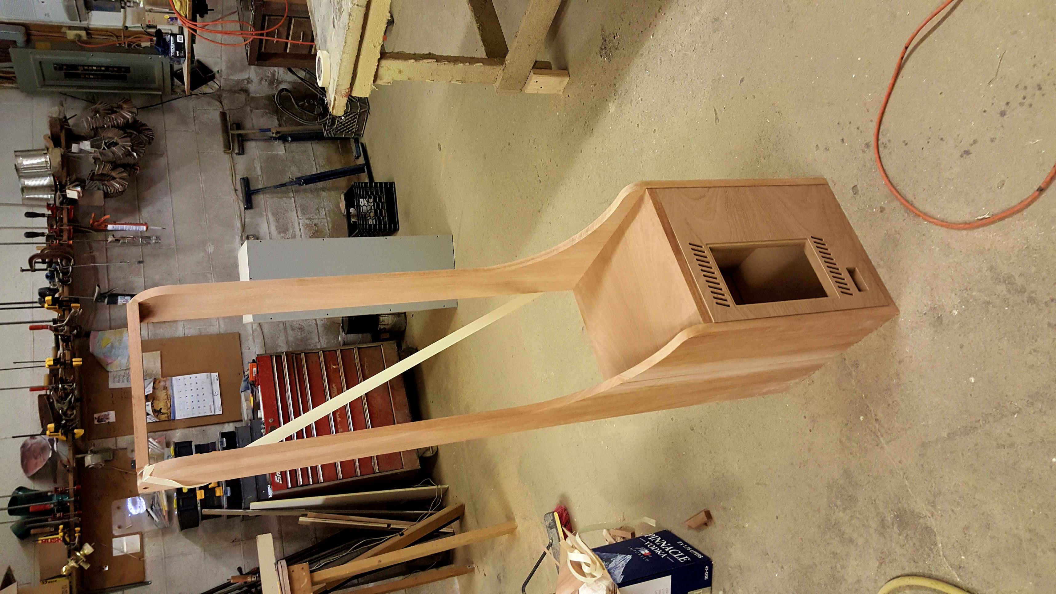

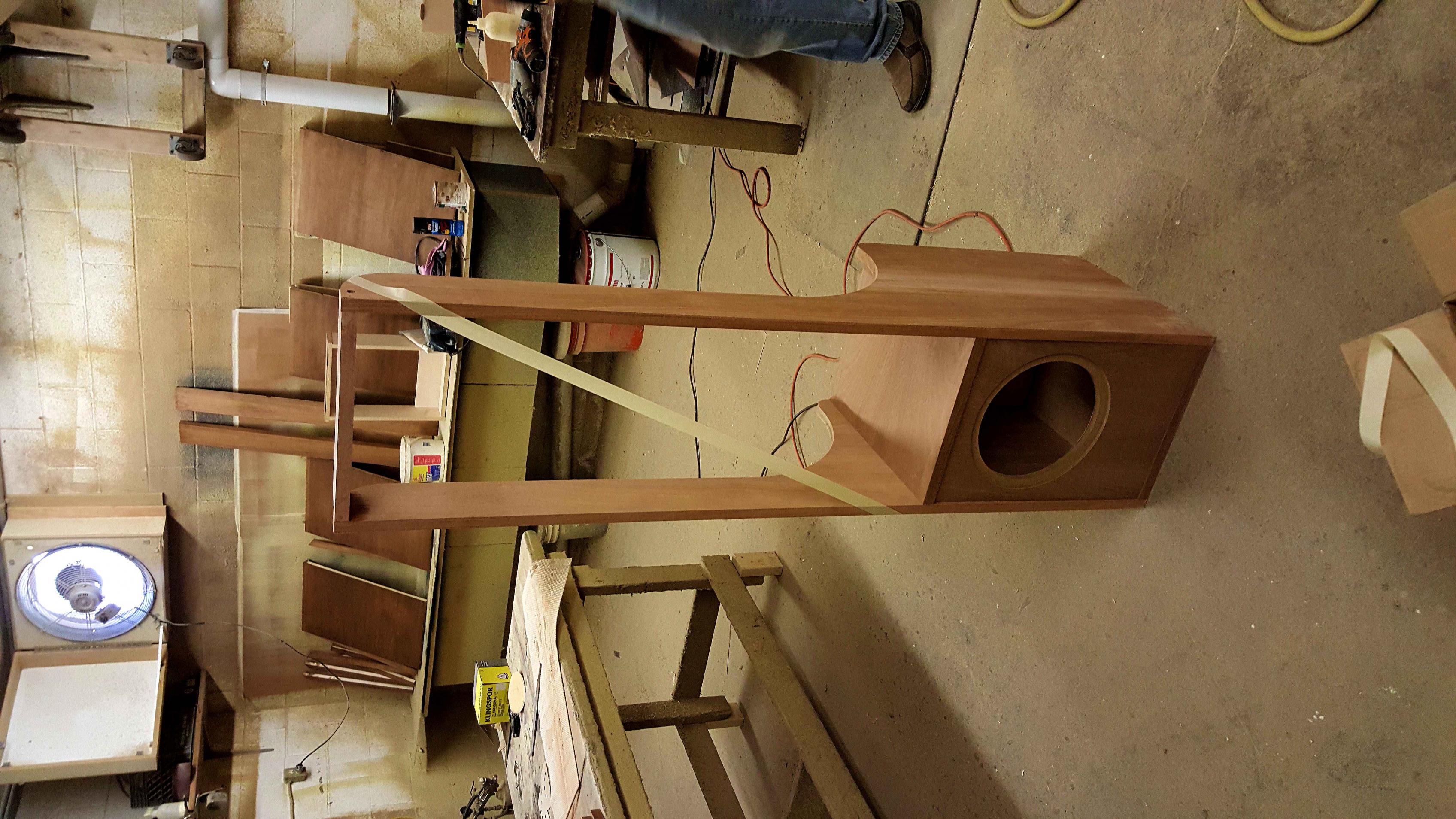

I should have these done in the next few weeks, though. The cabinets are in work (pics attached). They are made of solid mahogany (the side pieces, lots of misc pieces) along with mahogany veneered MDF (the front baffle, rear panel).

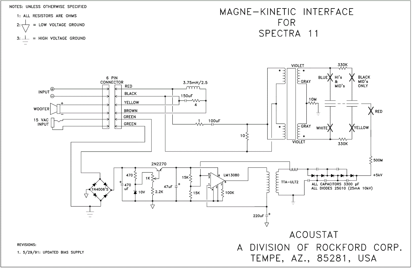

Now to widen the sweet spot - thinking of tying the front stators together, but per Bolsert's diagram, the back stators having a series 50k resistor on both sides...kinda remember this is the way the spectra series panels are set up...
It's been probably discussed a million times, but the series resistor added in the Spectra apply to only the Mid. The Mid / High panel are without resistor - how does adding the series resistance widen the Mid / High dispersion it it basically cuts out the Highs??
