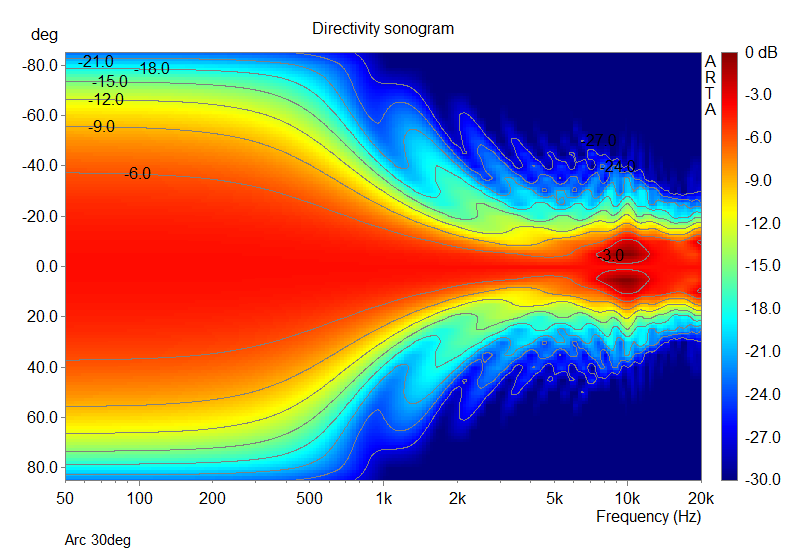

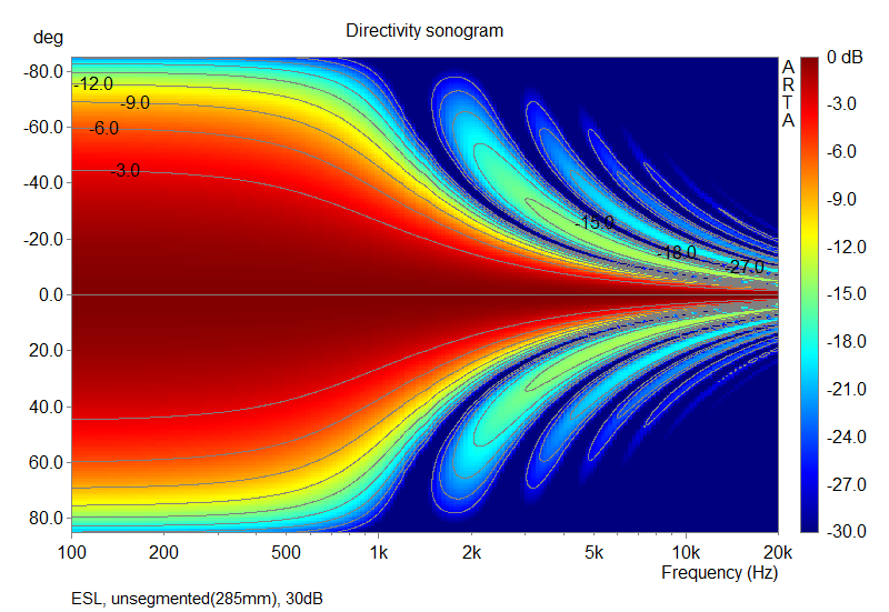

I would guess that the reason Audiostatic used large spacing between their wires was to simplify construction and minimise cost...and perhaps improve "see thru" optics.
The reason they can use the large spacing they do (without losing more sensitivity than common sense might suggest) is because, as you stated, the D/S spacing they use is large as well.

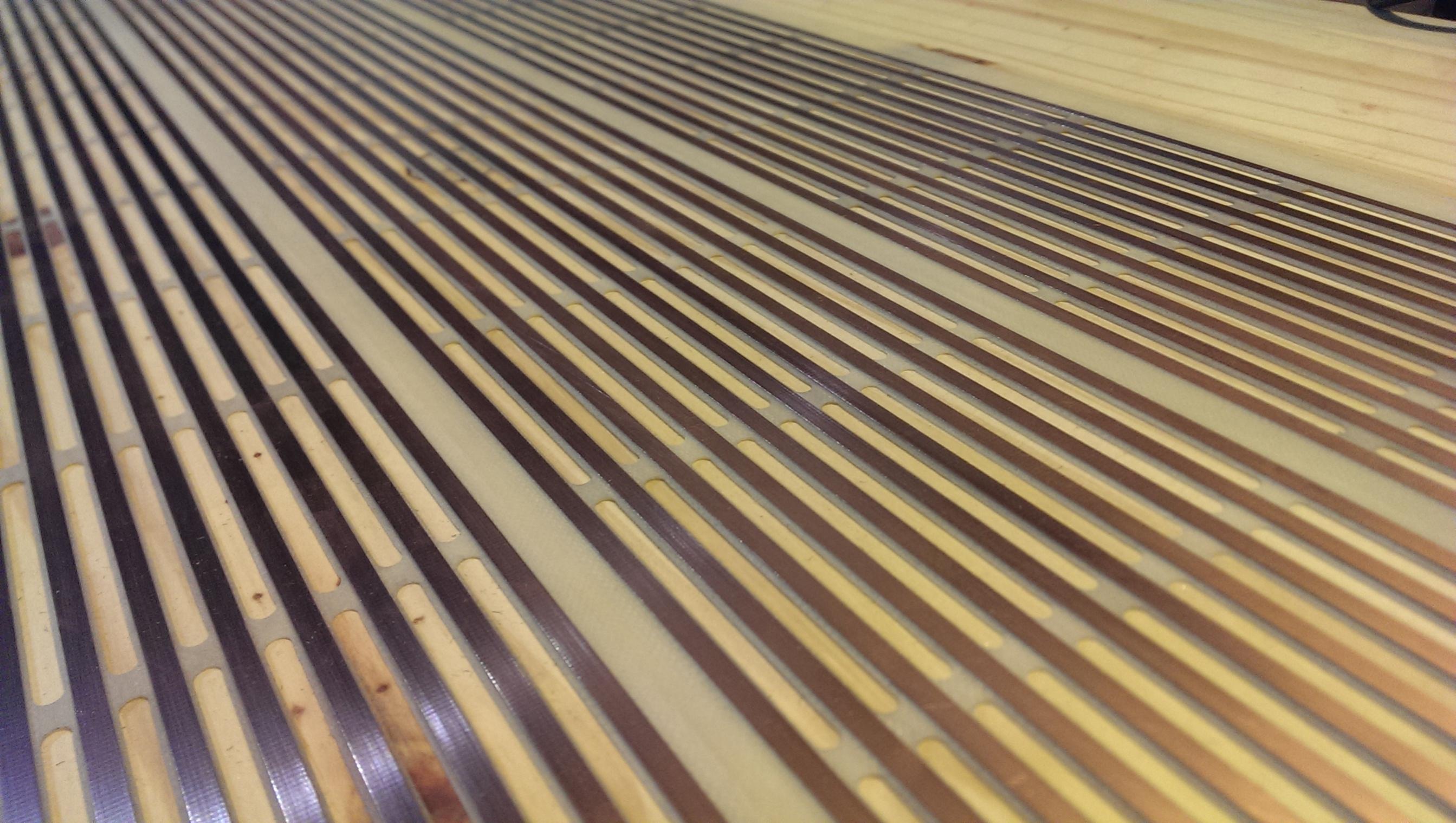

So I am getting closer to having fully hardened (or at least close) panels. Some testing showed that the panels were definitely not fully cured when they were first tested with HV. Anyways, I have a fan constantly blowing on them and it seems to have sped up process quite a bit. It seems that my garage has terrible air circulation which slowed the curing process to a halt.
Hopefully this weekend I'll be ready for some more testing.

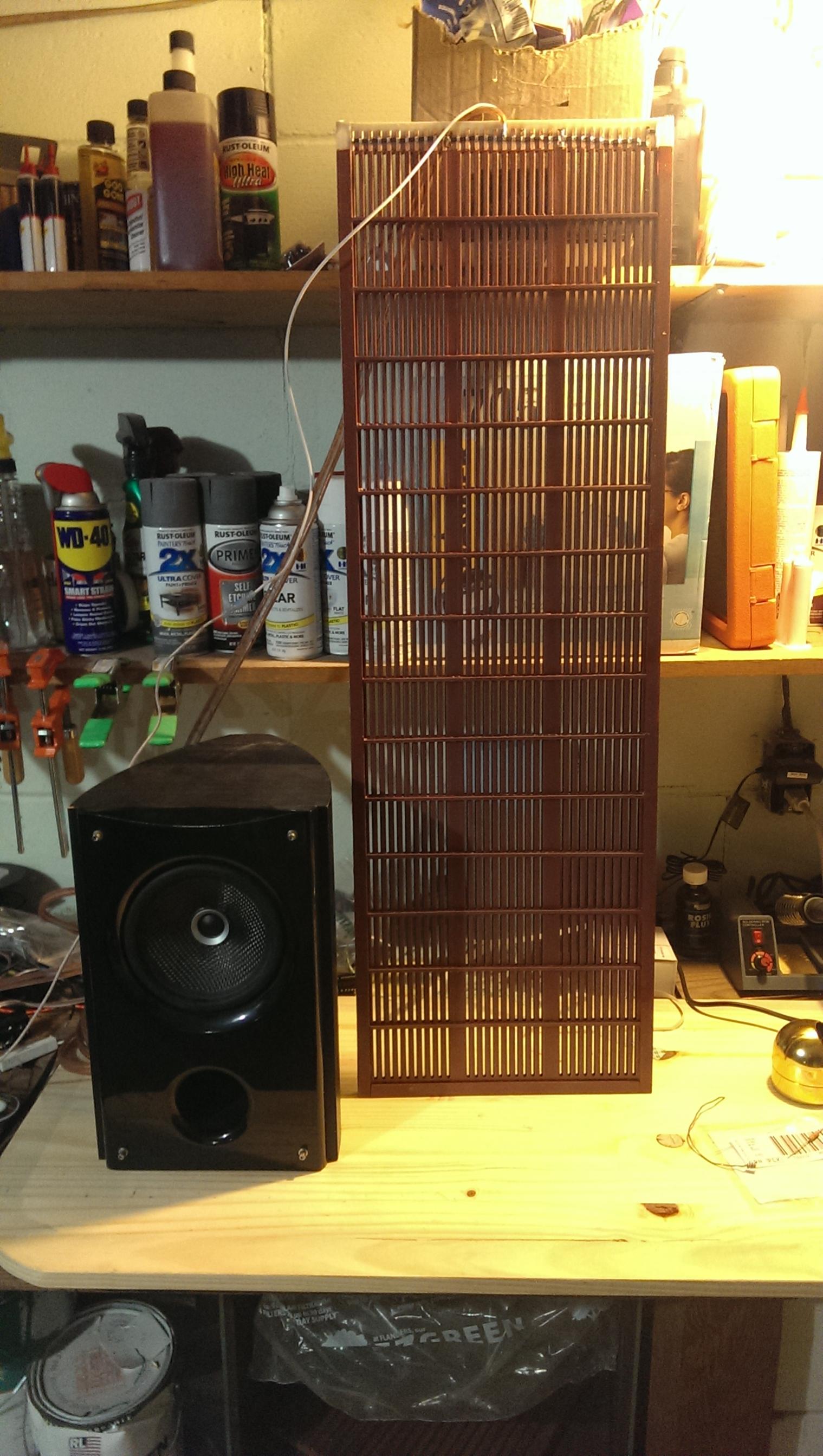

So I haven't been on here for a while. I ended up altering my machining and coating sequence and then made a small panel (about 4x12 inches) to test. It worked great so I went ahead and machined new 11x35 inch stators.
I have one speaker panel fully finished and it has tested very well. I was able to max out my spare small amp with no issues. Next I'll put it through its paces with a big boy amp (QSC RMX 2450). If it fares like the smaller panel I'll be good to go for finishing the other panel and building cabinets.

I am using it from 200 or 250 Hz and up.
I have driven it lower but not with much power. I will try to do that with the bigger amp.
After it had some time for the diaphragm to charge I was able to drive them very loud. I was still limited though as I don't have a proper woofer to handle the low end.
I have yet to make some good FR measurements but just using some crude SPL measurements it seems that the panel is performing on-par with its simulated expectations (I used resistor values from Post 88).

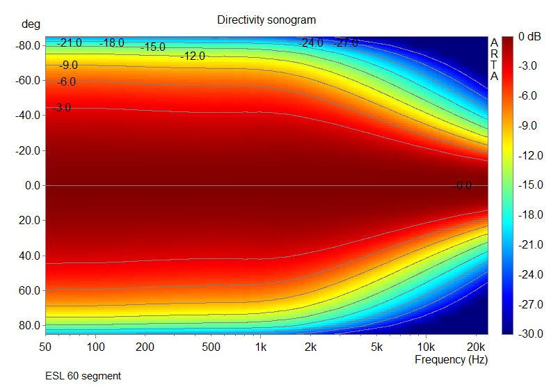

EDIT: I am using a bit of a different segmentation than post 88. I have 33 total segments, with 20k before the first and 220k between each one after. The off-axis response is ridiculous. It's better than just about any speaker that I've heard.

Actually I got a nearly perfect edge by machining the copper. The key was to use the proper tools and feed rates (I will post some pics of freshly machined stators). I have the copper machined back away from the slot edges by 1/32 inch. So I then coated the copper side with flat red primer (thick enough to round off all edges). I then added a few coats of matte clear Rustoleum 2x.
Using the big amp (rated at about 1200 watts into 2 ohms) I was able to drive my small test panel (unsegmented) to max amplification with no distortion or issues above 450 HZ. I'm getting similar results with these large segmented panels but down to 250-300hz.
Btw, all of these tests so far have been made with dual 230/6 VTX toroids.

… The off-axis response is ridiculous. It's better than just about any speaker that I've heard.
Indeed, symmetrically segmented flat ESLs can produce dispersion patterns that best most any other ESL(or dynamic loudspeaker for that matter) in broad uniform coverage, and directivity that trends smoothly with frequency. It has been fun exposing people only familiar with flat un-segmented panels(attachment #1), 30 deg arc curved panels(attachment #2), to the smooth/broad coverage of properly segmented flat ESLs(attachment #3). Often they simply don’t believe what they are hearing based on the big flat panels their eyes are seeing. They have to get out of the listening chair and walk up to the panels to check things out, and then wander back and forth across the listening area.
As promised, pics of a freshly machined stator. They are practically ready to coat immediately after machining.
After machining I removed a few burrs (each stator had a few) and then cleaned them up further with steel wool. After that I cleaned them with compressed air and started coating.
With Jer's advice and my own experience (painstaking, unfortunately) I coated each stator heavily with Rustoleum Flat Red primer. I then added acrylic ribs for strength with epoxy. Then I added some a few more coats of primer. Finally I topped it off with a few coats of Rustoleum 2x Matte Clear.
BTW, experience really payed off when machining these stators. Previous attempts required much deburring and sanding, etc. These panels required almost no prep work for coating.
The key was to use a Diamond-cut bit for the slots and a PCD coated end mill for removing the Cu. Also, to keep Cu burrs to a minimum, and to keep the slots clean (Garolite has a tendency to fray) and smooth I machined this with a very high feed rate, much higher than I was originally comfortable with.
