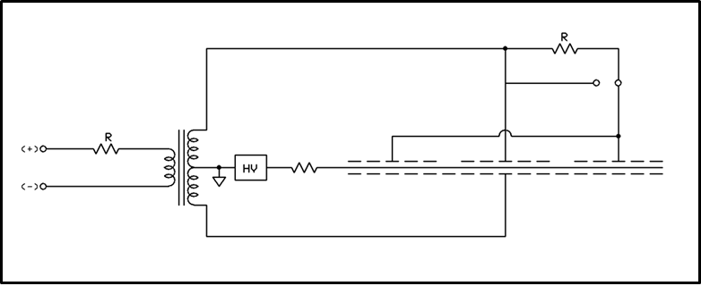

One option to "baby step" your way into segmented ESLs would be to modify your existing ESL by separating the rear stator into 3 separate electrical sections along the existing vertical foam tape dividers. Leave the front stator all one piece for holding the diaphragm tension.
This would minimize cost and let you use construction techniques you are comfortable with.
With the 3 stator sections you could create a symmetric 2 segment ESL as shown in the schematic.
The center segment would be driven straight from the transformer, and the outer two section connected together to form the second segment and driven thru a resistor.
You could easily revert to un-segmented if you bypassed the single segmentation resistor with a jumper.
The polar response will provide a wider sweet spot than you currently have and a much improved high-frequency balance to the sound when outside the sweet spot.

WOW!!! I had not imagined it possible to segment a perf metal panel leaving one stator intact.
Actually, I'm intrigued by the thought of building segmented wire stators using .035 dia copper coated TIG rods glued to black plastic egg crate light diffusers and coated with clear polyurethane. These could replace the 1'x4' perf metal panels in my existing hybrid TL speakers.
My problem is that I don't yet grasp how the resistor ladders work or what widths are required to segment the wire groups to get balanced response.
I left my laptop at my GF's house last weekend (using my Ipad now) so I haven't yet downloaded the calculator, let alone figured it out. I will have my laptop back this weekend.
I'm pretty good with woodwork and mechanical stuff but I'm a total dummy with computer programs, math and electronics.

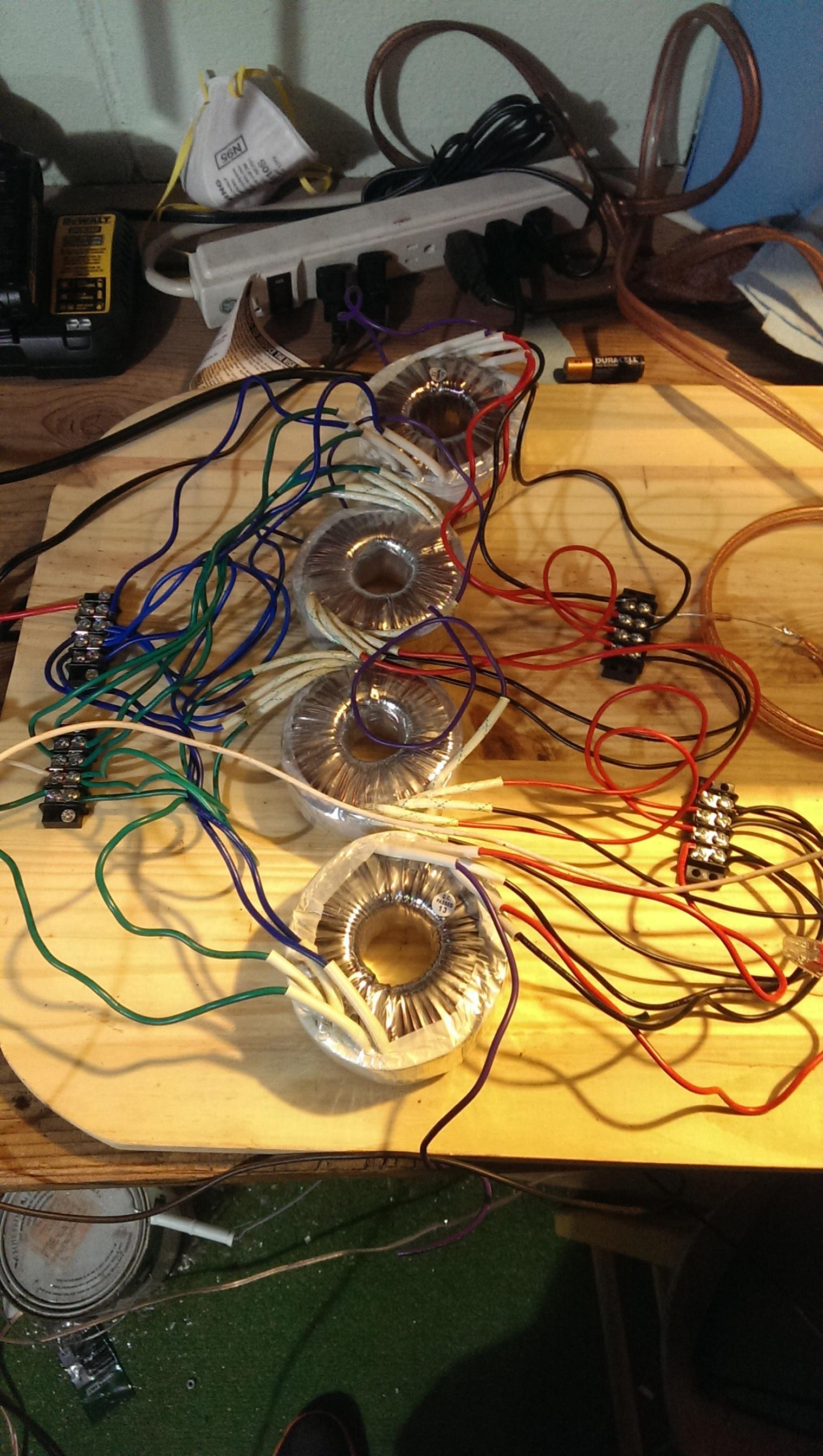

So while coating my second panel I have been testing the first one with different transformer configurations (VTX and Anteks, various step-up ratios).
It seems that the best results so far are using 4x VTX 230/6 or 4x Antek 115/6 for a total step-up ratio of 1:150. My small amp delivers up to 30Vrms and with that I had no issues beyond amp clipping.

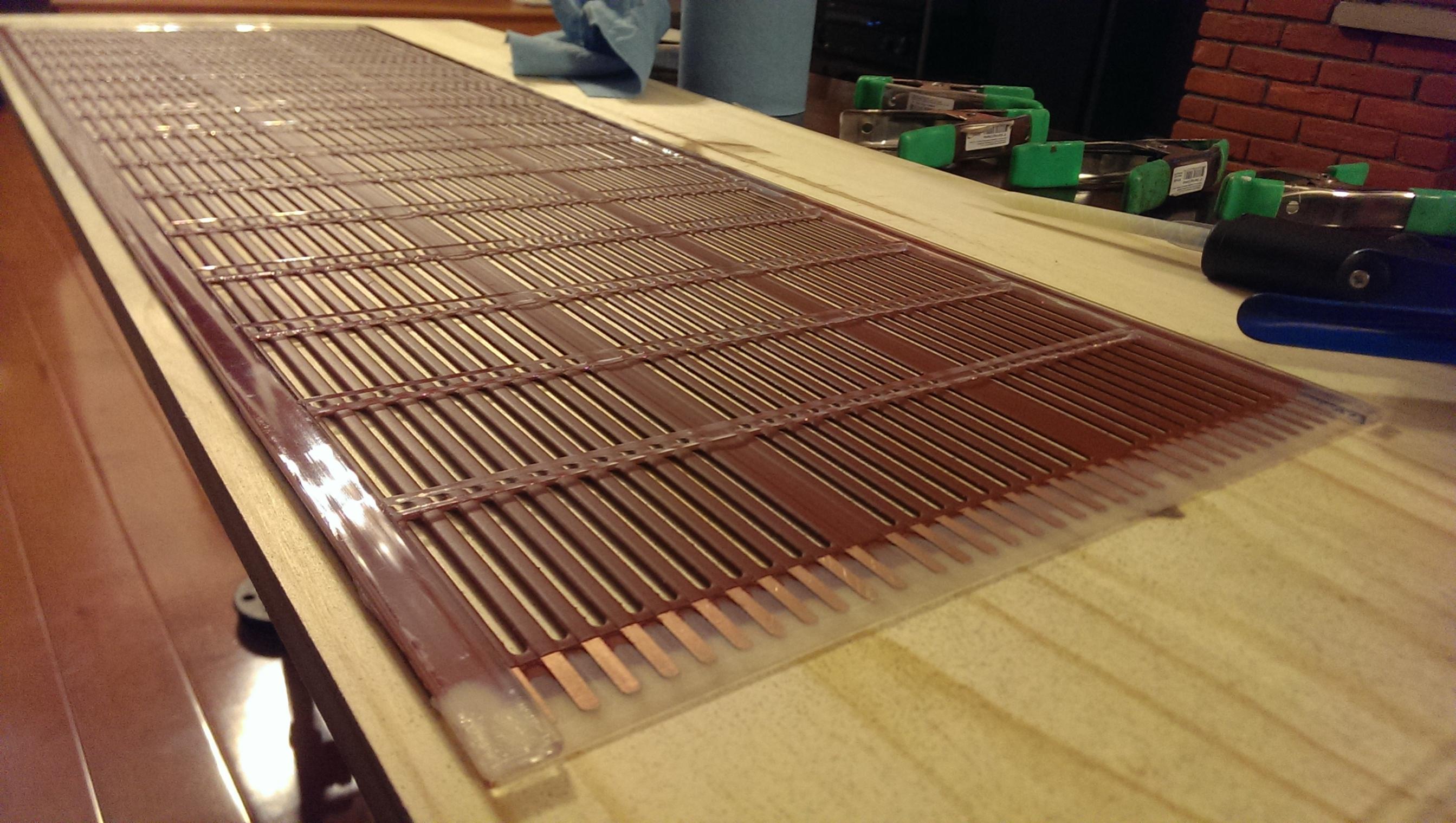

Just finished adding acrylic ribs/stiffeners to the stators for my 2nd panel. A few more coats of red primer and then matte clear will finish them.
I suggest to test insulating capabilities of your coating layer before gluing mylar. Place a sheet of aluminium foil over the stator, then make sure there are no spaces between foil and it. Connect an EHT supply with several thousands volts across. If there are any arcing spots your insulating layer will need improvement. Better to do this now than later.
Cheers
Lukas.
No, the acrylic ribs are for structural purposes only. I am using VHB tape as my spacers.
And yes, just as with my working panel, I will test with foil and HV before using it.
I am currently adding the last coats of red primer. After that comes matte clear coat. Then will test with foil before adding the segment resistors to the exposed bottom of the panel.

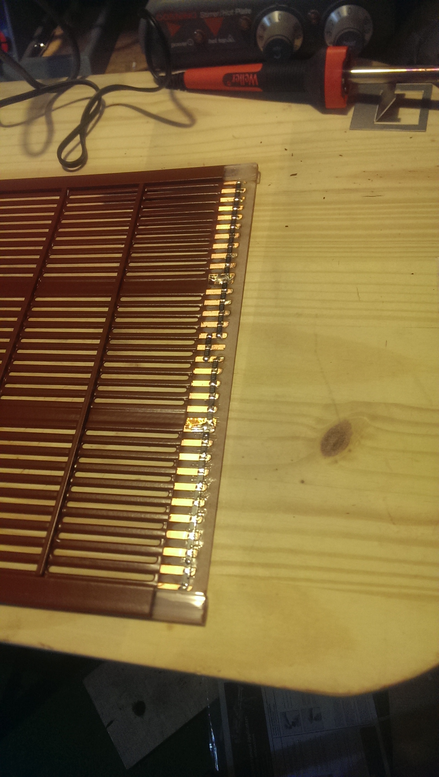

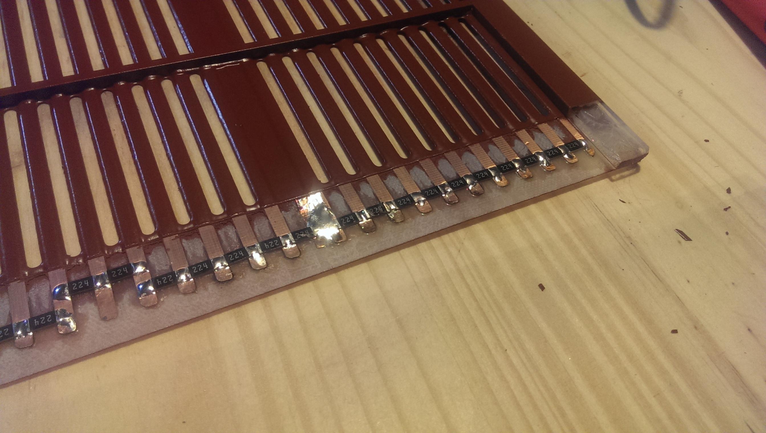

So the panels arc tested just fine so now I'm on to soldering the segment resistors.
Very nice looking stators there. Congrats on successful arc test :up:
Looks like you increased the number of segments in your panels to 33(17 electrical) from the 21(11 electrical) you used in your first stators shown in post #55
http://www.diyaudio.com/forums/planars-exotics/246846-first-time-esl-builder-6.html#post3757543
I don't recall you mentioning a particular reason for this change. Was there one?
