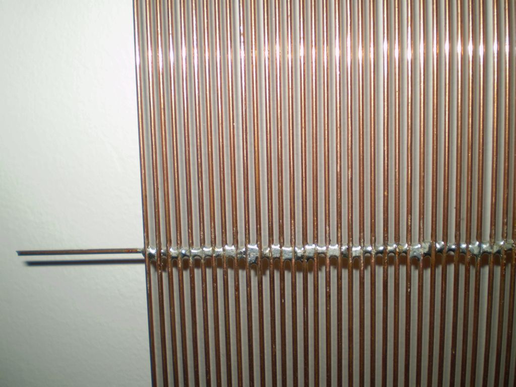

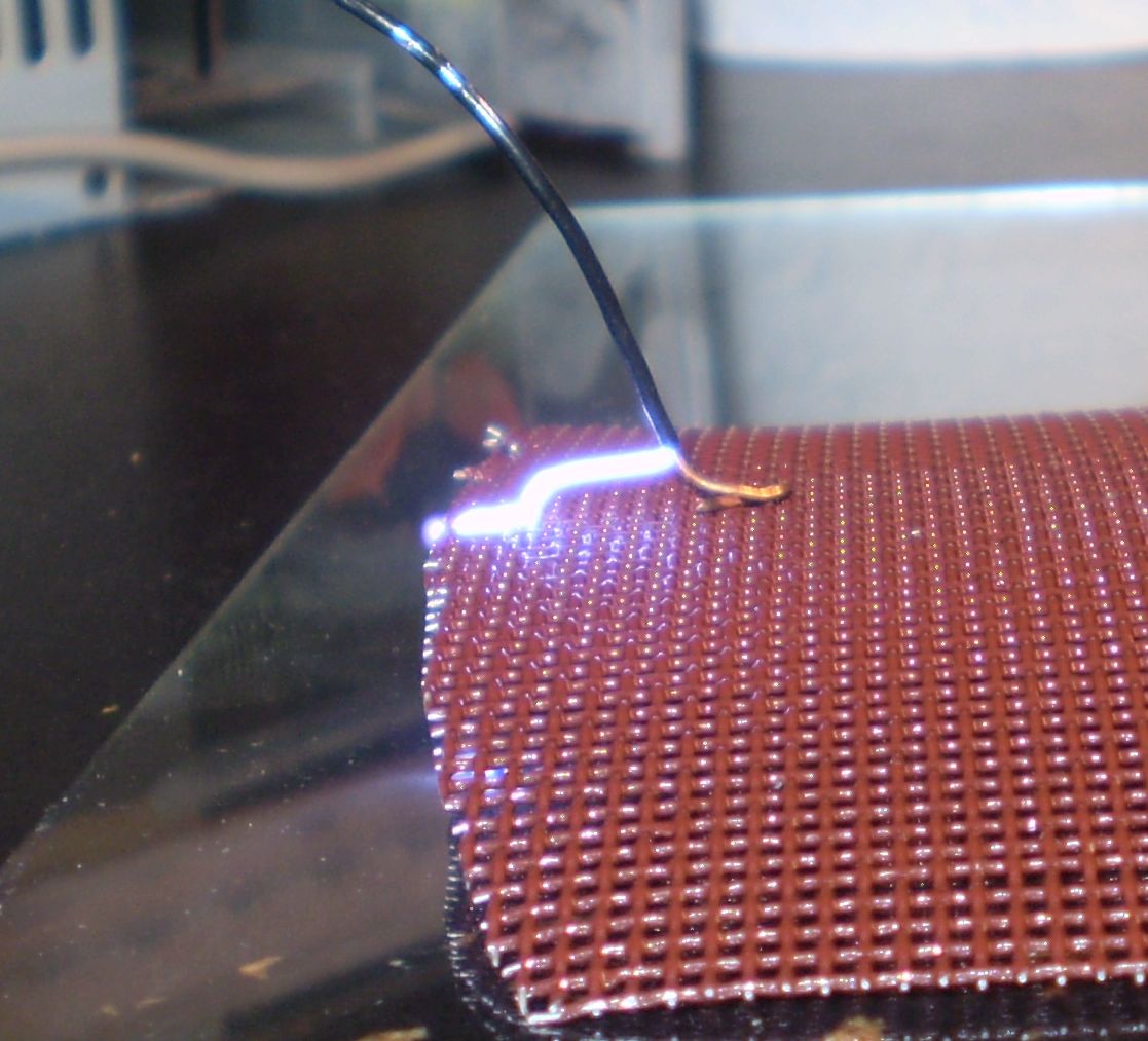

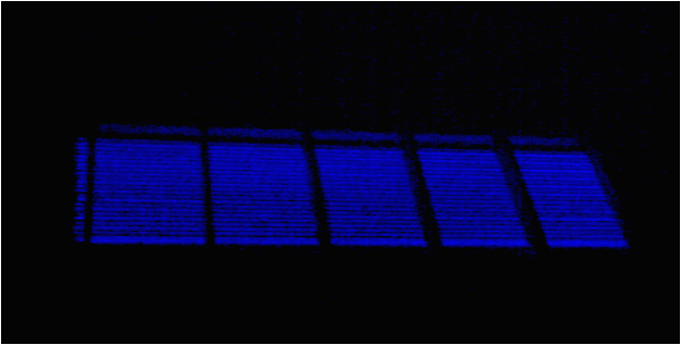

Attached is an example of corona discharge between my PVC wire stators. Breakdown occurred at around 3.6kV/mm field strength with a 300Hz signal, just a little lower the the theoretical value for flat plates. The actual breakdown field strength will depend on how smooth your stators are. The more sharp edges there are, the lower the field strength attainable before breakdown. Be sure to include some 100Kohm current limiting resistors inline with the stators to limit the damage if arcing occurs instead of corona discharge.
Perhaps I can rig up some sort of temporary spacers that are easily removable for the testing that you have suggested. If not I'll just assemble with a diaphragm and see what happens.
I don't mind tearing them apart and rebuilding so long as the stators don't get damaged.

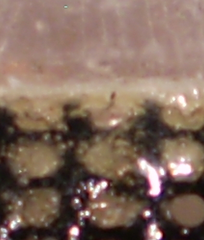

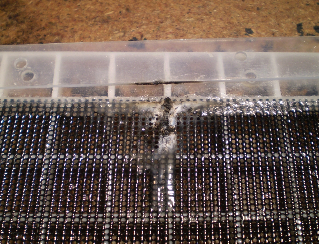

I certainly can attest to my share of arcing problems due to sharp edges !!!
These First two pictures show the area of my First panel that blew up.
It was caused by a sharp point of the wire mesh that was buried in silicone but not deep enough.
It arced around and across the Diaphragm frame on the inside to the outside sandwiching bolt.
The hole is now bigger than it was because of the burn't material that had to be remove due to the carbon that it left behind.
This is from the first panel that actually caught on fire when I had 20-25KVp-p across the stators.
After that I dug out all of the silicone and resealed all of the edges with some heavy acrylic nail polish with Teflon and re-sealed the stator's with a few heavy coats of clear spray acrylic.
The panel was saved and it is operational again.
However, I have never been able to reach the amount of driving voltages I was once using then, since.
It was very hard to reseal this spot once that it had failed the first time!
But I did finally get it to work okay.
In the First picture you see what looks like a wire sticking out, But, it is not a wire!
It is a tunnel of burn't material leading straight to the very sharp point that created the problems in the first place.
You can see this better in the second picture.
I had re-coated this area more times than what it was worth to finally get some use out of this panel !!!
It may have been sharper that I had expected it to be.

So, Do heed by what we are telling you,and save you a big headache and a waste of a good amount of effort, work and material.
Do something about the sharp edges!!

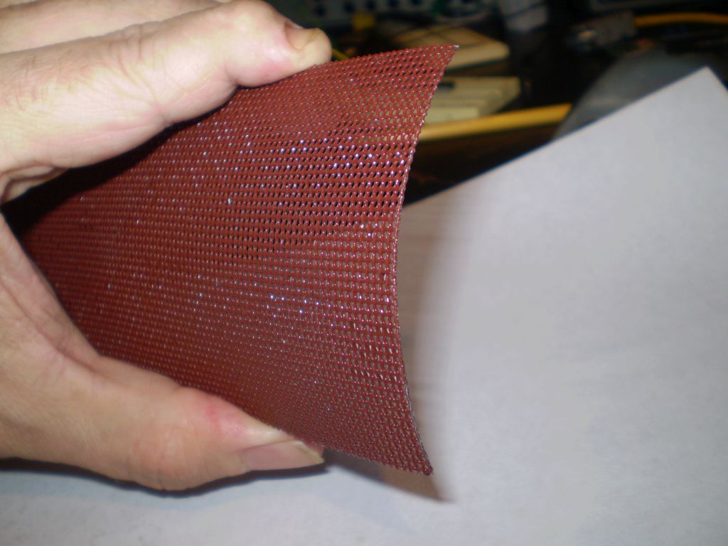

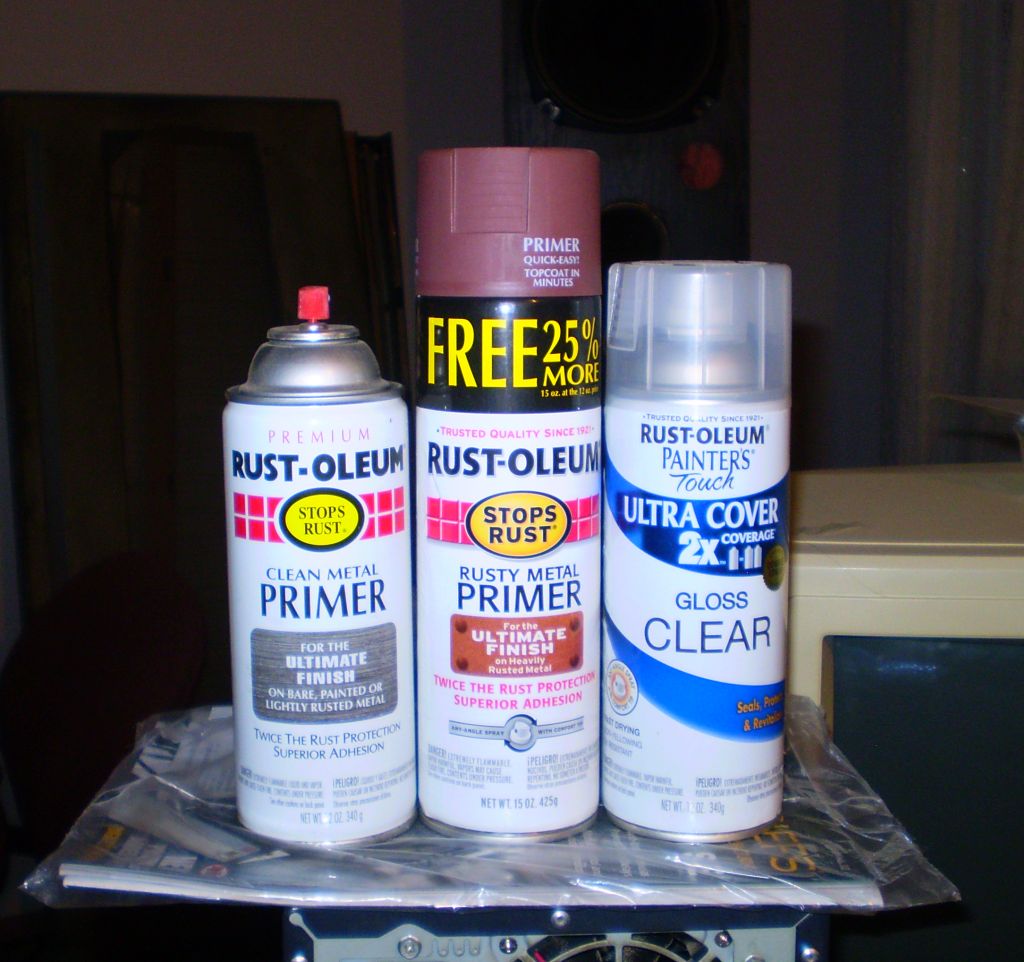

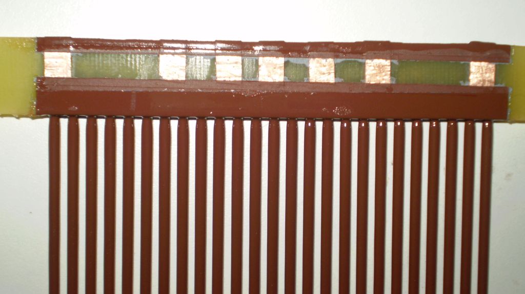

A small amount of etching will be your best bet and by far the easiest and cost effective way to round of those edges.
And put about 8 to 10 mil of clear acrylic on that side as well.
Red Primer works really good too because it is full of Talc then do a final coat of clear.

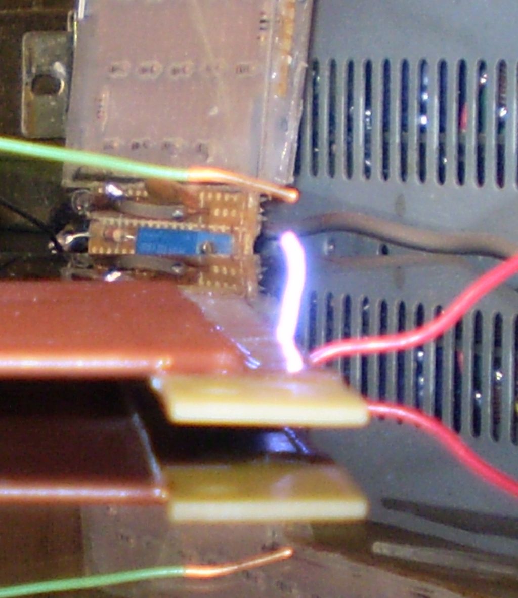

The forth picture shows an arc through test at 14KV and that thread can be found here,
http://www.diyaudio.com/forums/plan...tric-coatings-fact-fiction-2.html#post2893839

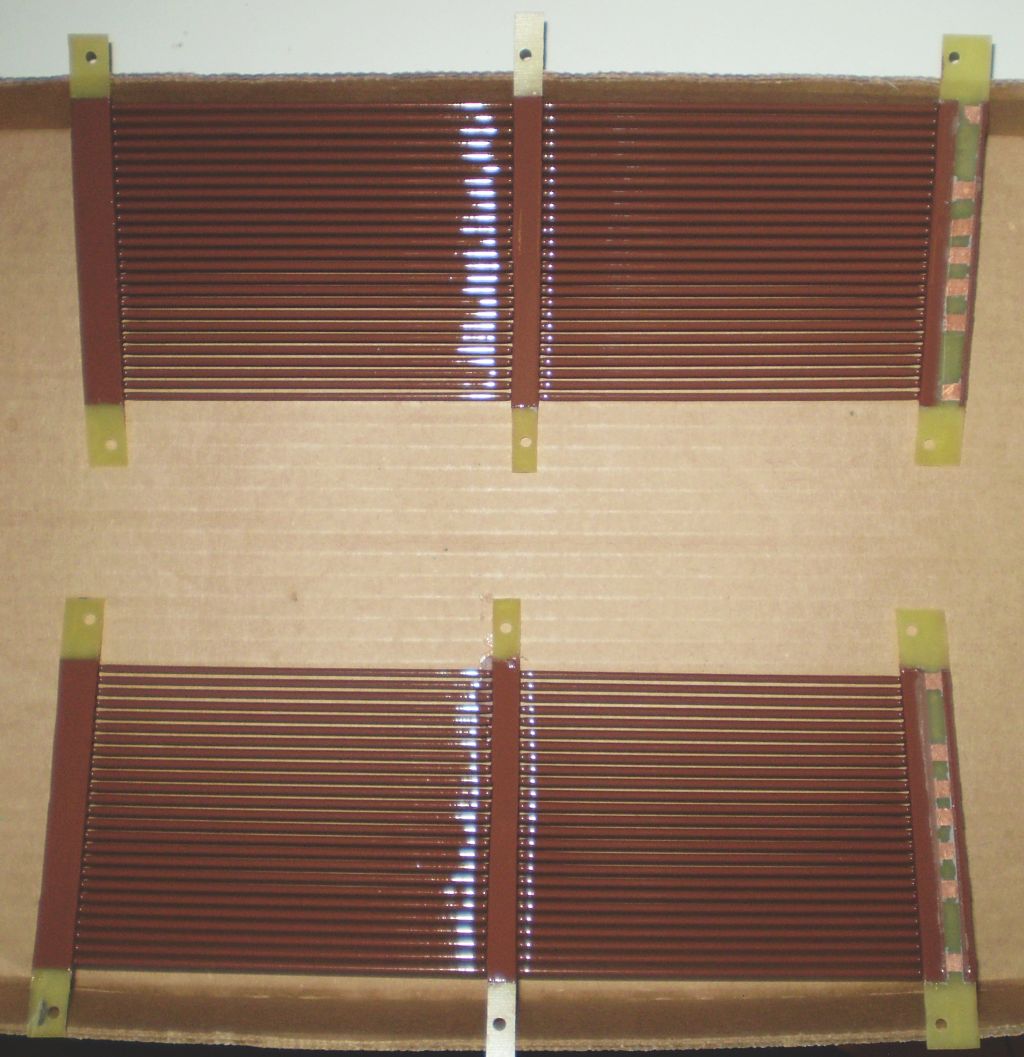

could use a tribo powder gun to insulate the copper and use it at the inside. still looking good, indeed some rough etches but well. glad you tried it before me 🙂 so just lvl the mdf would be enough nice to know, did not think it whas possible.

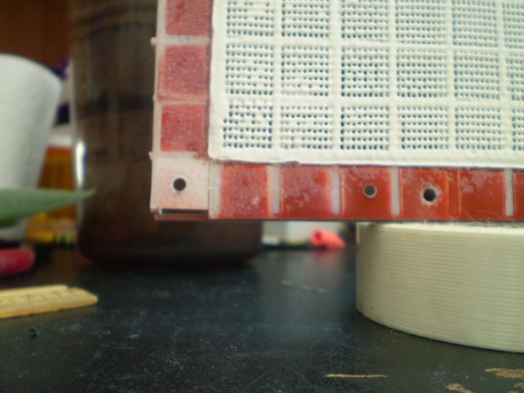

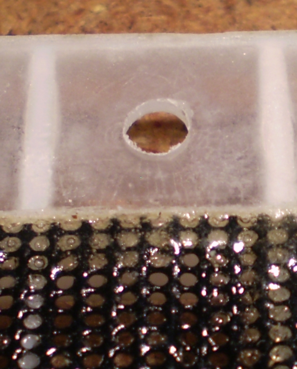

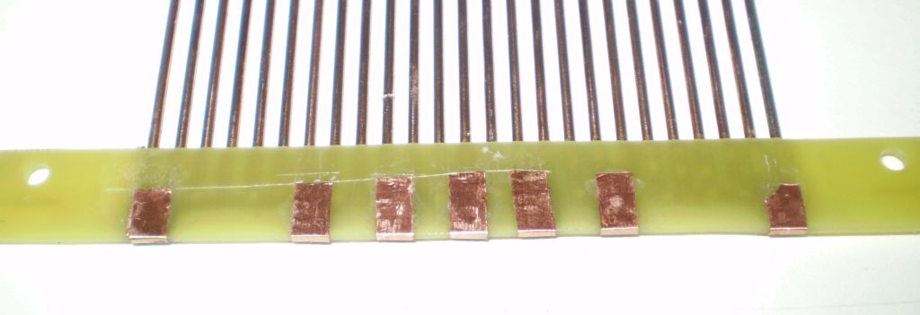

The edges are actually quite good in the areas cut with a sharp end mill. The programs too so long to run that I walked away from the CNC machine for hours at a time and during one of those times the bit clearly dulled and started cutting poorly. Had I been watching I could have changed it....
Once the MDF was machined I simply sprayed a very thin layer of glue on it and then rolled down the garolite. I set the Z-axis zero with electrical conductivity on the surface. After machining I used lacquer thinner to dissolve the glue and remove the garolite.

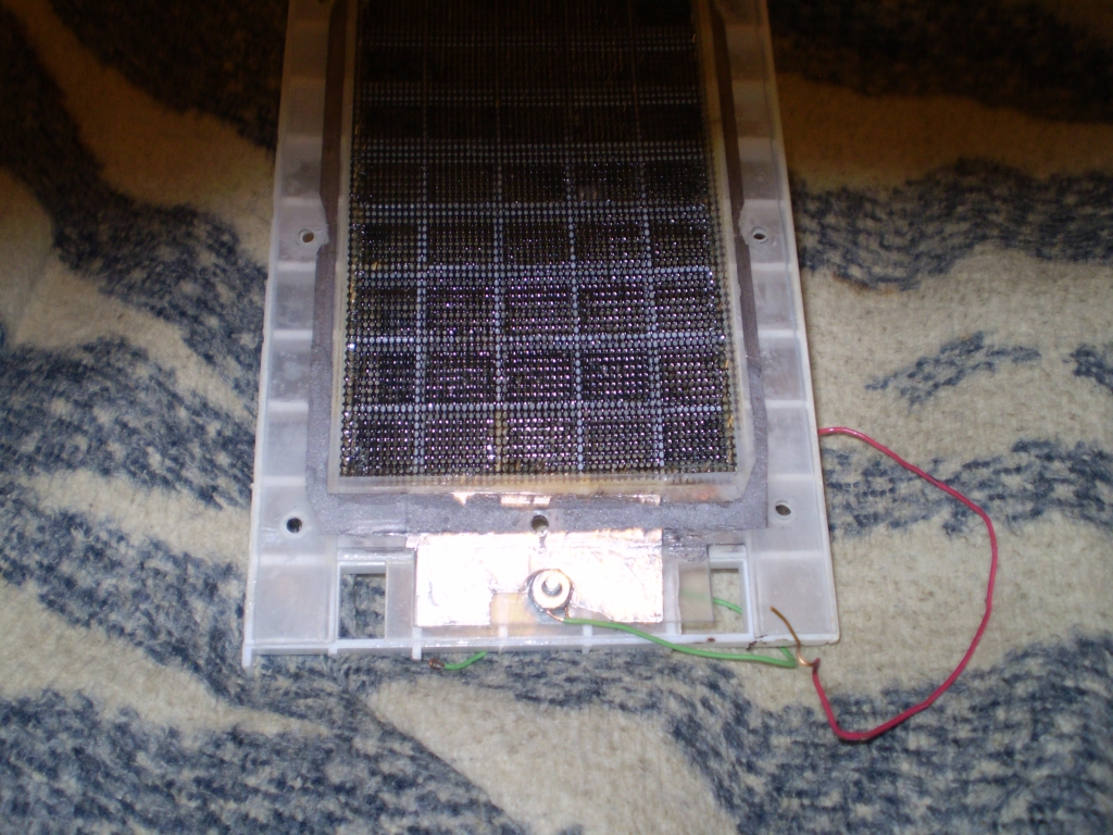

Regarding the sharp edges, is it a concern if they will not be part of the usable stator? For example, there will be no diaphragm between the stators there (they are below the bottom "edge" and exist only for purposes of soldering SMD resistors), and I can place some insulator in that space.
Nonetheless I still have some sharp edges at the top that I will definitely trim.

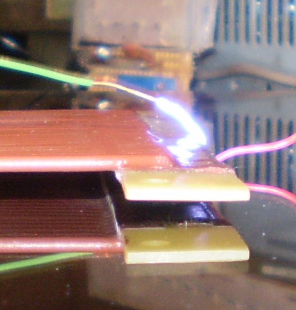

As long as you put on a good conformal coating as I had mentioned you should be okay.
In the last two photos you can see how the arc travels from the open connection on the underside to the ground wire, and not through it.
As mounted there is a barrier from the diaphragm frame overhang of about 1/4".
It does not flash over with this 14kv test as mounted even though there is a .050" air gap between the frame and the stator support.
I will fill this gap with some silicone once I get the diaphragm mounted and everything ready to go just to be sure.
But as it is in the last picture I get no flashover's with the 14kv connected across the stator's.

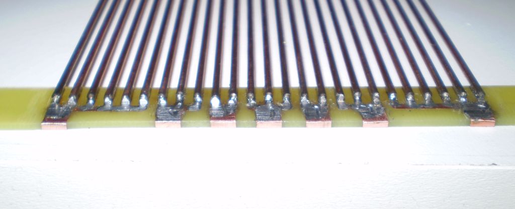

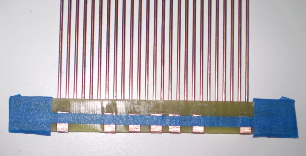

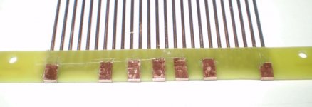

A Rare Shot Of The Arc Attracted to the Positive Ground wire.jpg127.5 KB · Views: 209

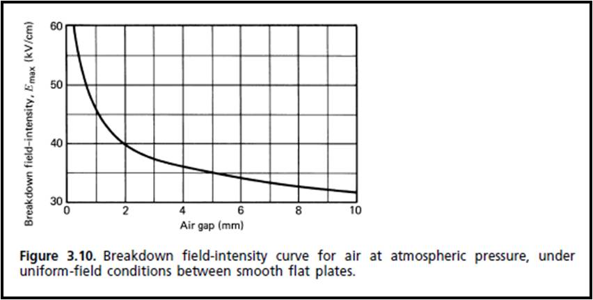

If one uses a thicker insulator one also requires a higher-epsilon material to keep all else equal (that is field strength in the airgap). If not, one requires higher drive voltages, which in itself is counter productive on all aspects.

certainly not. If not doped by a high-K material the insulating material´s epsilon value is <5.So it's more than likely higher output levels could be attainable with laminate facing inside and copper outwards.

Yes, Very Good Point Calvin !!
This is the reason that I have suggested to use Red Pimer as it is load with Talc !!!
This talc is a great insulator and also has a fairly high K factor (dielectric Constant) than just using clear spray acrylic alone.

THE Sharp edges at the bottom can be a problem still it won't arc to the membrane but to the other stator. But depending on the thickness of it PCB ofcourse and spacers.

The epsilon of air is ~1 vs ~4 for a typical FR4 PCB material. So air gap distance for sparking will be increased in a much larger proportion compared to what is lost due to laminate thickness(only ~1/4 of that). I can not see how could this reduce maximum output.

I do not know why you are so certain about this. There must be reasons why quad used this technique. ESL 57 bass stators which are constructed in somewhat similar way arc very rarely, despite turns ratio of ~1:300(!).
I assume drive voltage is chosen based on maximum capability of stators. In case of perforated metal sheets another limiting factor kicks in (large capacitance of entire panel working full range + dead capacitance spacers) but in this case it should be more efficient in this regard.
Lukas.

I'm starting to like the look of that red primer. I may have to clear it with the wife (after all, she did think that the copper clad pcb looks cool on its own) but I think I'm going to use it. Thanks for the suggestion.
I know what you mean, I love copper and I had debated that over and over myself.
I hated having to spray the red primer on my little ones but it was in the name of better performance.
But, My bigger ones I am not so sure yet, and, is the very reason I have not finished them yet!!
I'm pretty sure that they are going to just get some clear on them!! 😉
jer 🙂
jer 🙂
jer 🙂
So how thick do you recommend spraying on the red oxide primer? You mentioned something like 8 mils somewhere I think. Then a few coats of acrylic I suppose? I've been out of this for a while due to work, but I'm finishing up the acrylic reinforcement on the stators and soon I'll be ready to coat.
Yes. I used one coat of Etching type on the bare metal and then Two or Three coats of the Red primer.
At this point you can give them a thin color coat of choice if you wish.
This would get you to about 3 to 4 mils and then I finished them to the desired thickness of about 8 to 12 mil or so using 2X clear acrylic.
8 mil may be enough depending on how hard you plan on driving them and how much of a bias voltage you plan on using.
The coating as tested was good for as much as 1900v to 2100v per mil so I use 1500v per mil as a safe limit.
8 mil surpassed an arc through test of 13.8Kv with no breakdown.
I have even tested a 6-7 mil coating consisted of just the primer and it seemed to give the higher values (2100V per mil) than the clear did!!!
But I didn't do any more tests as making the samples was very time consuming.

Oh yes, You must coat both sides of the stator equally !!!!
Or else the arc will just travel around from the other side as in the photo!!
If you plan on being able to take them apart and then re-assemble them than you need use a different method to sandwich them together than using the tape method.
I use small bolts, all of my panels are designed to be taken apart and re-assembled over and over again.

In this post and the next one you can just barely see the traces after the coating has been applied.
Although it is quite a bit thicker on the support ends than it is on the rods.

My connection strips were some copper tape wrapped around the edge of the board to the other side.
The copper tape has a thickness of about 3-4 mil just to give you an idea as they show through the coating.
I suggest that you test the panels in a mock up setting First!
Use normal to extreme operating conditions using your purposed D/S spacing, Bias supply, Step-up transformer and Signal without a diaphragm, Before you assemble them.
As I have done in the First picture in my previous post.
