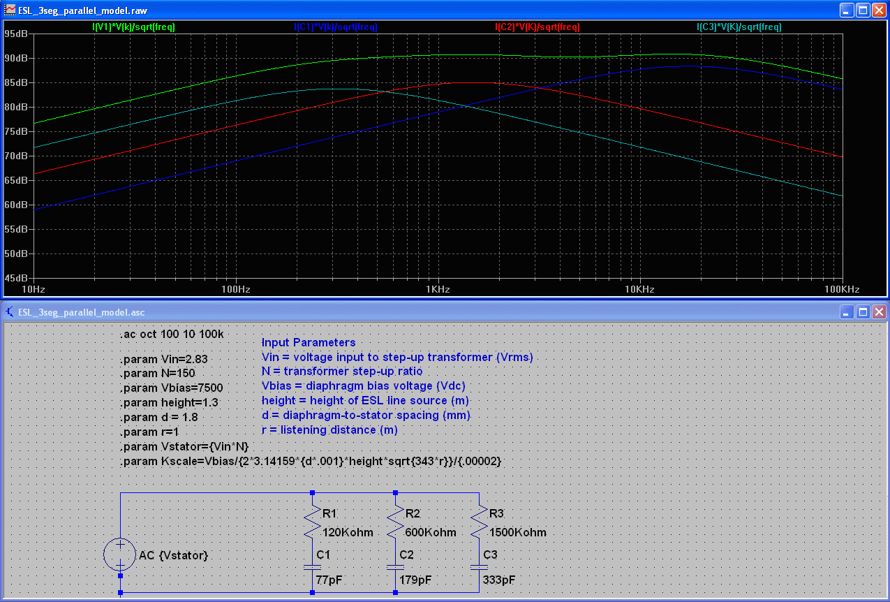

where does the factor 0.00002 in the param Kscale equation come from?
It is the reference pressure used to convert pressure in (N/m^2) to SPL(dB)
From the book "Acoustics" by Beranek, equation (1.18):
SPL(dB) = 20*LOG(P/Pref)
where:
P = sound pressure (N/m^2)
Pref = reference sound pressure = 0.00002 (N/m^2)
More details on using the Walker equations to get SPL on the "Notes" TAB of the spreadsheet posted here:
http://www.diyaudio.com/forums/planars-exotics/48120-experiences-esl-directivity-9.html#post2218526

1) How to change the model so parallel segmentation is possible? I have tried to edit the schematic but it seems to no longer work properly by just doing so. I guess it should be straight forward?
2) How to simulate off-axis response?

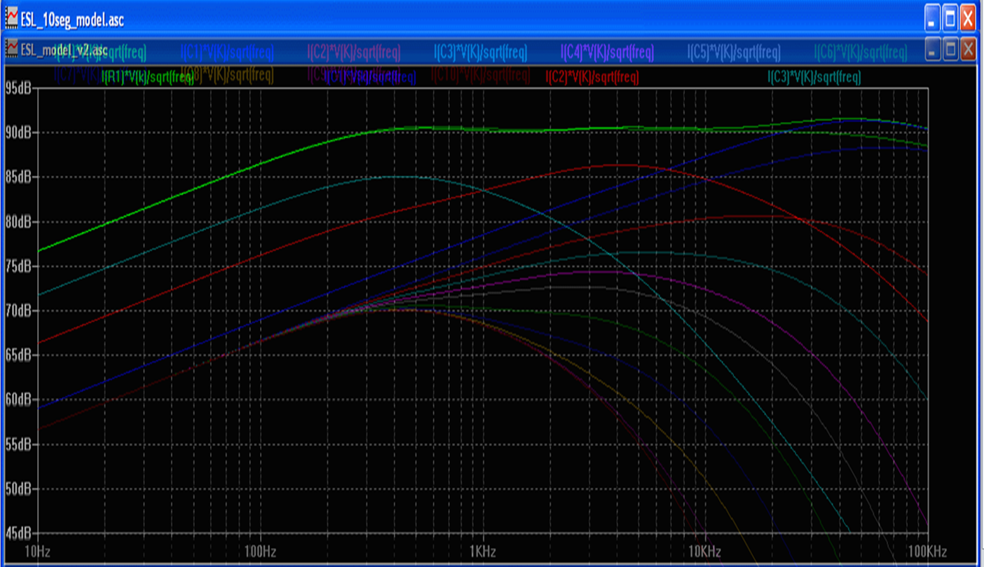

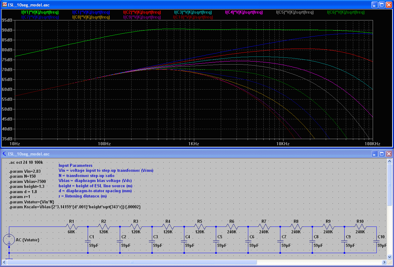

1) You can simulate any type of segmentation you would like with LTSpice just by changing the schematic and following the rules for plotting currents thru the segment capacitance. If after changing file names or the schematic the curves no longer show up on the response plot, you may need to add them. Just select current thru the segment of interest, then edit the curve data to multiply by "V(K)/sqrt(freq)".
Example LTSpice files and screen capture for a 3 segment parallel configuration attached.
Notice that the total current no longer flows thru R1. So, I needed to change the "total curve" to plot current thru the stator voltage source(V1)...which is probably what I should have used in the orginal 3-segment example.
Also, I had some off-line questions concerning use of equal sized segments for the same overall panel size as the 3-segment ladder configuration from post#39. I figured it might be useful to post files of a 10-segment(equal size) design for comparison with the 3-segment(increasing size). An overlay comparing 3 & 10 segment also included.
2) Off-axis response involves summing current from the segments with appropriate time delays for segment location on panel for a given off-axis angle. I haven't found an easy way to do this in LTSpice. However, my Excel spreadsheet includes it. I'm not sure what the interest level is....perhaps I will have time during the upcoming holiday to clean it up for posting.
As before, you need to remove the "*.txt" suffix on the LTSpice files before using.

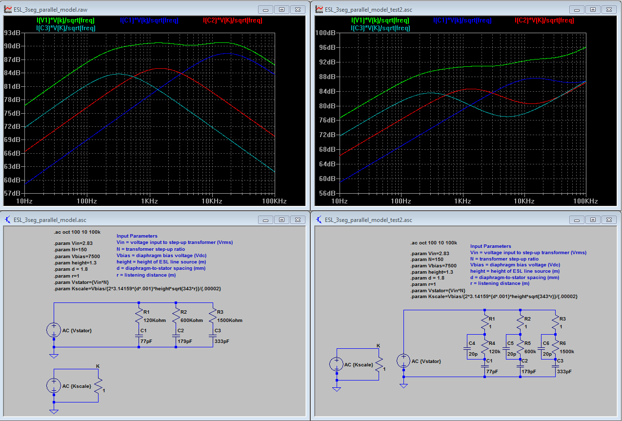

Thanks for updated spice models. I compared the result to ESL_Seg. As you said, LTSpice model does not include proximity effect and form of SPL curve don't change depending on distance(which is expected).
My interest behind using LTSpice is to make a more accurate model, i.e including effects of wire-wire capacitance and such. Perhaps I could write a more advanced program than ESL_Seg in c++ but understanding of math has faded away over the years 🙁 .
So back to the model. I have tried to model a parallel capacitance with resistors bypassed with some capacitance. Can I just model it this way?

By wire-to-wire capacitance, do you mean the small stray coupling capacitance between the adjacent segments?
If so, your model is incorrect as shown. Instead of the capacitors in parallel with the resistors there should be one capacitor between the top of C1 and C2, and another capacitor between the top of C2 & C3. I have measured values in the 20pF - 40pF range for capacitive coupling between PVC wire stator segments.
Just curious, why are you interested in using the parallel configuration rather than the ladder configuration? The ladder network does a much better job at removing HF content from the outer panel segments.
Yes you are right. What was I thinking while drawing the schematic? Perhaps girls

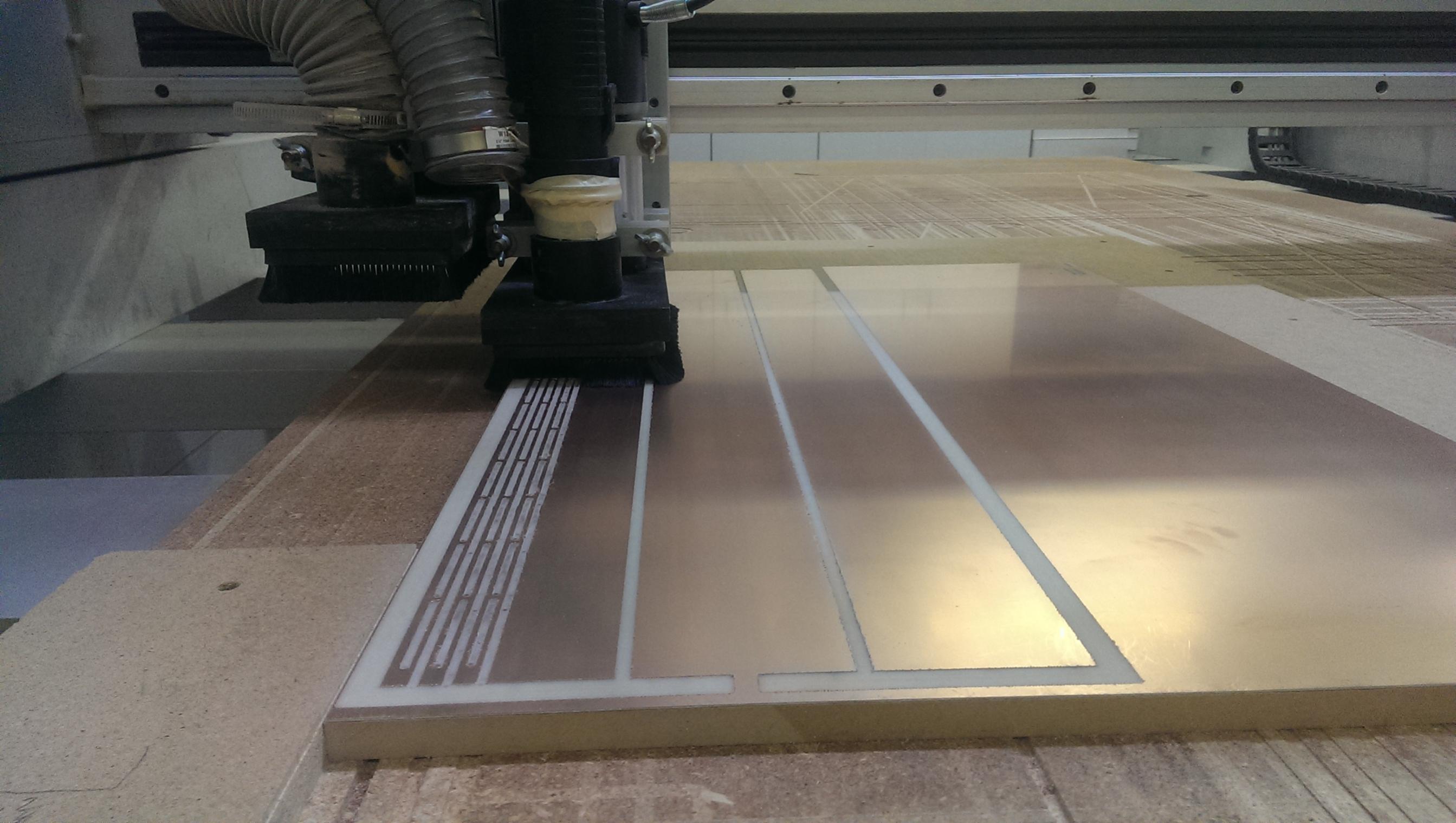

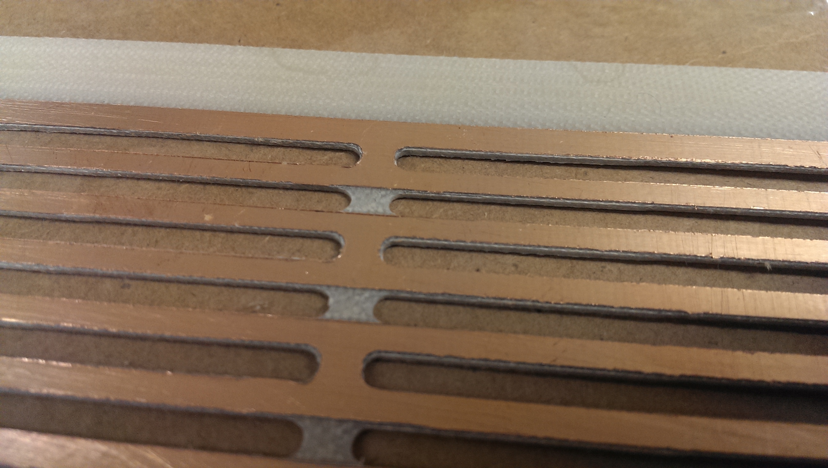

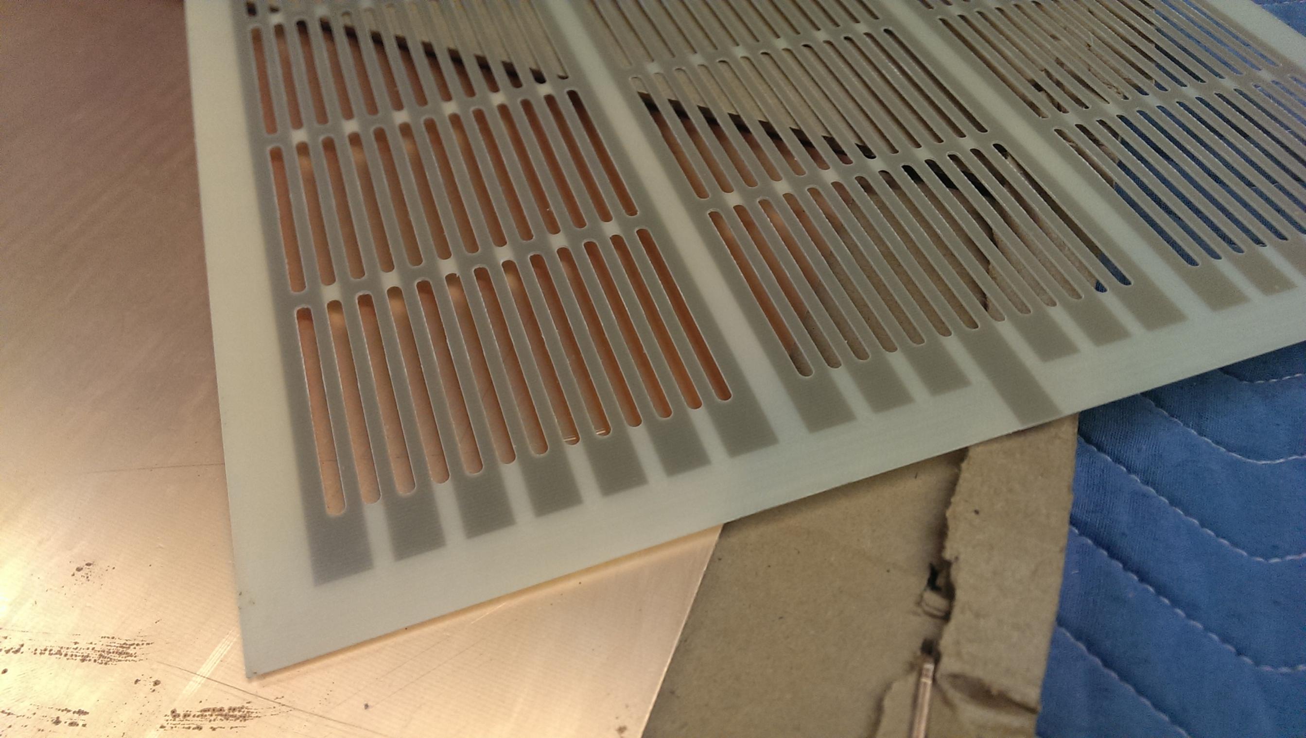

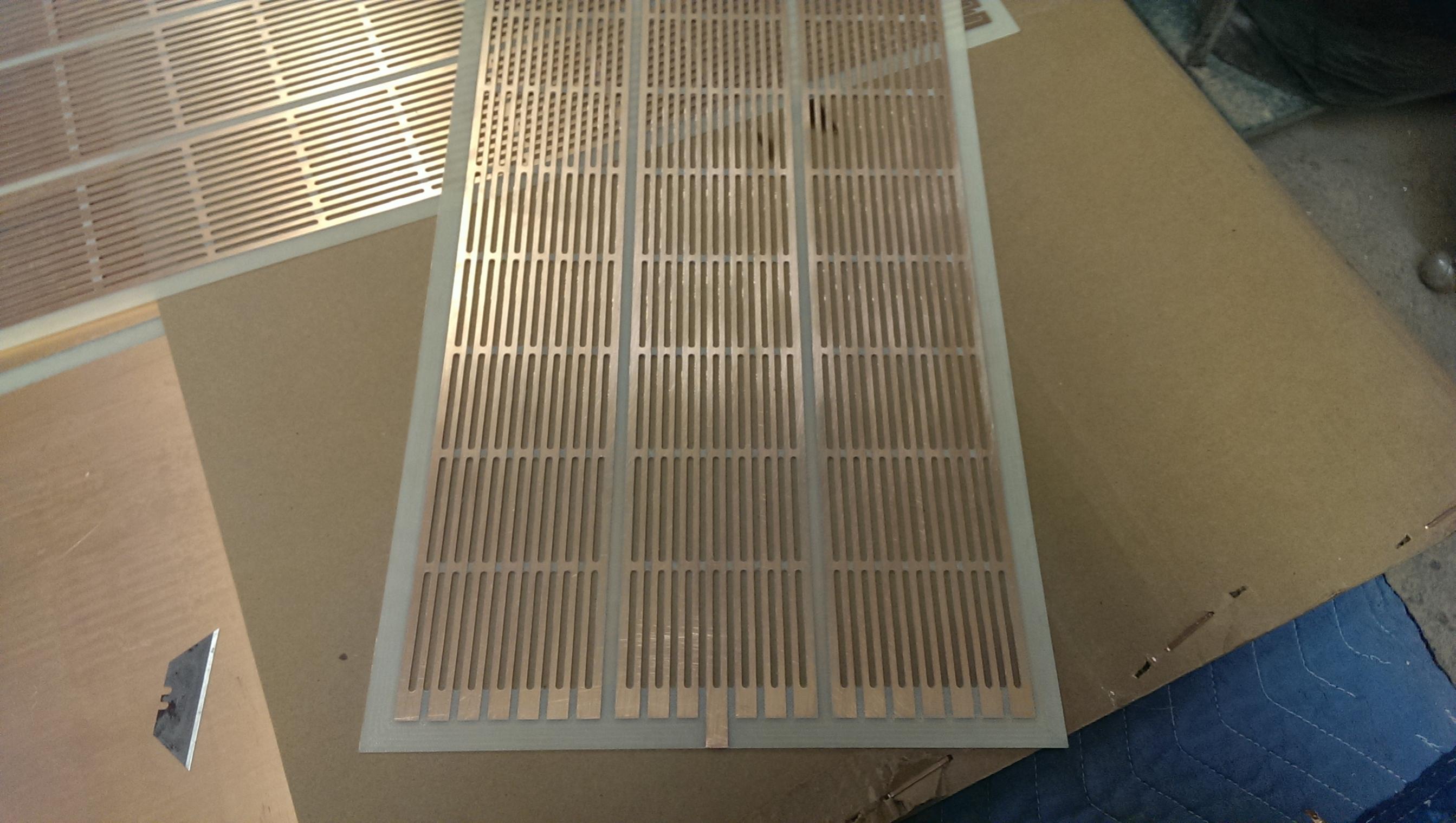

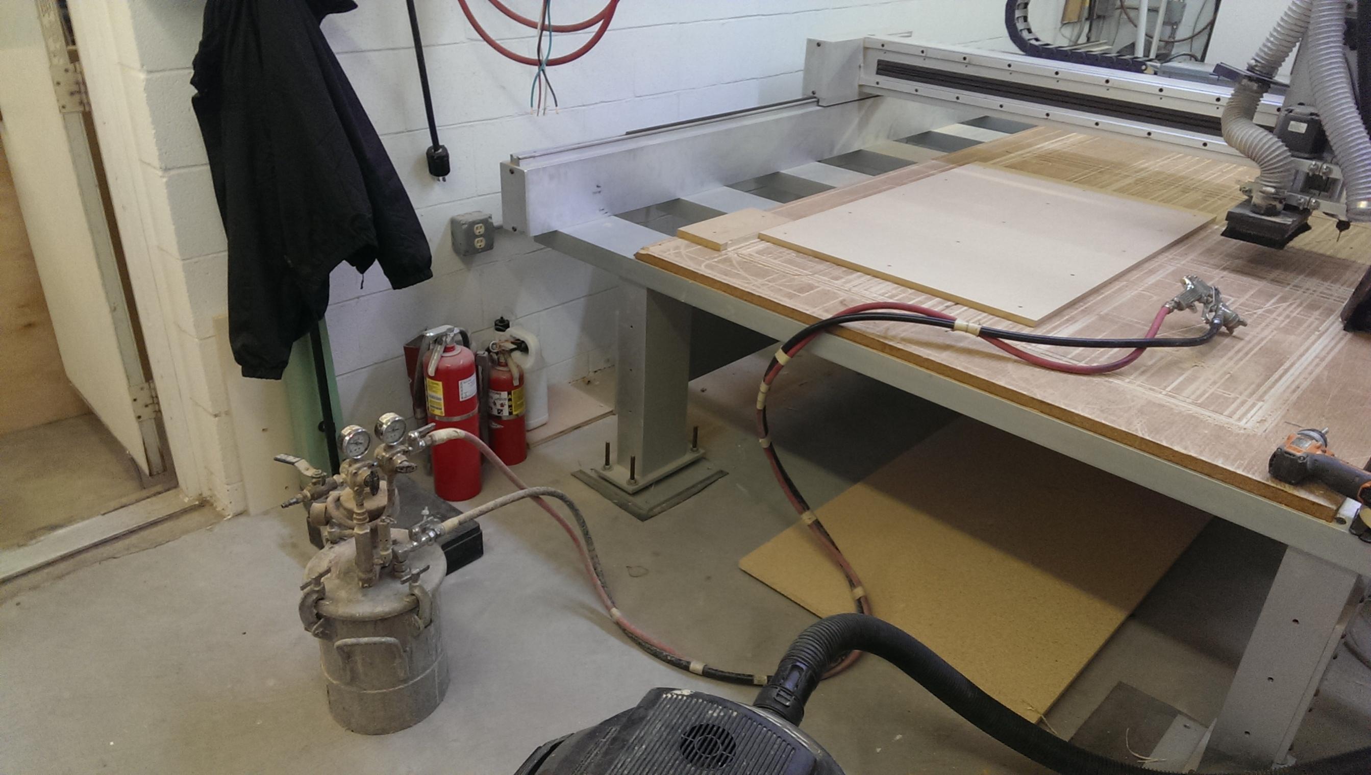

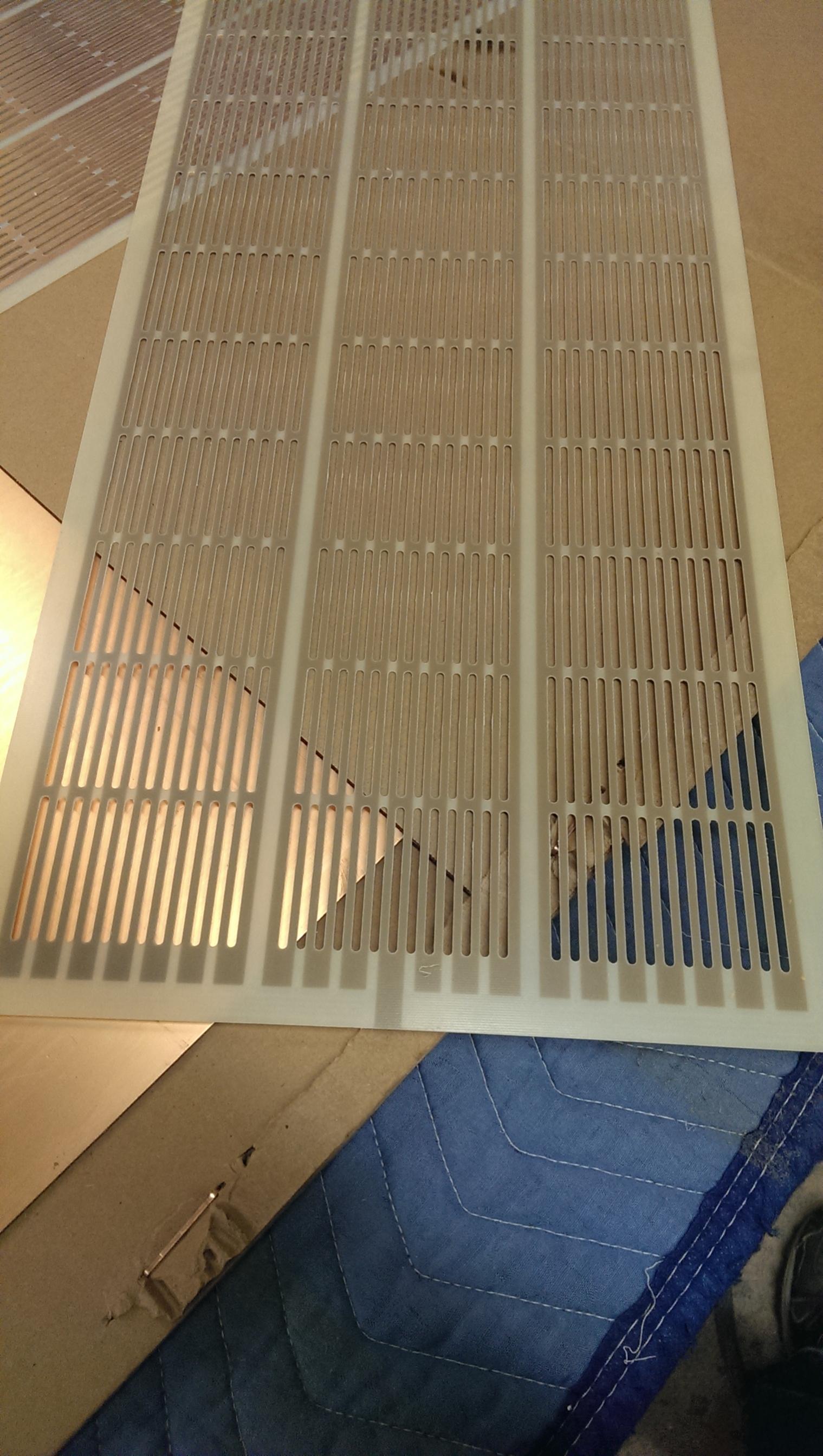

Stators are fully machined. They seem to be pretty good. The machine was accurate enough to take off about .002" just to remove the copper, and also accurate enough to remove about .008" of Cu around each slot. I made these by machining flat a piece of MDF. Then I glued the copper clad G10 to the MDF. The flatness was pretty good (within about .001"). I used a shop vac for chip removal since Garolite is nasty stuff and it would get into the dust collection system. I used a 1/8" 4-flute end mill. It was dull about 3/4 of the way through the second pair. The G10 milled fine with the dull bit but the Cu got messy. I need to clean it up with some sandpaper. Pics attached
nice try so far.
Will there be any additional etching process?
It'd be good if the copper recessed a bit from the hole rims and if the ends of the copper strips at the top and bottom rim of the stator plate could be rounded instead of square-cut. Sharp edges are always prone to flashover.

I will not be doing any etching. In fact these have not been etched at all. It is purely the result of machining.
At the moment the copper is recessed about .008" from he slot edges. I will manually sand all of these to more of a chamfer though as I'm not quite satisfied with that amount.
Regarding the sharp edges, I am planning on having the copper face out, so I can't imagine that I'll get any arcing from those corners.
