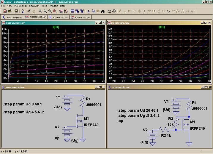

possibly worthwile circuit to try the 550 in might be a SiC PLH

The only deviation from the absolute minimalistic approach is the voltage devider, which is anyhow much more linear/predictable than any voltage gain mechanism in a Triode/SIT.
One should really think about such a circuit as a Triode/SIT simulator.
If you see it like this the Zen would contain also a SIT without additional feedback on the pull side.
I used btw. such a "hybrid circuit" to replace 2SK77 V-FETs in my Yamaha B-I a few years ago and it worked great, it even sounded better !
The hybrid circuit approximated gm, mu and gate capacitances of the 2SK77, introduced a zero tempco (as the 2SK77 has), that the amplifier itself didn't need any change.

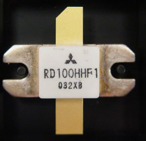

and this the datasheets of the used high frequency parts:
http://www.rfparts.com/pdf_docs/RD/rd100hhf1.pdf
http://www.radio-kits.co.uk/radio-related/Linear_PA/ANVHF027B(RD100HHF1 PP).pdf

There are several commentaries on using the voltage divider to get the
"triode" character. It appears to be most commonly referred to as a
Schade circuit. The voltage divider has also been used to linearize the
character of a fet operated in the linear region.

Yes, I was playing with these RF RD100HHF1 transistors quite successfully, finally I preferred a sound of this integrated amp
http://www.diyaudio.com/forums/solid-state/189044-integrated-no-nfb-son-follower.html
This amp has overtaken good and expensive tube SE 300B amp, and I expected that the DIY story is close to being completed for me. I even shunted the input relay selector in the tube amp, for making it even more transparent, but no, this tube amp (nearly 10K bucks) is remaining without use.
However, DIY story is not finished, to my "regret" the amp with RF jFETs at the output is even better
http://www.diyaudio.com/forums/solid-state/197493-jfet-amp-current-nfb.html
