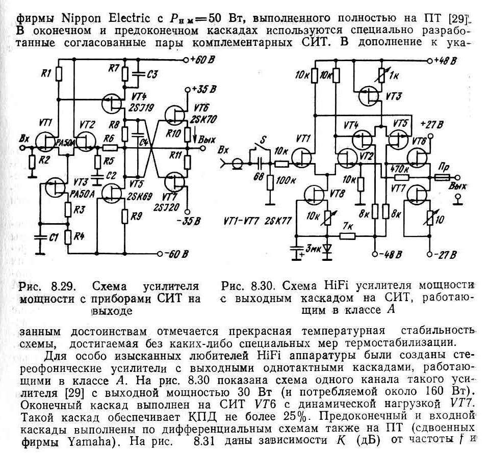

Pronounced in Ruskian much nicer as SHJEET (CИT)
(Yamaha datasheets say SIT, Sony preferred V-FET)
In which electronic magazine you have found this?
perhaps in the magazine "Radiohobby" (Радио хобби) - go to post #13 about
http://www.diyaudio.com/forums/soli...rrently-available-electr-audio-magazines.html
For me it would be of interest, in which kind the audible differences were noticeable, e. g. against a good designed "ZEN" ?In any case, what is of interest to me is that SITs are just about the ideal
