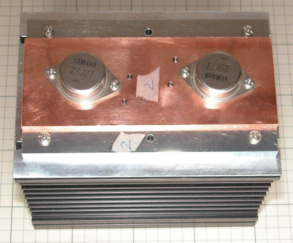

P-Ch
As exotic as it gets (200W each, baby)

I have those heat sinks, Jacco. Wait to use them on sometihng special.

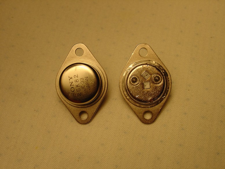

Nelson,
I have to relativate my comment on Single ended Class A, I should say, they are not really feasible for OTL SE-Class A. Transformer coupled they are certainly very nice, but in this case the desired transformation ratio eats up all gain. In this case you need a separate gain device in front of them. The achievable output power is lowish anyhow ...
The Hiraga V-FET complementary Class A (originaly using NEC devices) would also be a rather feasible topology, if the bias current is not adjusted too high, or a blend out of Hiraga Class A and Hiraga "Le Monstre".
Please find enclosed a picture, which shows the two dies of an opened 2SK82.
Please also find enclosed some other small signal "Triode treasues". The 2SK79 (And 2SK63 brother) are brilliant small signal devices, which provide more gain than the power devices. Also watch the Yamaha 2SK75 mu !! The comparison to Nuvistors or E88CC is probably not so far off ...
I also appended a list with V-FET data I collected in the past. Please don't see the data to be definitive or up to date.
In my data collection the 2SK82 has a Pd of 95W, which somehow would represent a wrongly matched pair of dies or combined thermal resistances. But your 65 W are certainly also feasible. In this case the 2SK82 would be rated like one 2SK60 (which is definitely rated 63W).
Very interesting stuff are also the Hitachi V-FETs, the late (80ies) low-voltage Yamaha V-FETs and the N-SIT monsters from Tokin.
To my recent knowledge even Russian manufacturers made Si-SITs in the past.
So the SITs were here on earth all the time (beginning from perhaps late 1969 at Sony R&D), only the Audio/Hifi world forgot them in the mid 80ies ...
If you ask me: right so, this gave me the chance to build up a V-FET amp collection without too much hype related costs ... 😎
greetings,
Mirko
