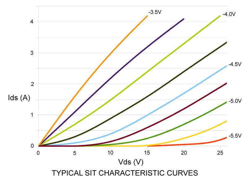

Do you have PASS-SIT-1 parameters for your new model?
First off, I greatly appreciate all the articles you've written which I have read, including the "Simulating SITs" entry. I humbly respect your technical experience and abilities. What doesn't make sense to me however, is why a web application would be written in a version of html that isn't compatible with the majority of browsers that the majority of folks are using, such as FF, or IE?I'm also sorry that some browsers don't support all of HTML5. Writing a program like that takes a lot of time, and in between writing articles, making videos, building projects, oh and my day job, I really didn't have the extra hours available to program work arounds for IE, Safari, or God knows what. If installing Chrome is a problem for you, I'm sorry I can't help.
Good enough to produce realistic results. I would hope for something on the order of a SPICE JFET or MOSFET model. What am I making? Audiophile amps/preamps, guitar/bass amps/preamps/processors. I am doing some fairly in-depth research at the moment, and since I have great respect for NP's design experience and ears, I trust his critiques of the devices he works with, including the PASS-SIT-1. I'm looking to fully characterize the SIT's for comparison sake. My research thus far indicates that SIT devices may not be the only holy grail of amplifier devices as many espouse.It depends, good enough for what? What are you making with these unobtainable parts?

I'm finding that the more modern Sic devices (mostly planar) model better with Koren and the older buried-gate stuff works pretty well with the concise model. Not that we have a big sample of modern device curves to look at, which makes it more challenging. So, we find something that suits our particular need and then we get on with the business of making amplifiers.

I'll stick with the Koren model for the PASS-SIT-1 then, thanks.
I am intrigued by the smoothly-incremental, "symmetric" output curves of the SIT-1 (should produce a strong 3rd harmonic at onset of limiting) compared to the typical asymmetrical curves of the 2SK82 (which should produce mostly 2nd harmonic).
