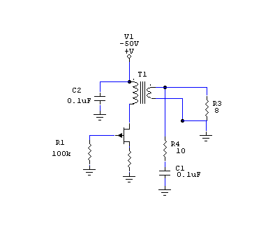

perhaps this has been already addressed elsewhere (and if so, feel free to re-direct me), but if i may ask (and if this is an OK place to ask), how simple would it be to adopt the NewWatt prototype circuit discussed in the SixMoons article to run on 2SK77's? i don't understand enough about transistor characteristics to eyeball that on my own. i see that they were mentioned at the end of the article in the context of higher power output. i happen to very much enjoy both my Yamaha B-1 and my DIYed F5, but i just have to wonder what it would be like to have somewhat of a hybrid!

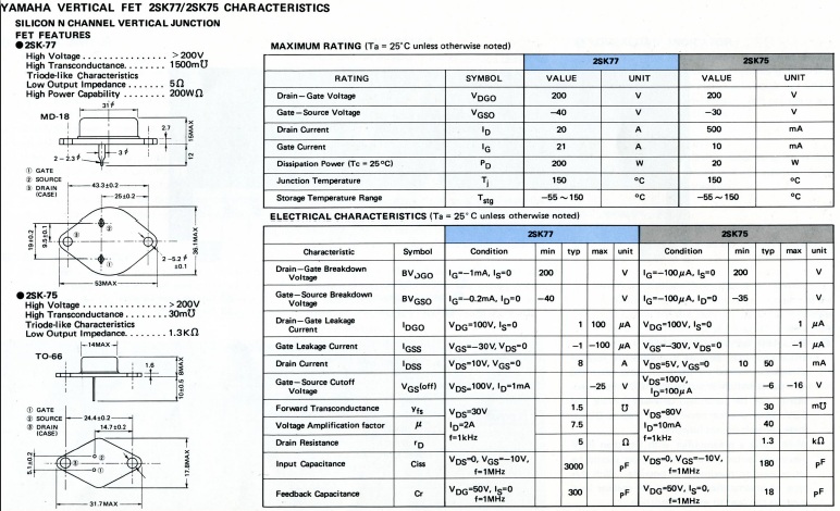

This is nice, I only saw Japanese data so far.
Does your B-I OM also gives data for the other V-FET devices ?
My German B-I OM doesn't say anything about technical data of the transistors ...
The data clearly shows, why Yamaha put a 2SK75 in front of the 2SK77:
The non linear capacitances Cgd and Cgs are extremely high and need a strong driver to cope with the transit frequency modulation of the output device (and the resultant PIM distortion).
Modern SiC SIT are certainly much better here, but the junction caps could be also much more non linear (relatively), because a more complex and dense process geometry can provide dramatic capacitance changes at lower voltages (Which is the result of developing transistors of lower gate charge and high switching efficiencies).
I would not put a 2SK77 into a Zen like circuit, because the highly nonlinear feedback capacitance would appear parallel to the feedback resistor, which is certainly a bad idea, if such resistance is not smaller than a few tens of Ohms.
And: The best place for a 2SK77 is a B-I 😛

i don't want this discussion to veer off-track, though. i have one statement as to why the 2SK77 would not adapt well to the new SIT prototype circuit, are others in agreement?
I have some 2SK77B's, and they are very nice parts, particularly in terms
of the dissipation figures, but they would not be appropriate to the kind
of single-stage amplifiers that I am currently playing with. The input
capacitance is about 10 nF for a single-ended Class A which means that
they have to be driven by a low source impedance, lower than you expect
in audio preamps.
As I indicated previously, I have an article due shortly which addresses some
of these issues for several parts.
