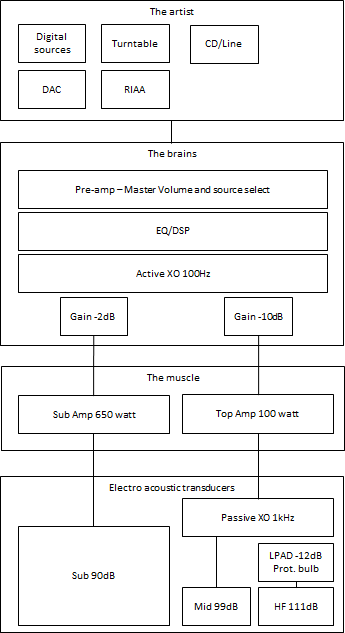

I’d make a logical layout diagram with everything from source to master volume via eq/dsp, signal split to sub and top amp, active or passive crossovers hf protection and component sensitivity.
Let’s for simplicity assume that the sub is 89dB and 400 watt. That’s a range of +26dB. Max SPL 115dB. The midrange would need 40 watt for the same with its 99dB. And the HF only 4 watt with its 109dB to keep up with the sub at 400 and the mid assuming its 40 watt. It shows the relation of how much power reduction you need for the top either active or passive. You could reduce -10 active by gain or smaller amp (65watt) for the whole top and another -10 for the HF only, passive using LPAD. So there are design decision. The mid could potentially play 122dB at 200 watt but the sub will most likely not follow. The HF could easily follow using only 20 watt. You need to look at amps and gains, active and passive crossovers etc. a system drawing always helps.

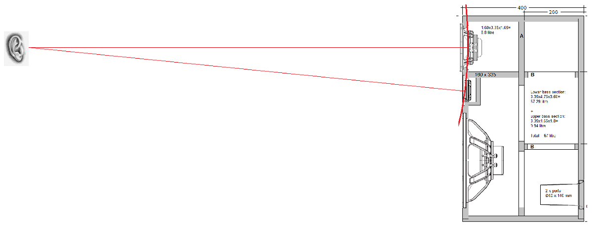

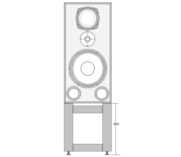

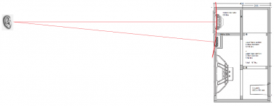

....... I always find the troels designs a bit weird. Shouldn’t the midrange be in the middle?
It is explained in the link
" The reason for having the midrange driver not flush-mounted and on top of the tweeter is to take advantage of the above alignment, assuming listening height on midrange on-axis. This way we can avoid a stepped baffle making an overall easier cabinet construction."
and :
" The speakers need some stands to have the midrange at ear height.
For my listening chair - and ear height, some 35 cm. Adjust height to your conditions."

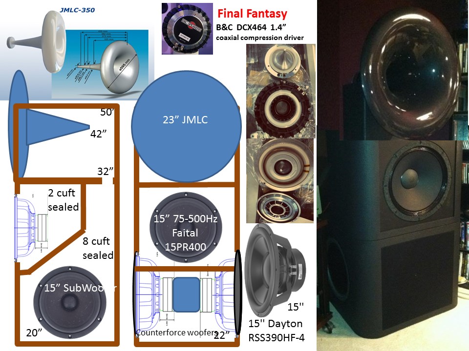

The B&C DCX464 2" coaxial compression driver gets good reviews.
A modest size horn could reach 600Hz and support a smooth crossover to a sealed 2cuft Faital 15" 15PR400 with -F3 ~80Hz for a smooth crossover to subwoofers.
Purchasing the DCX464 and 15PR400 for your first build would support a future trip to "Big Horn Country"
