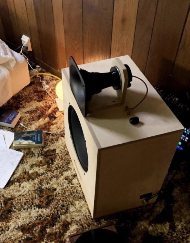

I'm actually going to build something very similar to this..

But your horn is a lot bigger and you have 12” subs in addition. A simple 15” + horn there is a lot of designs available but not necessarily with the sub you have and the horn. Still what about amps and source, budget etc. you may want to read some of the stickies to learn the steps of a design.
Let’s say your target is 120dB peak dynamics and the drivers are 90dB for the sub, 100dB for the midbass and 110dB for the mid/high you would need 1000 watt for the sub (+30dB = 10^3 watt), 100 watt for the mid (+20dB = 10^2 watt) and 10 watt for the highs (+10dB = 10^1 watt). This can be done active or passive but you already see the problem if you add another driver in the mix, you need to have a strategy for amplification and eq/gain before going much further. Power handling will be depending on crossover points say 100Hz and 1000Hz and the slopes, and where you decide to go active. As your sub is 650 watt I would assume you would need at least 100 watt for the top.
