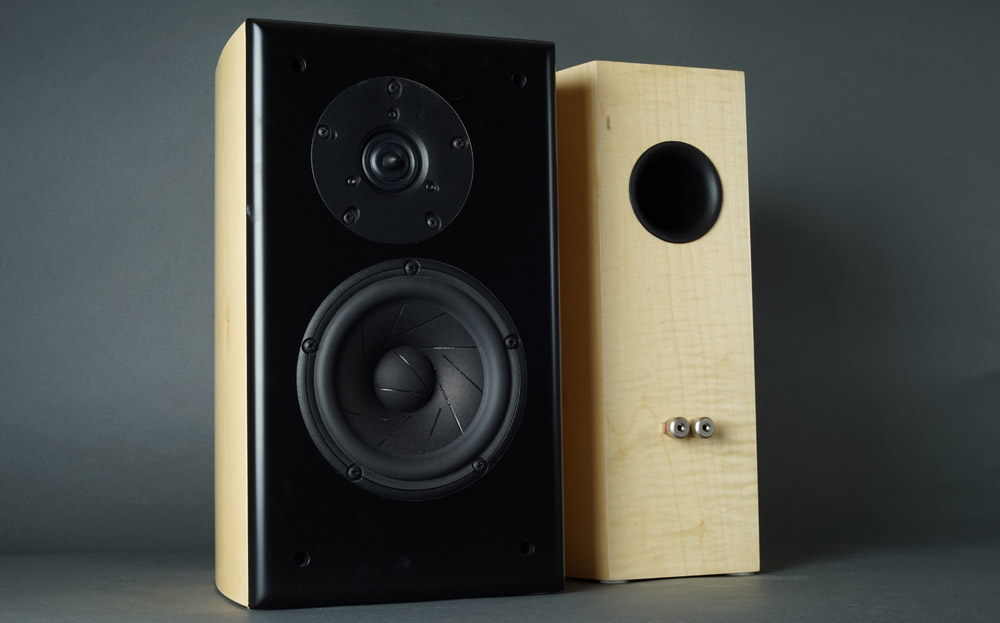

Ah sorry yep that was a mistake. Totally aware of physical limitations with a box this size. Aesthetics definitely play a part - I love the look of the OMA Mini if you’re familiar - heard it many years ago and i was very impressed, then i saw the price tag. I can experiment with lower cost drivers for now, i realize this is part of the fun.
So to summarize you are looking for a decent PA top / 2-way horn design to compliment your sub. Passive. 10” preferably. 40l should be enough if you have a sub. Tune it to 60-70hz for some nice punch or sealed as you mentioned. Coax may be an option if you like that. Eminence Kappalite 3010cx and PSD2013 perhaps? About 1000EUR for complete pair with crossover and box.

Haha all good, i’m really just looking for advice on drivers - i have the azura 550 (550hz) horns with 2 inch throat
I am going to build the enclosure using a kit from parts express
I want to keep it simple, passive, 2 way, and ideally no bigger than 1.5 cubic foot for the woofer enclosure
nothing less, nothing more
a good, sensitive 10 in woofer
everything else running through the upper mid / high freq horn
will be paired with a pair of 12” subs from martin logan (i already have these)

David Weems design tools you pick your lower bass limit frequency, the Q which determines boomy bass (6 db rise before fall) or flat (classical) then Qt & VAS of driver, then his charts give you box size & size of ports if needed. You could go backwards from box size I suppose, to determine your lower frequency.
Eminence states Qt<.4 is for ported, above is for sealed.

Post 22 suggests an eminence coaxial 10". With a CD horn that goes down to 550 hz no reason to open that can of worms. eminence Deltapro10 allegedly handles 52 hz to 4k hz, good for sealed box, should have no beaming problems below 1000 hz. Just simpler. May be cheaper options in UK. Eminence is a bargain here.
