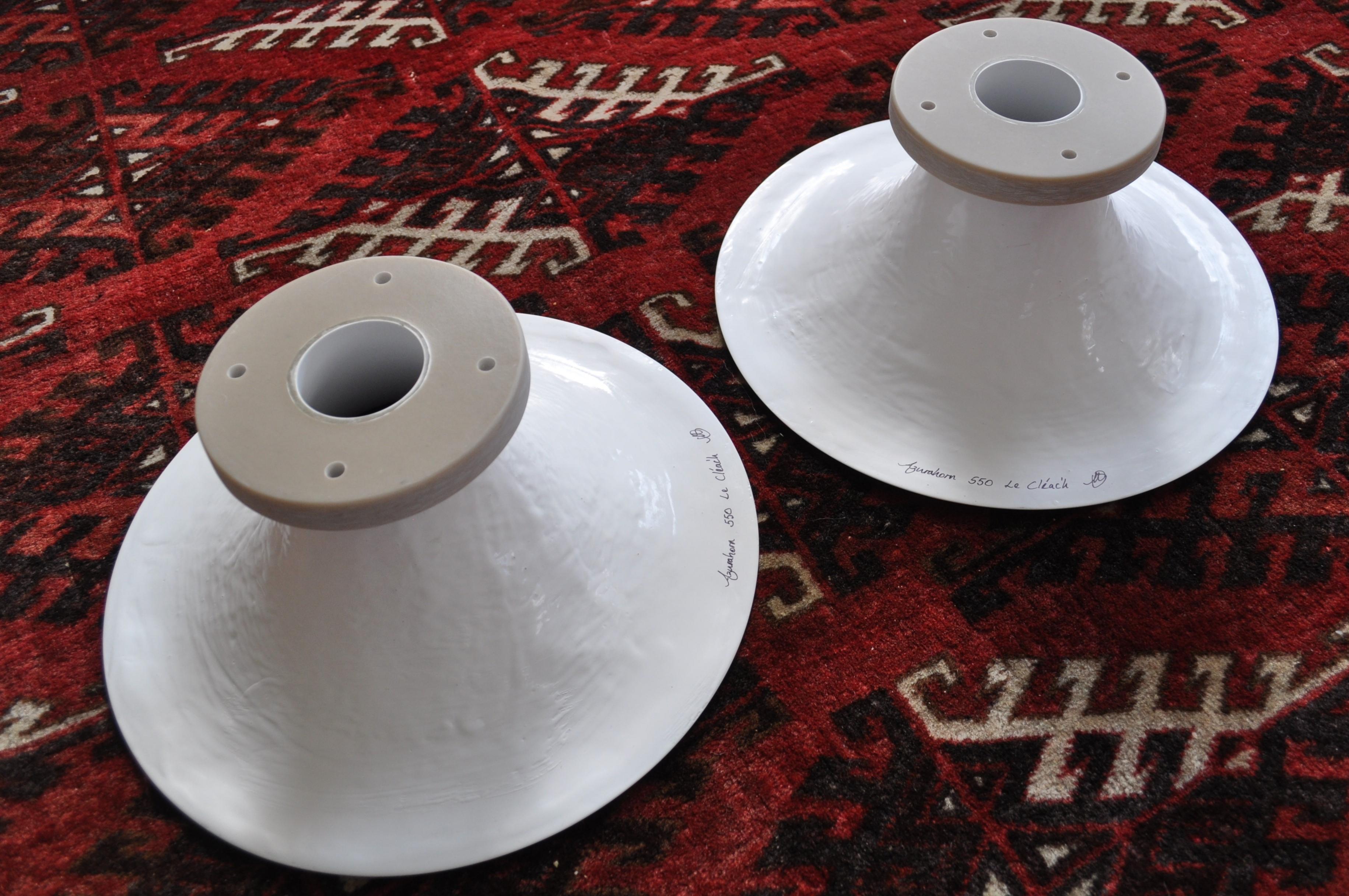

Man, that is going to be a fun day to un box that Horn.
Eventually it could be as simple as using a adjustable active crossover for the Horn.
And powered with a separate amplifier the level is easily controlled.
Of course most would be pretty eager to have a listen when the horn arrives.

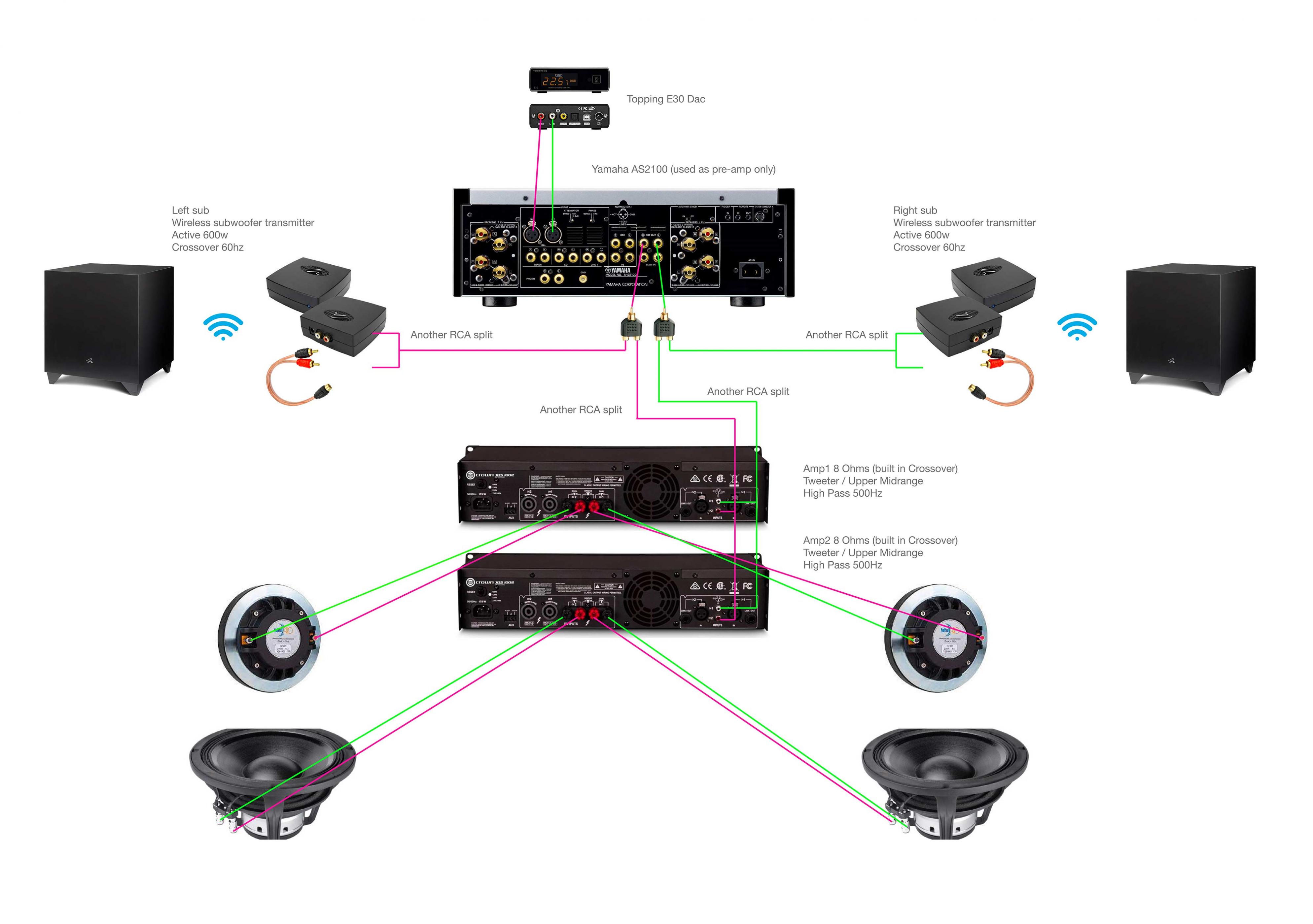

The connection is making my head spin a little.. I drew out a layman's diagram...
Am I insane? Would this work? 🙂
(Oops - there's an error on the diagram with the frequencies...
I would try something like
High pass 800Hz
Band pass 60-800hz)

Looks right.
The crowns is a good idea with its crossovers and eq.
I would still have a passive high pass crossover and a bulb for the tweeter just for protection.
By the way the crowns have link out so you don’t need any RCA splitter.
Put the subs last in chain and you can daisy everything.
By I don’t see a need for the Yamaha at all to be honest and the wireless stuff I don’t know but might introduce delay 😉
I’d cut between sub and 10” around 80 or maybe 100hz given the small sealed box you had in mind.

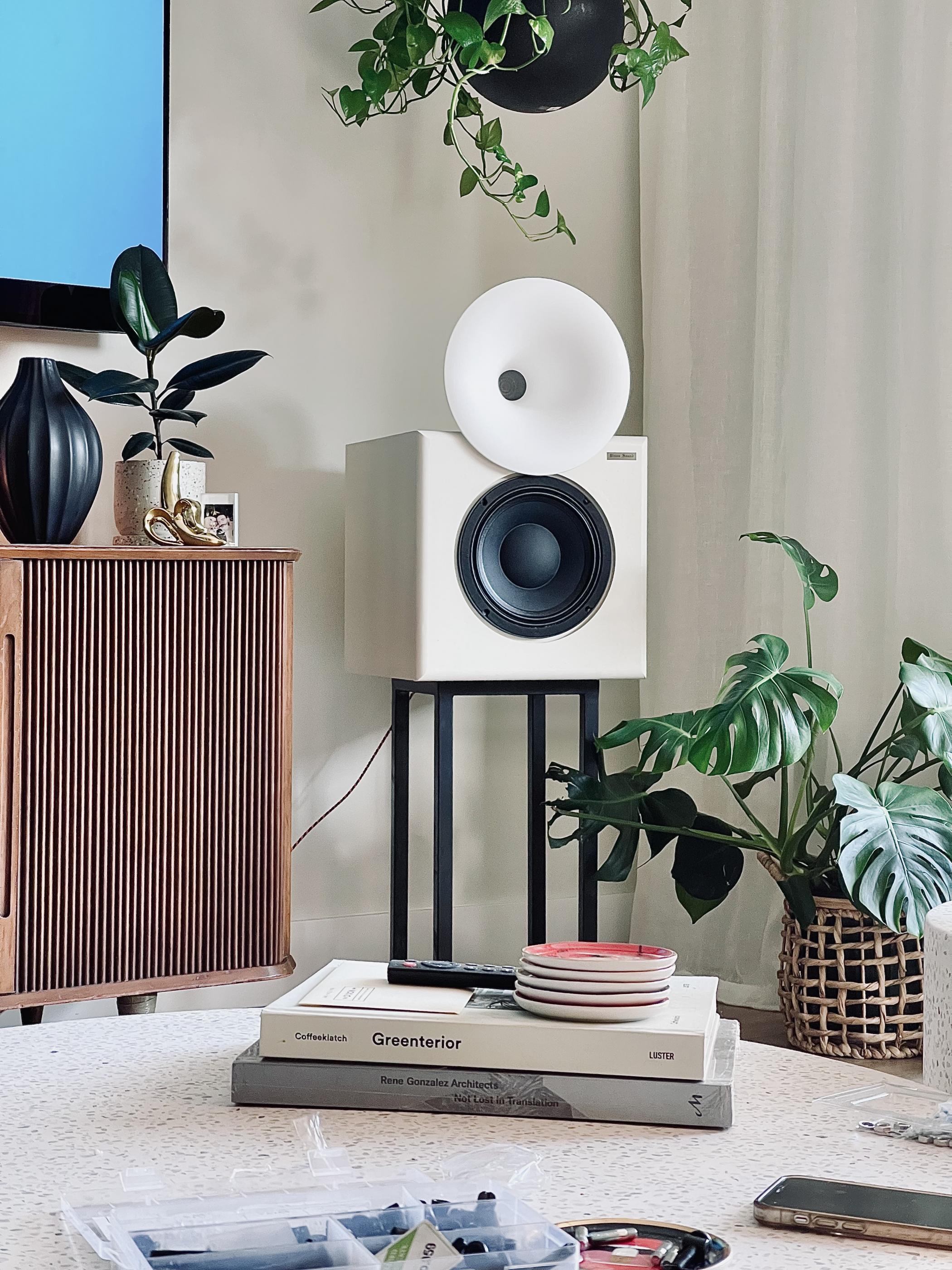

So everything arrived, wired it up as a test and it sounds PHENOMENAL. What am I missing here?! This gives my harbeths a run for their money honestly. Can’t wait for the azura horns to arrive, but wow first impressions are stellar

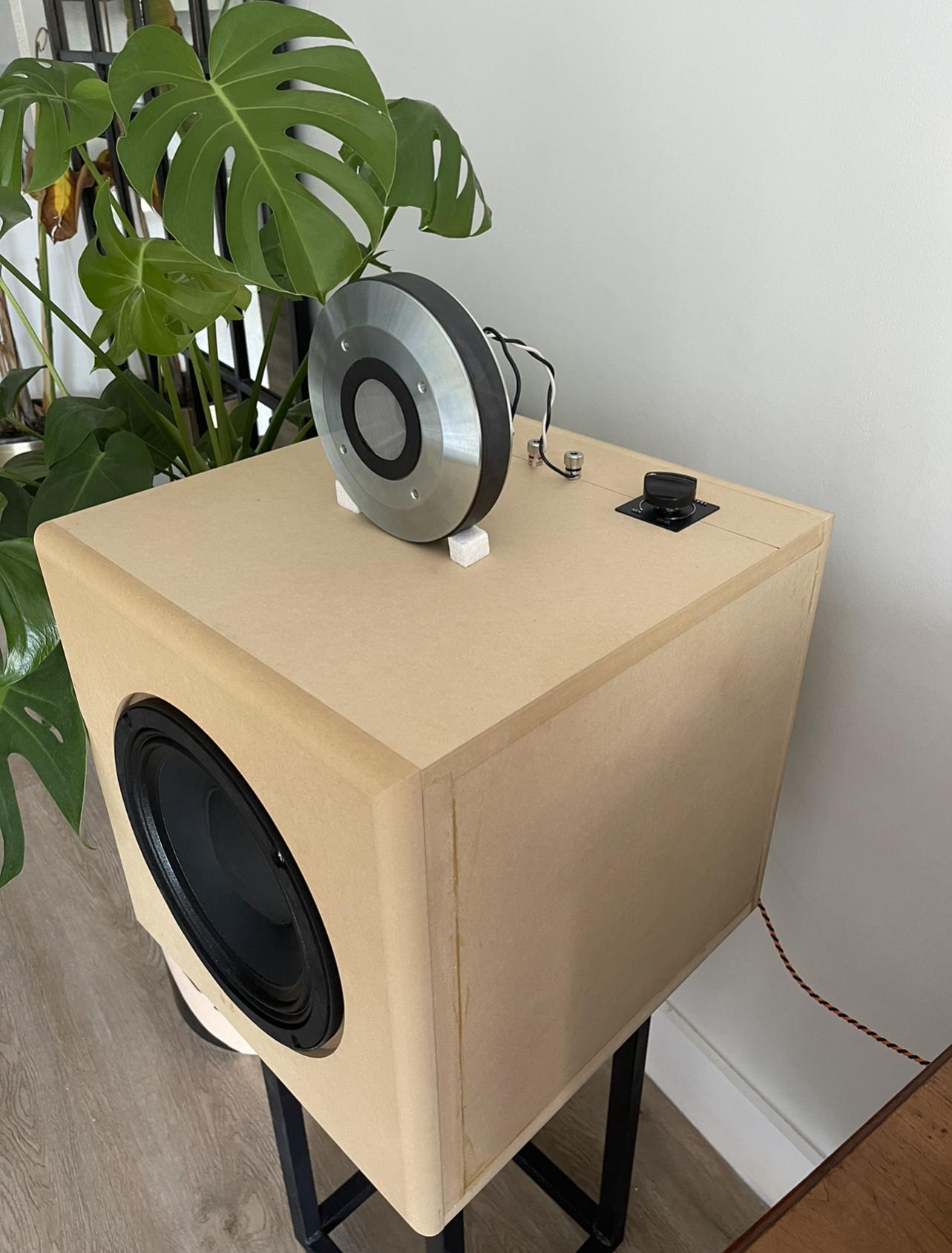

Ended up using two Lpads to tone down the highs and it all integrates beautifully with my dual subs
Awesome. What did you end up with on crossovers and amps? The knock down cabinet looks effective did the cut out fit the faital directly? What’s your plan with finish, stain etc?
Sexy!
My 3way is built on a PE sub box! F'in solid boxes. Are you going to paint it? I just put a few coats of "Tried&True orig." on mine- it is beeswax + linseed oil. No bad fumes- turns orange/brown-ish.

They came out better than expected - I'm 90% complete. The sound is astonishingly good.
