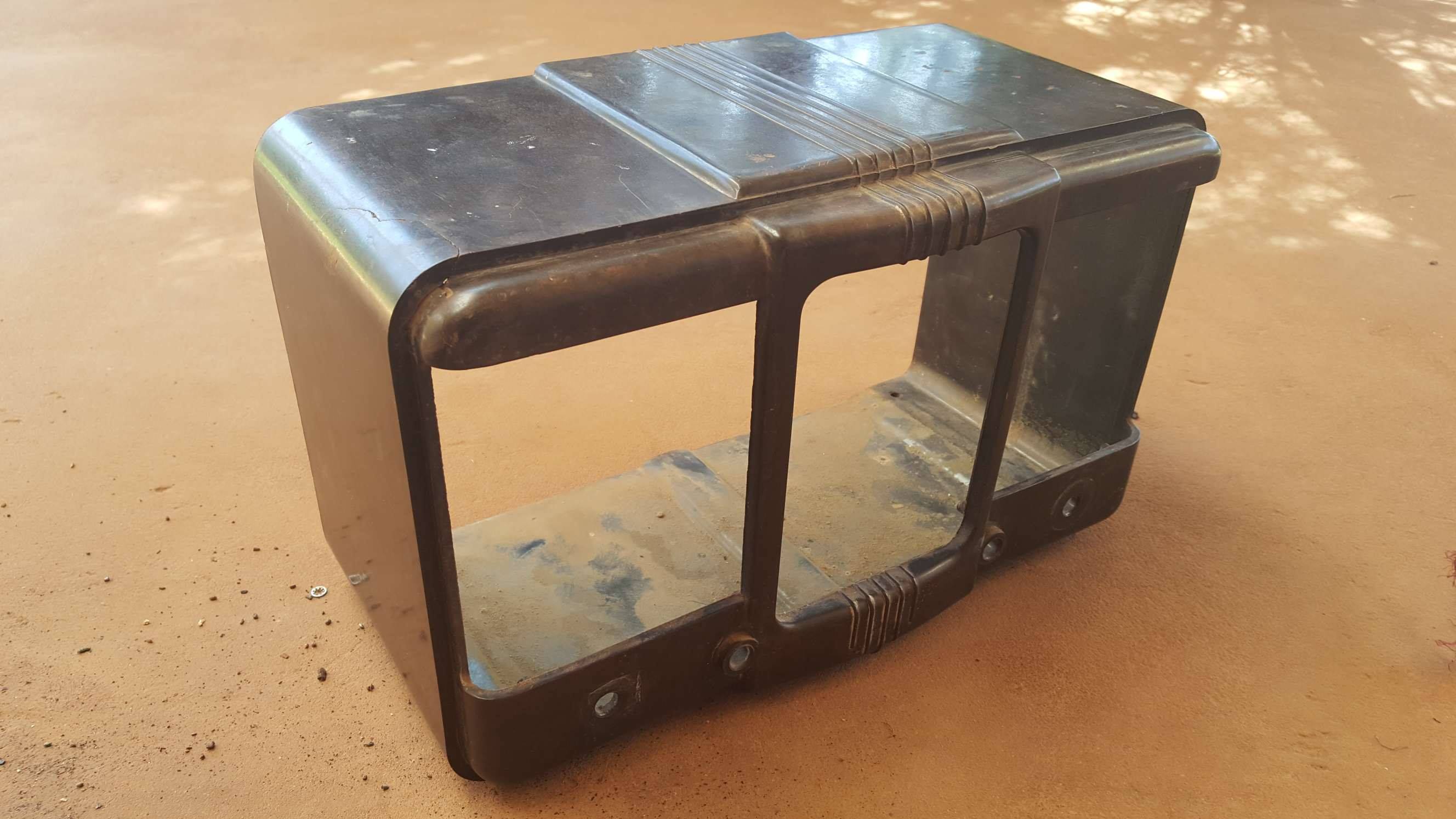

A few weeks back, i found a retro style radio for sale at a garage sale. I decided to make this my first project. This is intended to be a bluetooth speaker system for my workshed. I want it to have bluetooth radio and AUX functionality with a remote control. So I stripped out the old electronics, and cleaned up the shell. (cleaner than whats shown in this pic anyway)

Im planning to make 2 closed speaker boxes out of MDF, (one woofer and one tweeter in each). one for each side of the radio case, and mount my bluetooth thingo in the middle. Put some nice cloth in front of the speakers to keep with the retro asthetic. etc etc.

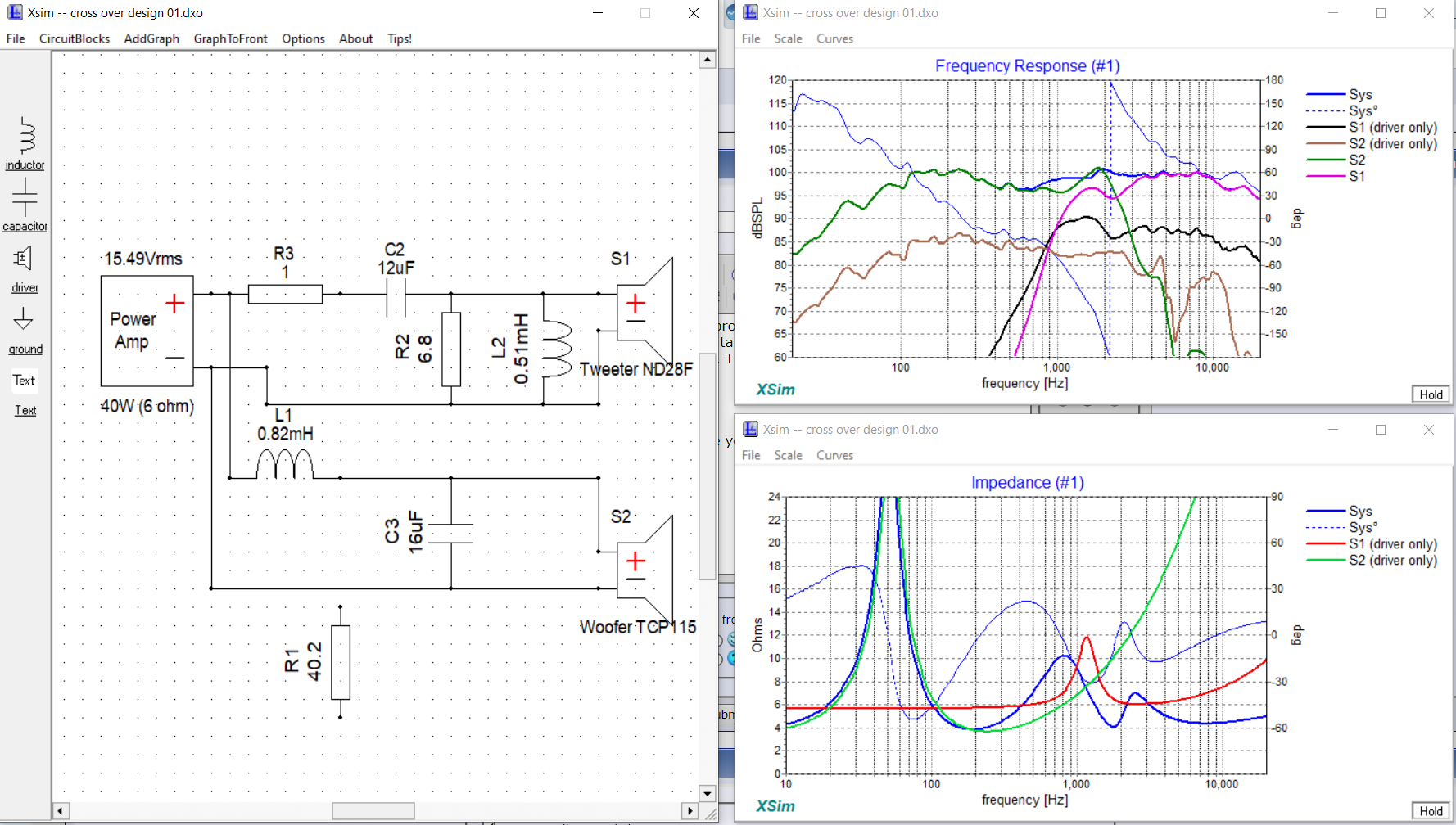

My biggest question right now is the 2400uF capacitor on the woofer. I am given to understand that ususally, you want to stick with film capacitors in stereo design. However, obviously a film capacitor of that size would be prohibitivly expensive. This video seems to claim that if you have a large electrolitic capacitor in series with a resistor, and those in parralel with a film capacitor, then it should be fine.
YouTube
Now im pretty sure that describes what i have in the above schematic. Can anyone confirm for me please if the above system will work with an electrolytic capacitor in the 2400uF position. If not, what are my alternatives?

I would probably start by trying to ditch the remaining woofer resistor. This will take some adjustment of the other two components to restore the balance. This should take the impedance back above 2 ohms.

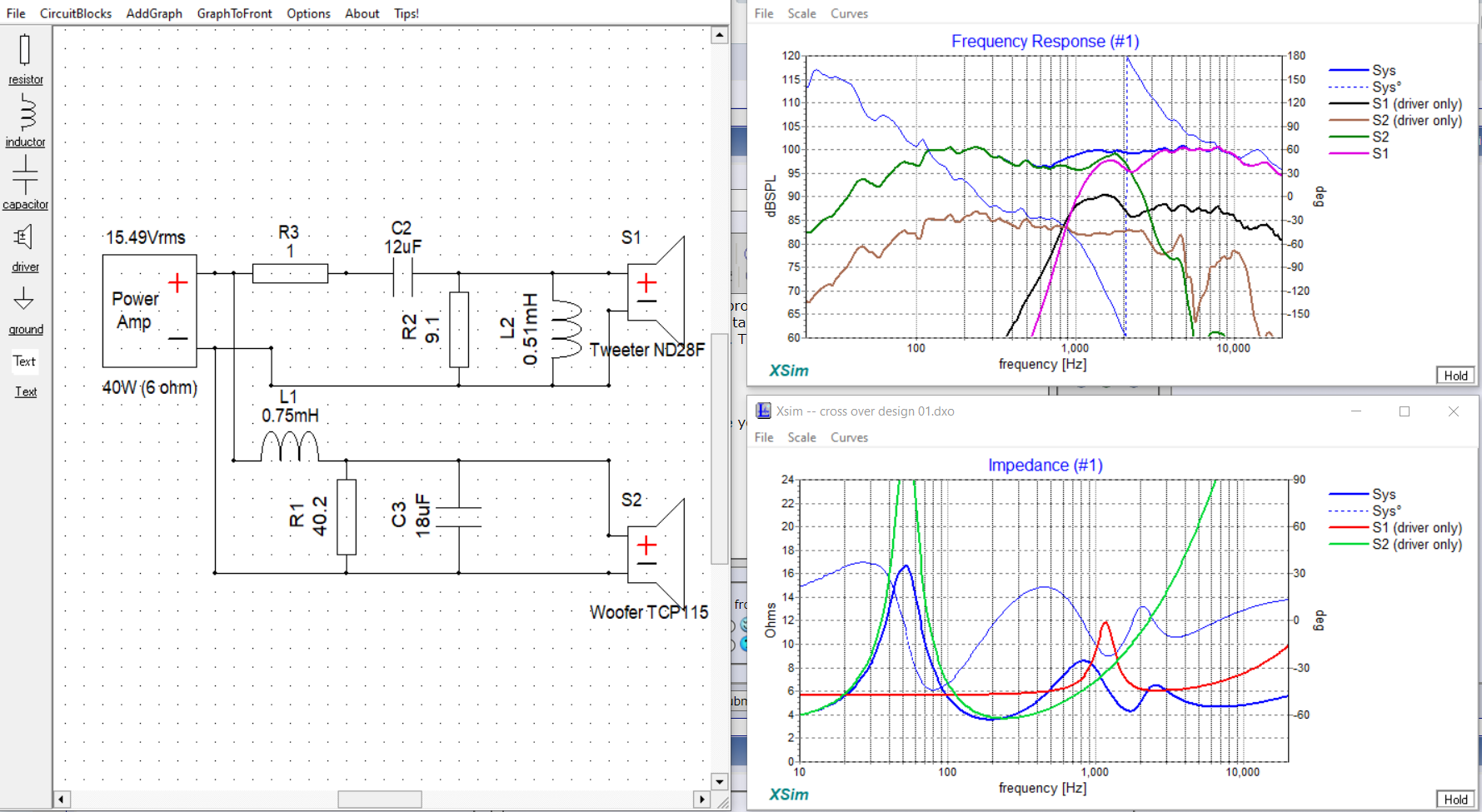

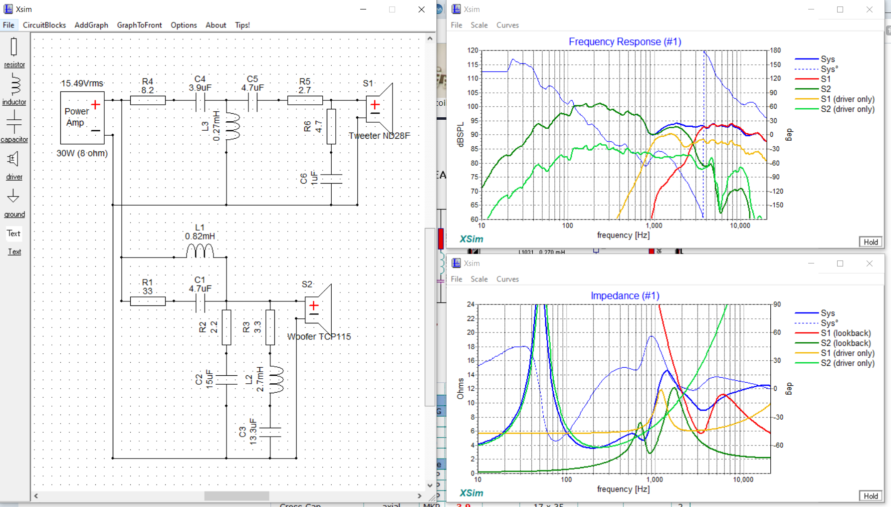

Thanks again for your advice. I tried taking away the resistor, but it creates a HUGE spike in the impedence @ 53 Hz (Image 1). I couldnt seem to reduce that spike with the other components. So I tried adjusting the resistor's value and adjusting the other components until i had a minimum impedence of 4 Ohms (image 2). Im worried that the impedence graph is still too variable.
1. What is the minimum impedence i should be aiming for?
2. How much variability is acceptable in the impedence graph?
3. What other options do i have?
I was under the impression that the impedence graph should be as close to flat as possible?
To deal with this you can use a Voltage source amplifier. Typical audio amplifiers are like this. They are designed to ignore these impedance variations (sort of).
The bluetooth device is 5V, not sure what current it uses.
Ok, if it already has a supply then we don't need to measure that one.
You will almost always have a rise in impedance at the woofer's resonant frequency and sometimes at crossover points. Rising impedance is generally NOT a problem.
The time to worry is when you get deep dips in impedance, below your target. Those can become an amp-killer.
"I was under the impression that the impedence graph should be as close to flat as possible?".
I don't understand the purpose of the CR network across the woofer at all, but I agree with AllenB that it will be a S/C at audio frequencies.
That network although the same in structure, does not look like a Zobel netork.
In any case I have very strong reservations about the need for a Zobel network.
It is argued that one is necessary in order to present a relatively constant Z to the amplifier, but it only really matters if the Z dips to low values placing high current demands on it. What does it matter if the Z goes up to 750 ohms at 1KHz for eg? That will help the amplifier.
I have used just an L in series with my mid/woofer, to flatten its FR characteristic. I don't care that it has a very high Z above the Xover, this serves to lower the load and hence stress on the amplifier.
The loading of the 3.8 ohm resistor will only cause a higher current to be drawn from the power amp; what advantage does that have?

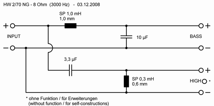

An off-the-shelf crossover is this one:
532776d1456062082-classic-monitor-designs-visaton-hw2-70-crossover-png
HW 2/70 NG - 8 Ohm | Visaton
Add a couple of attenuating resistors for tweeter level and it looks quite good for a 4 ohm bass IMO. You can design for flat impedance, but this is something that mostly interests the SET (single ended triode) valve enthusiasts.

@System7 Thanks for the reccomendation. I took a look, and put that crossover diagram into XSim (Image 1). Obviously it was less than ideal for my drivers at the given values, but after some tweaking, i think i have it looking ok (Image 2). Is that functionally going to any better than the other setup I had? (Image 3). Should i just go for the cheaper setup at this point?

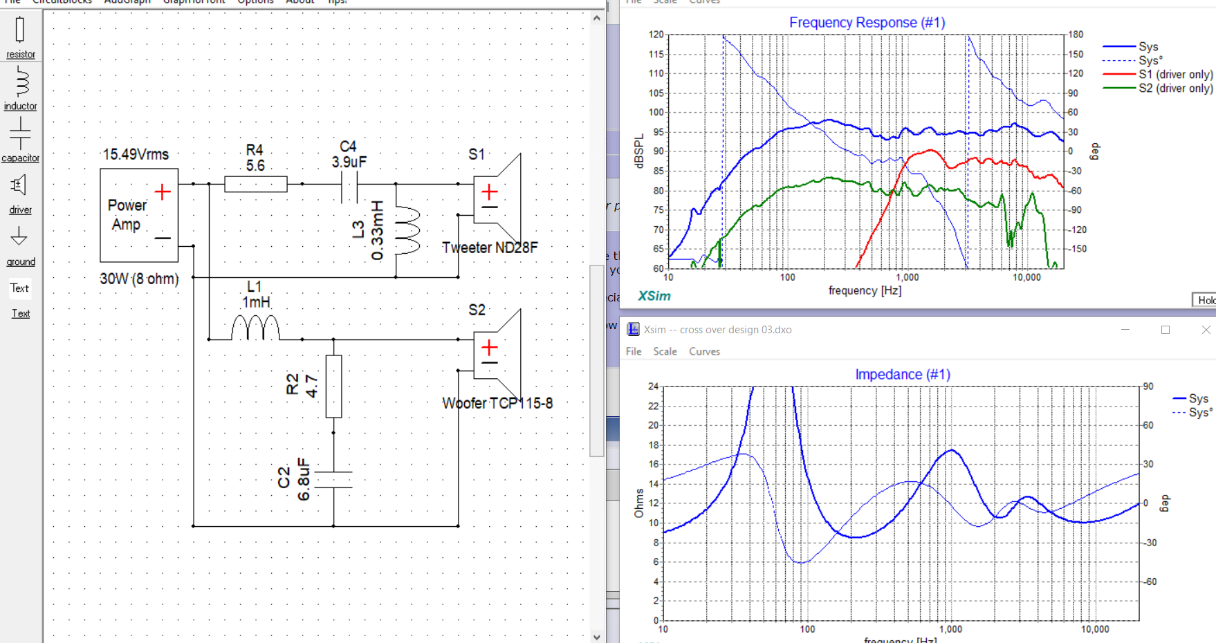

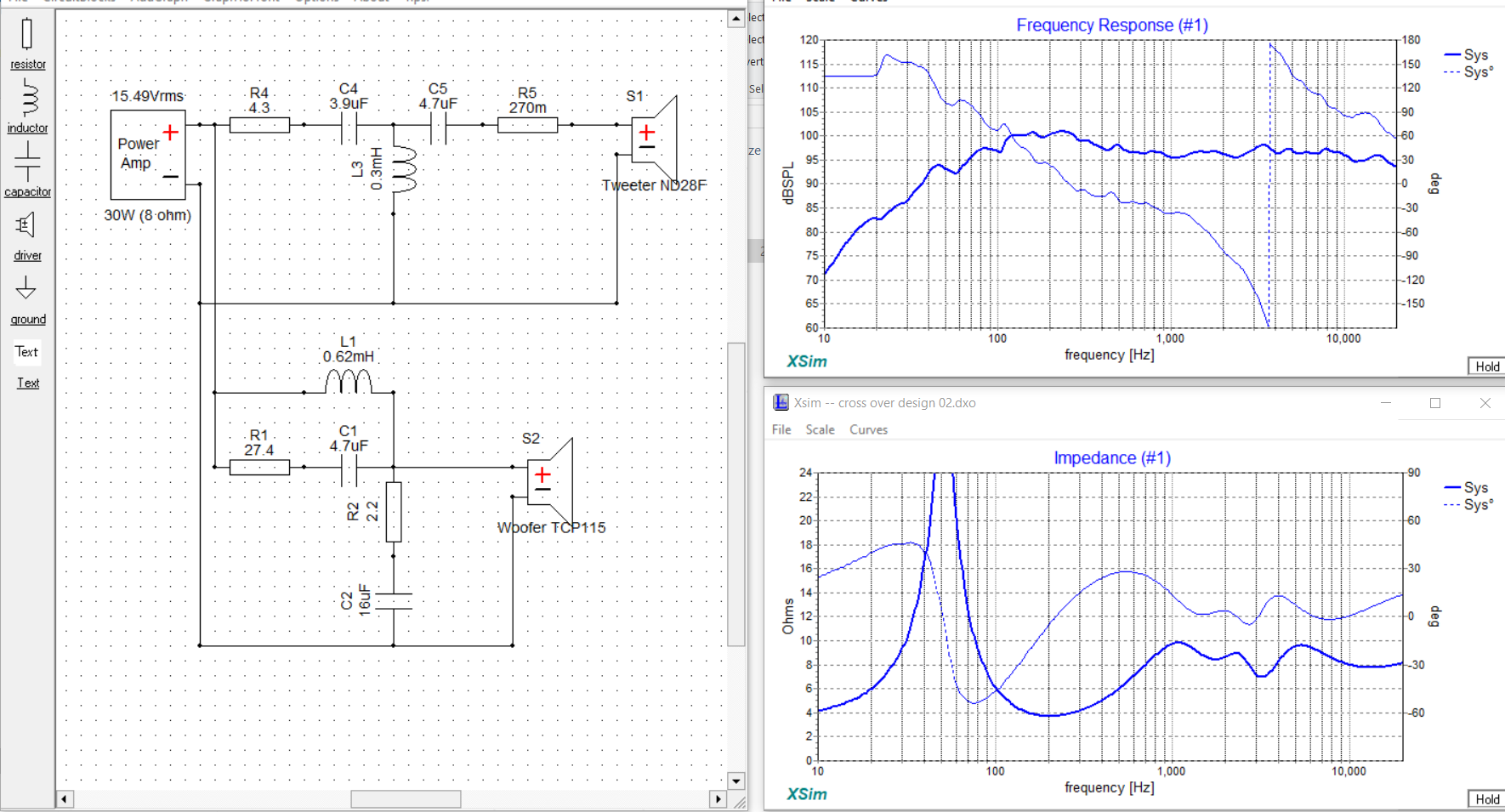

Unless you have bought the woofers already, I think the 8 ohm version of this paper cone will just be easier: TCP115-8 4" Treated Paper Cone Midbass Woofer 8 Ohm
Your 4 ohm driver is not a polycone according to Dayton Audio:
TCP115-4 4" Poly Cone Midbass Woofer 4 Ohm
From what I see of the tweeter, it needs quite a high crossover, around 3kHz:
Dayton Audio ND28F-6 1-1/8" Soft Dome Neodymium Tweeter
So smaller values like 4.7uF and 0.2mH ought to do the right things. The tweeter has quite a sharp impedance peak around 1kHz, so a 10R resistor in parallel with it will be no bad thing.
The bass filter is usually just a coil and capacitor. Simple as that.
I am a bit mystified by the downward slope on the bass driver, and I wonder how Dayton have measured it. Always a headache with imported files to know how hey were measured. In a box or on a big baffle?
The bass breaks up a bit above 5kHz, so hope for the best.

@system7 Thanks, just subbed in that woofer. Looks like i can get a decent crossover quite a bit cheaper (Image 1). Also should have a minimum of ~8.4Ohms impedence. Which, since i gather higher impedence is better makes this a significant upgrade on my last setup?
Sorry to but in again ... but higher doesn't mean better. It is a little easier on the amplifier because it draws less current, but that's about the only advantage.
"Better" generally comes from carefully matching drivers and box designs. In theory, the right drivers in the right box don't need a complex crossover. Sometimes it can be as simple as a single capacitor to keep bass energy out of the tweeter.
The crossover does play a role, of course, but mostly it's there to correct for our compromises.
What I meant by my previous post is that if you are doing a design and you get a real low dip in impedance someplace on the response curve, it could overheat and damage the amplifier... That is if you are designing for 8 ohms and at some point the impedance dips to 1 ohm, even while the rest is still at 8 or 10 ohms, your amp is at risk.
The opposite... that characteristic rise to 20 ohms or so at woofer resonance is not harmful. It's just hard to look at. :D
