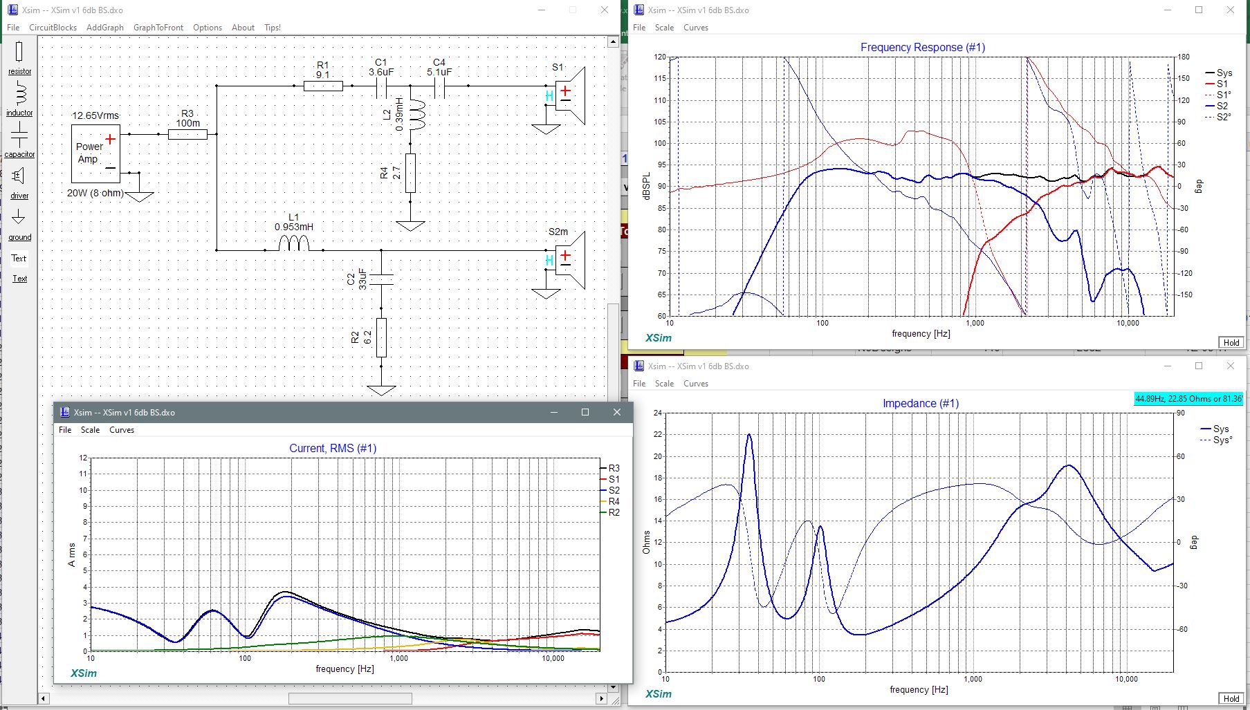

That is one of the concerns. Any currents flowing that don't go through a voice coil are simply wasted energy. We should naturally want to minimise that as it makes our speakers less and less efficient. In some cases it can actually damage a very expensive amplifier.
Have a look at my commentary in THIS THREAD Also in earlier messages here you will see where I've pointed out some issues where more than half of the amplifier's current is simply wasted in overly complex filter designs.
I had a play around with XSim just now, and found where to bring up the current graph. What should I be aiming for?
Ideally ALL current from the amplifier should go through a voice coil. The goal is to minimize wasted energy as much as possible.

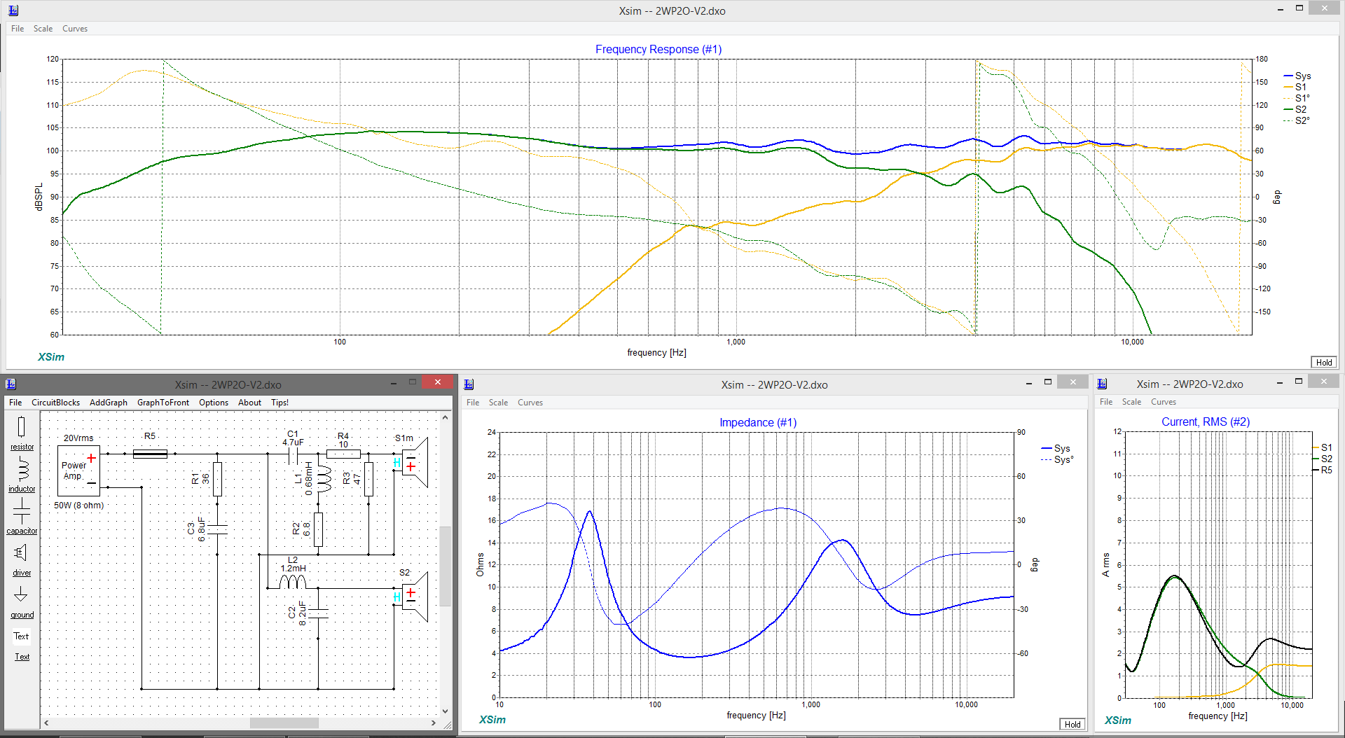

Even if i think that you made some mistakes in your calculations (tweeter frequencies will never give full power), your general point is true. When i build a crossover for real this is a factor i study more than here. Here it was first trying to understand what other said, and then try to apply the techniques explained. But i gave it a go with your remarks in mind...
This sim is with the R5 like you use it (to measure the current going in) and the drivers are shown in the current graph. I loose some current because the attenuation of the tweeter, but for the rest it's optimised now i think...

You might get it a bit closer by tweaking C2 and R1 a bit... C2 at 16uf and R1 at 4.7 ohms evens the midrange out a bit. It's not likely to make a huge difference in what you hear but it would reduce the wasted current a bit.

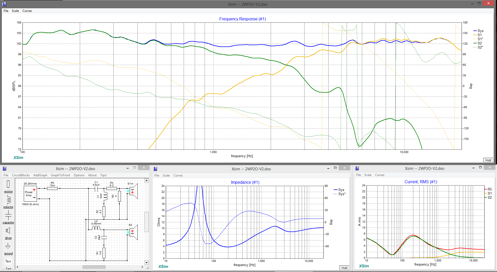

Blake, I'm trying to figure out if looking at the current draw at 100W fails to give the whole picture in this example with the OP's chosen drivers. Here's what I mean.
Assuming you've got a 100W amplifier at 4ohm, that means it's capable of a max current of 5 amps (Current = the squareroot of Power over Resistance). Now with the TCP115-4, according to the spec sheet and Unibox, xmax with musical content above 40Hz will be reached with 6W for an SPL of 90.5dB at 1m. Let's assume that we turn the volume knob up a little more with it anyways and that maybe we want to give 3dB more for headroom and so the maximum power we will be pulling from the amplifier is 20W. I think that's fairly realistic. Heck the max power rating of the driver is only 40W anyways.
In the XSim below, using the xo I designed in Post #25, now if we look at the current draw with the maximum of 20W that we are likely to ever use, we see that the speaker never actually draws more than 4amps from the amplifier. And in fact the highest current draw from this design is at about 200Hz which has nothing to do with the xo and everything to do with the inefficiency of the driver.
My conclusion would therefore be that it's a completely acceptable xo for these drivers as long as we have enough power (and current) to drive them. Indeed it reinforces the need for a high current amp and therefore perhaps the need for a little more watts than one might think if you are just looking at the sensitivity, max SPL and power relationship. And the need to be careful with component values in your parallel xo legs as well I guess.

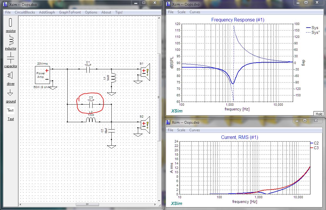

Prime example... the thumbnail below (values approximate). "I'm not getting any treble" and the guy freaked out when I pointed out the problem was in his low pass filter. No matter how many times I tried to explain it he just couldn't understand how two capacitors in series (C2 and C3) in a low pass filter could drain his amp of current at high frequency. All he needed to do was take C3 out and it would have worked brilliantly for him...

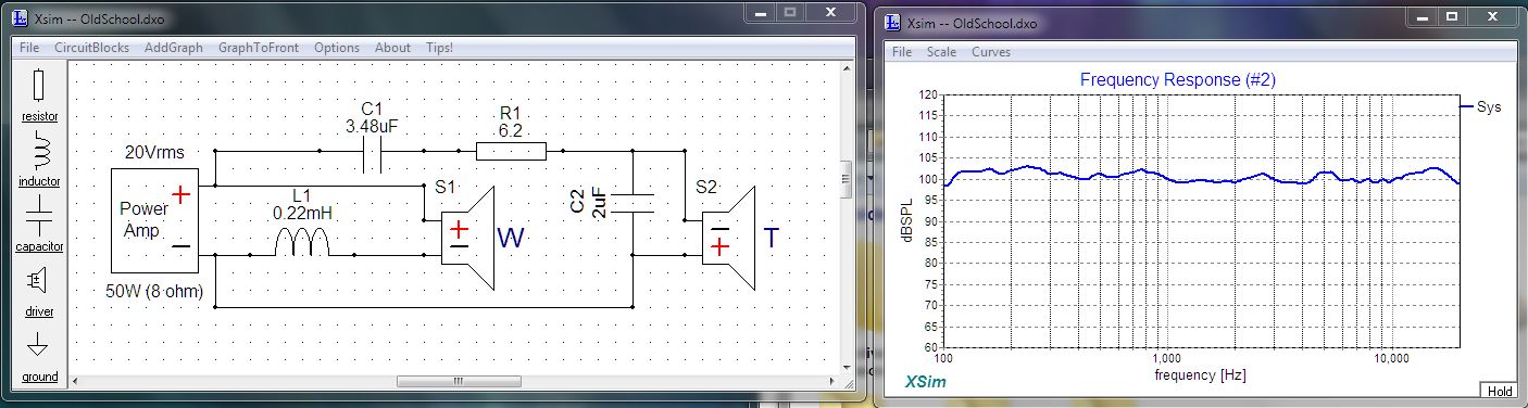

BTW ... did you see the mock-up where I went "old school" on your drivers? I was a little surprised it worked... but it does remain to be tested.

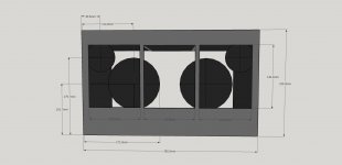

Mygyth,

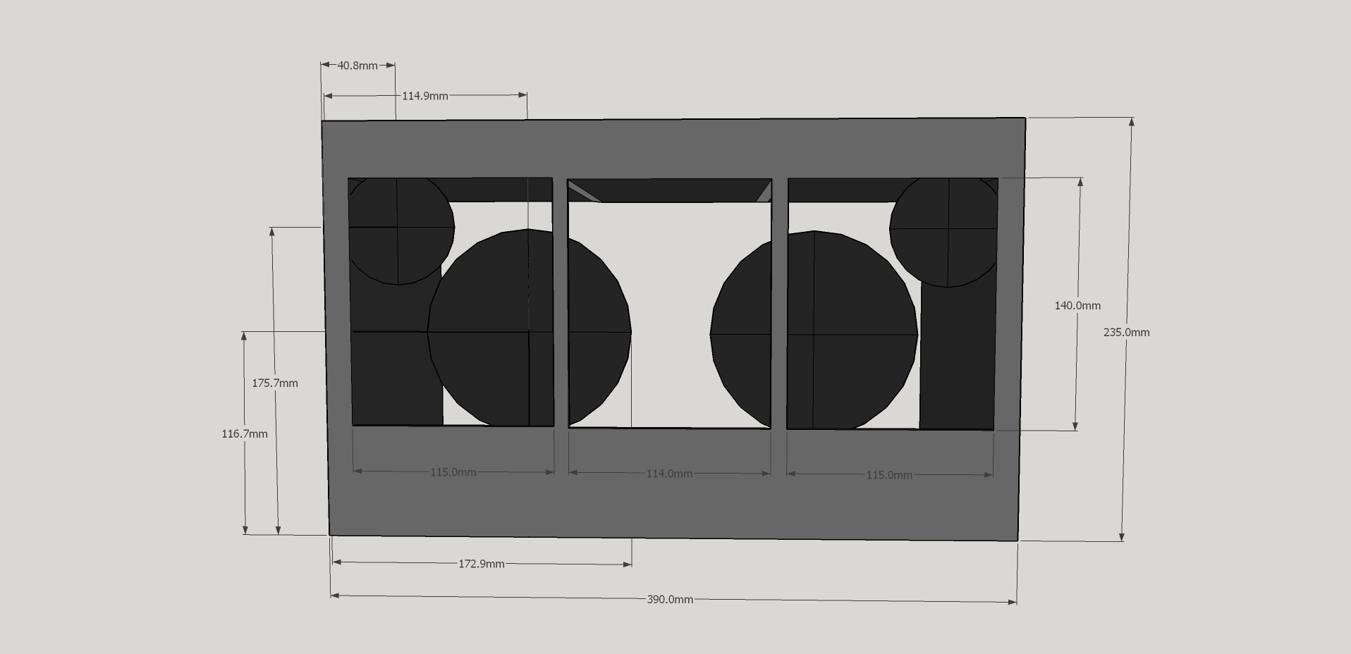

Holy cow, the 1st thing I'm seeing is that is going to be really tight for your chosen drivers.
I attached a quick sketch of where I'd put the drivers but it doesn't actually fit within your desired speaker cabinet width of <150mm. Let me know if this is what you were thinking. Perhaps a tweeter with a smaller face plate or in fact no face plate at all would be in order here.

Mygyth,

.... what were the flaws in my driver choice? What parameters should i be paying more attention to?
Actually those are a pretty good choice for drivers. They work well together and the woofer only needs about 2L, it's got a pretty smooth FR and the rising response in the LF helps with baffle step compensation which means sensitivity will be just a little bit higher than a totally flat response. And it will go reasonably low in a vented box.
If I've got the dimensions about right in my diagram above, then it looks like you've got 2 choices:
1- to fit both of those drivers in the given "windows" the cabinets need to be about 180mm wide (but they don't need to be the full 235mm tall)
2 - change the tweeter selection to something smaller like one of these 2:
Peerless XT25SC40-04 1" Ring Radiator XT Tweeter 4 Ohm
Peerless by Tymphany OT19NC00-04 3/4" Fabric Dome Tweeter 4 Ohm
But that's if my diagram is correct. I don't have the radio in front of me. If you have a positioning of the drivers that fits, please let me know.
Actually, a 3rd choice would be Blake's suggestion of going with a smaller full range driver. I'd probably still stick with a tweeter because I suspect you will be listening off-axis pretty much all the time and full rangers are worse off-axis than smaller tweeters. But I looked at a few selections yesterday and I still liked your choice of the Dayton better. But maybe there's something I missed?
