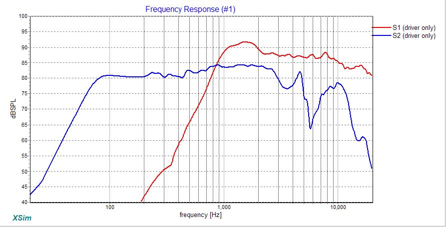

A couple of tips ... when viewing curves in X-Sim, look at the curves marked "S1", "S2" etc. The "driver only" curve is showing you what the driver itself would do... not what your crossover is doing with the driver.
From your last thumbnail, I would move R4 behind C4, this is to prevent it from carrying current all the time. I would try to adjust C2 without R2 in the circuit... If you right click on it you can temporarily short it and remove it later, if it's not helpful.
But it looks like you're getting close to a "first blush" design. Do keep in mind that computer simulation in XSim and it's cousins does not take your box or your room into consideration, so it is just a rough estimate at best.

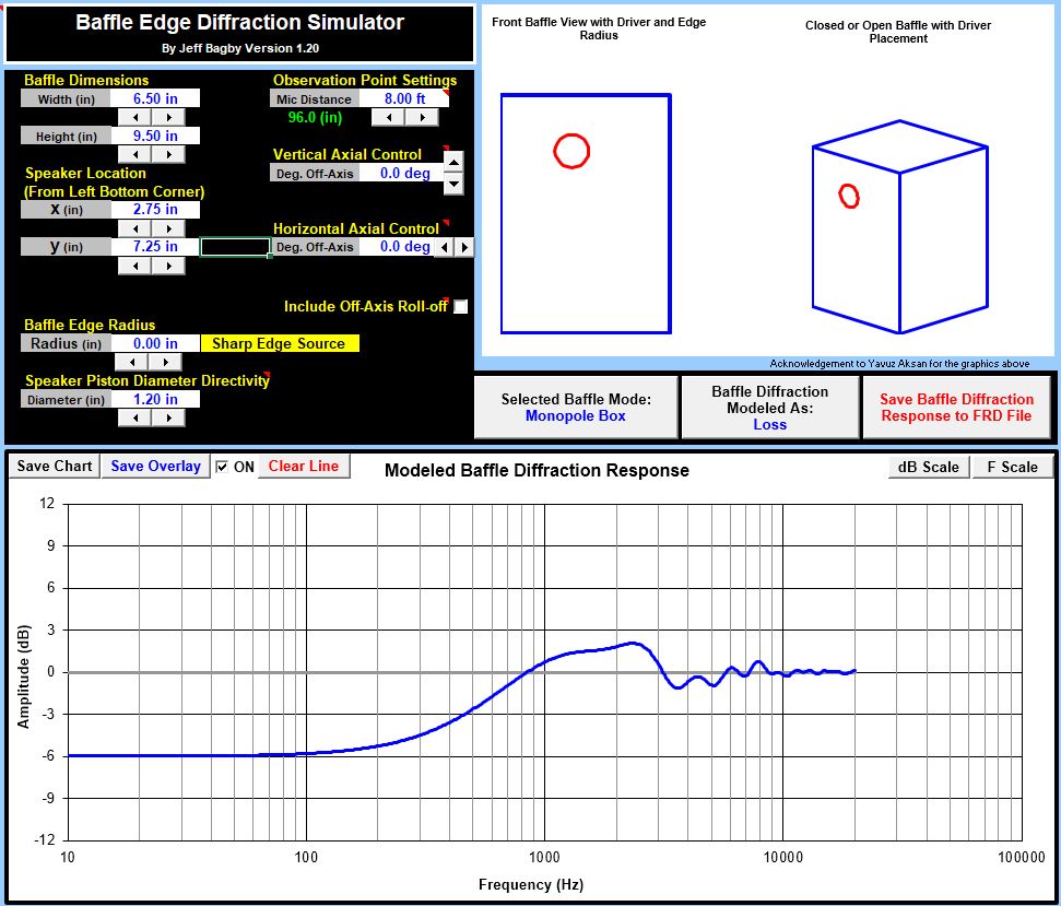

1) you must include baffle diffraction effects in your frd files
2) you have to account for the different acoustic centers of the drivers and their distance to your ears
3) you also have to extract minimum phase from both your frd and zma files and align each driver's phase in the xo region
I could also say that you haven't included the effects of your box on the woofer's FR and impedance files which are necessary for your design but with a 2-way with a high enough xo point, don't actually make much of a difference to the actual xo sims. Personally, I always include them anyways.

A couple more tips for XSim:
- in the FR graph, get rid of the phase for the system response too. It tells you nothing. Instead, check the "show with phase" box for S1 and S2. Now what you want to do is try to get those lines to match up as closely as possible in the region of the xo or in other words in the frequency range where the 2 drivers are both contributing to the summed response. Do this while at the same time keeping the summed response as flat as possible.
- you can get rid of the "driver only" curves in the Impedance graph as well
- to extract minimum phase from your files, go to the "Tune" window for each driver and for the FRD and ZMA phase source, select "derived" instead of "measured"

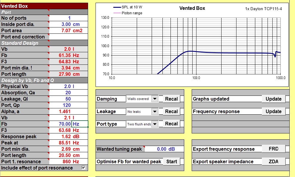

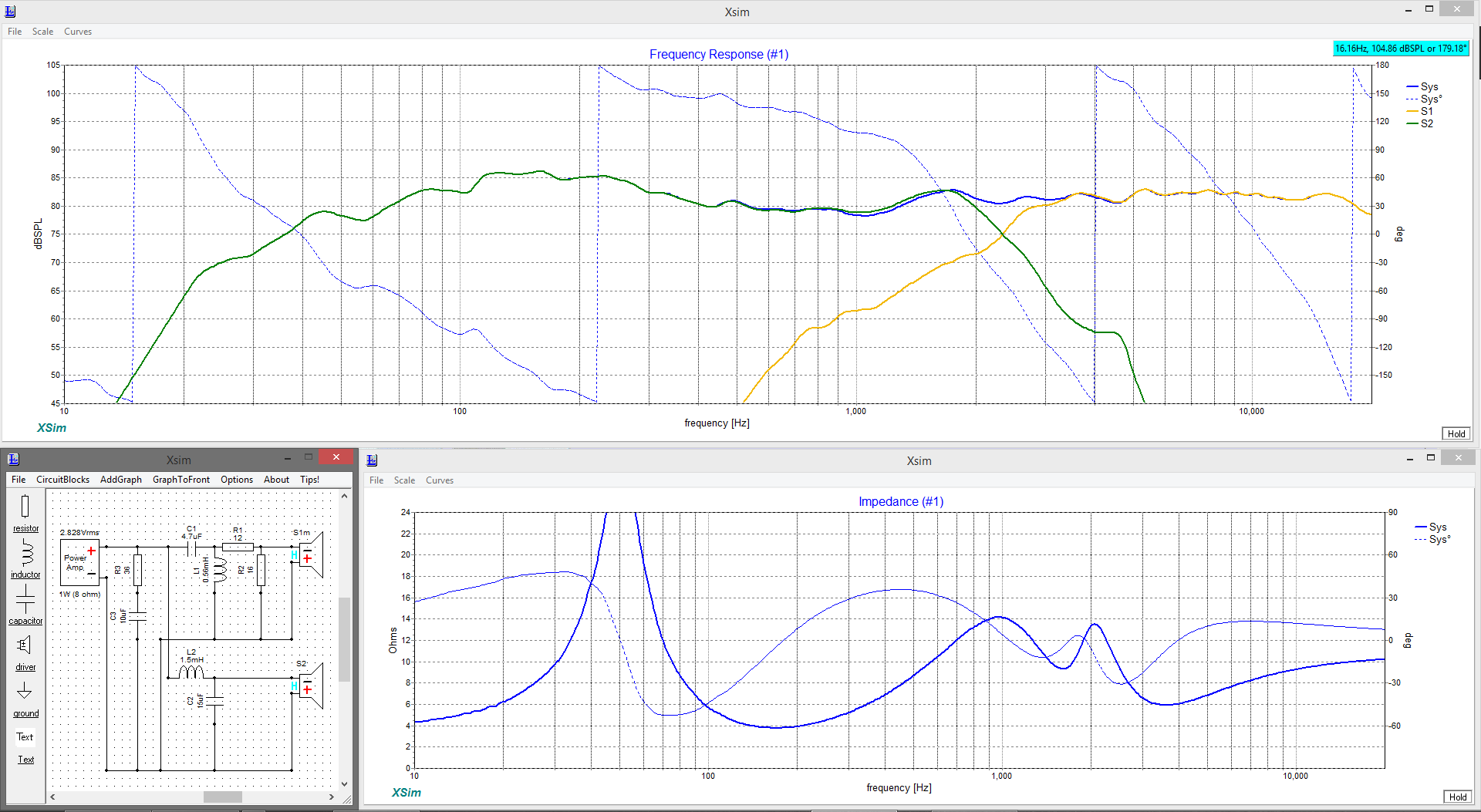

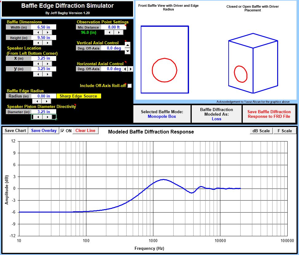

Just to show how diffraction can work and how important it is, pics 2 and 3 show baffle diffraction effects if you put the drivers on a 6.5" x 9.5" front baffle. Note that these are just examples because when you put the boxes into the old radio frame that you posted you are going to get something different again. That was why I asked if you could post the dimensions of that unit.
Pic 4 shows what the drivers' FR looks like when you add in the baffle diffraction and the vented box response to the woofer but before any xo work.

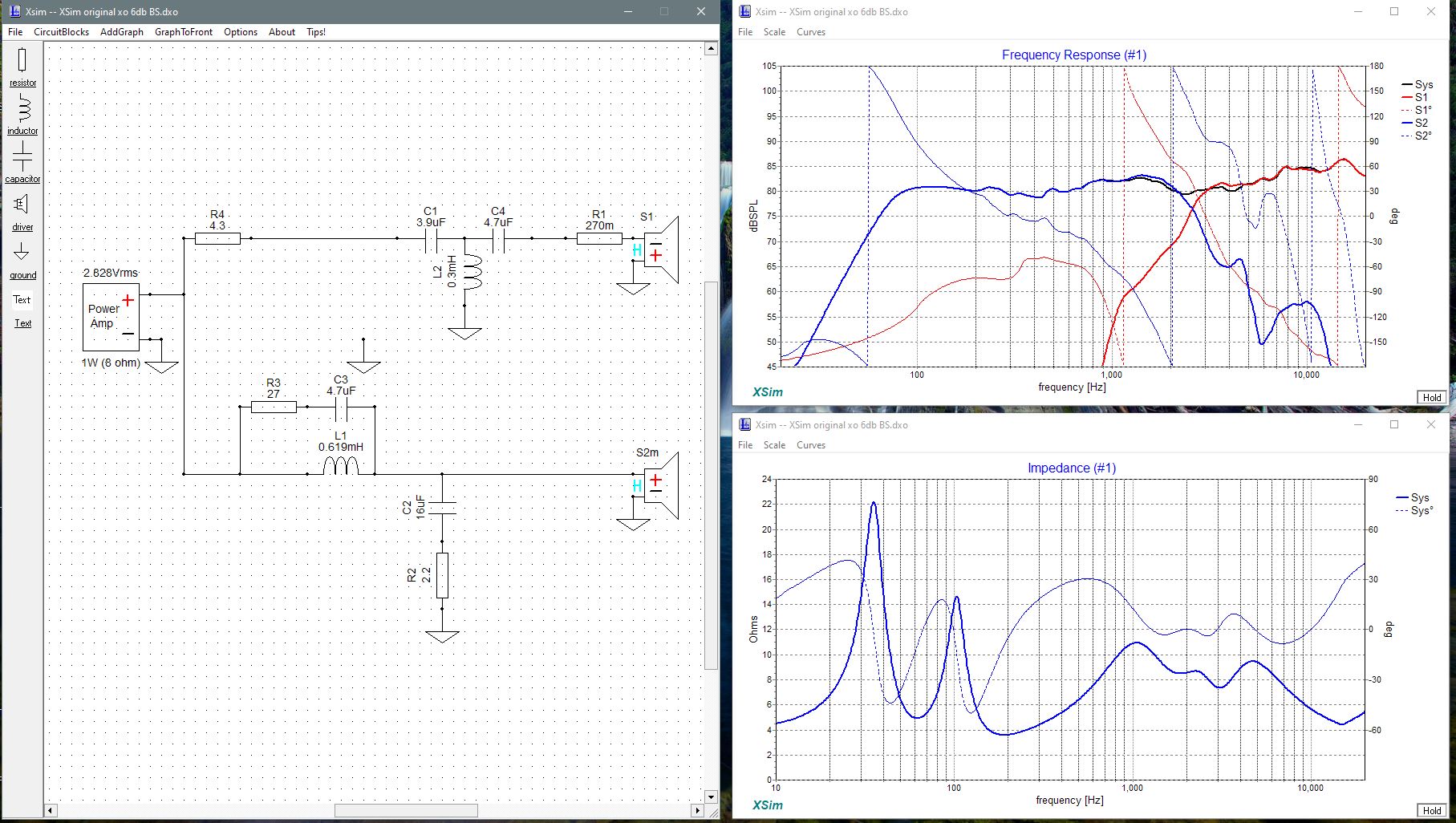

Pic 5 is a quick attempt in XSim given all the generated data. Minimum phase was derived for all frd and zma files when entering them into the program. Using the Dayton spec sheets, I arrived at acoustic centers for the tweeter of 7mm back and 25mm back for the woofer. Unfortunately, this was a bit of a guess as the woofer is not actually pictured scaled properly to the measurements given. So I took my best guess. After calculating path differences and converting to inches, I input a woofer delay of .87". Impedance for the woofer has also been changed to match its 2L vented box alignment. Note the double impedance peaks now in the LF instead of only the single one you get with a closed box.
I tried to use the minimum number of parts because with inexpensive drivers it doesn't make any sense to do otherwise. The summed response is decently flat, the drivers' phase align very well in the xo region, impedance is totally respectable for a 4ohm amp and the xo ends up at about 2600Hz. I might actually like steeper slopes in the xo for these 2 drivers, but as I say not really worth it to start adding more and more components.

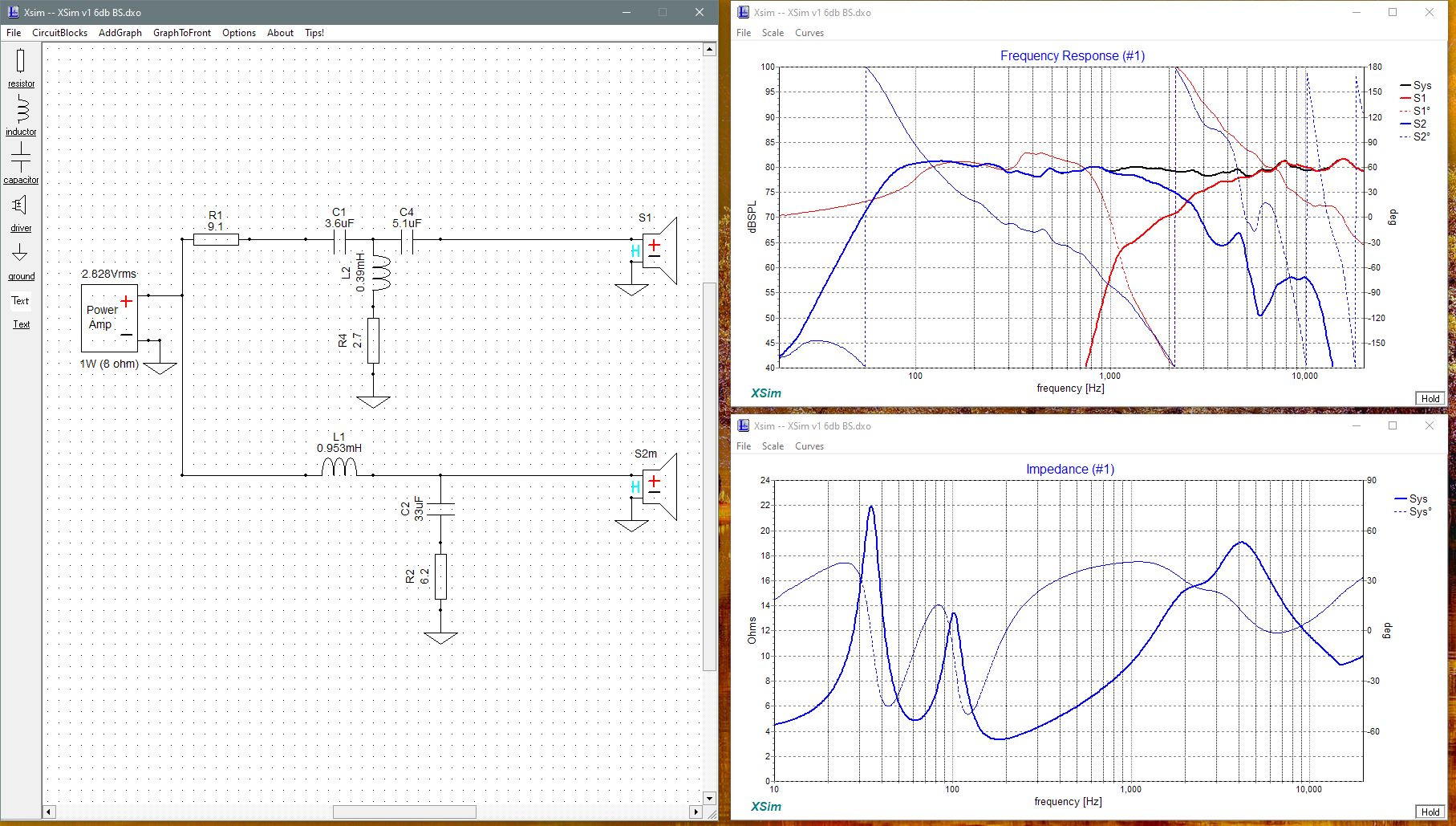

Pic 6 is what the response looks like with my frd and zma files and the 2nd xo you attached in post #16. This is just to demonstrate how different the response can be if the original files going into the simulation are not quite accurate.
Hope that helps. Please let me know if you have any questions.

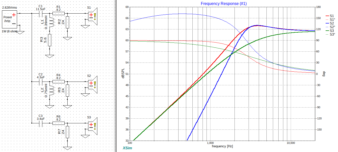

I see a lot of good thoughts, but some strange circuits for this crossover. But BSC and time alignment are indeed rather essential for a good crossover. You can do it acousticly (make sure in the box that all drivers are aligned) or in the crossover.
I did follow the example of the poster above, and used the published files the way he did (derived and so) in Xsim and used my logical way of building a cr and it's a bit different, but better i think. I don't get why you use resitors on the parallel inductors and caps in a crossover.
Anyway, this is my take... The Zorbel before the filters is optinional, but makes the speaker easier to drive by amps. Sometimes amps can't handle high impendance spikes and it influences the sound.

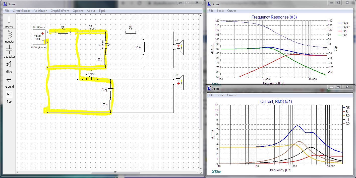

Hello Waxx ...
Please first see my comments in THIS THREAD
First a disclaimer ... I don't have the exact specs for your drivers. So the values you will see are an approximation, but they should be close. It would help if you could upload your DXO file from XSim.

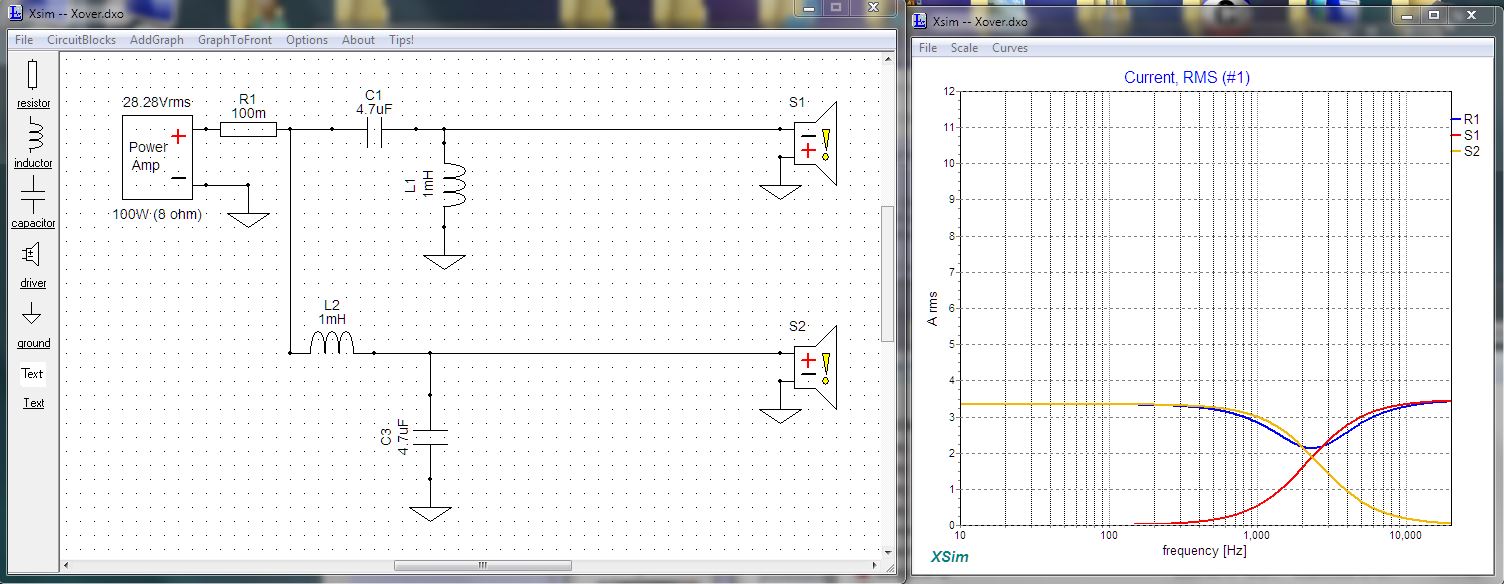

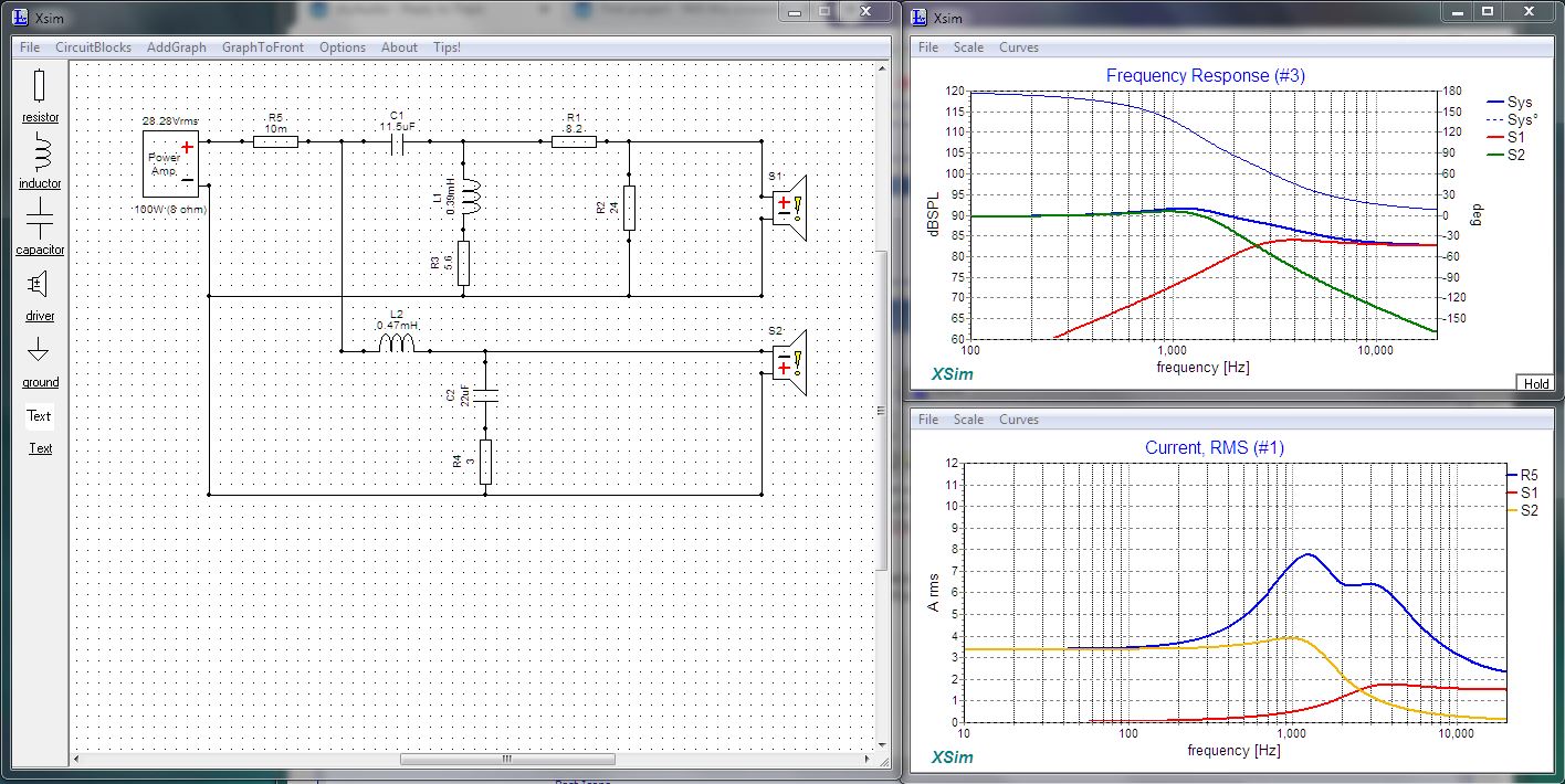

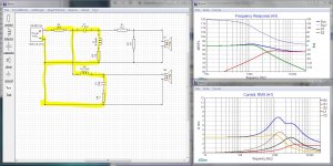

I jacked the amplifier up to 100 watts and opened the current panel...
Take a look at thumbnail #1 ... Notice the current on R5 (which simulates the speaker wire) Notice that you have a lot of current flowing that is not reaching your drivers. This is bad. In fact, it reaches nearly 5 amps of wasted current.
On a 100 watt amplifier, you should reasonably expect to draw no more than 3.5 amps on an 8 ohm load. The problem would be even worse for a 4 ohm design.
This is because your lead cap on the tweeter chain (c1) is too large. This brings excessive current into the tweeter filter that you then have to aggressively remove with L1 and R3. In fact, there is a point where R3/L1 are carrying almost twice as much current as your driver.
The same problem exists in your woofer chain. L2 is far too small, so you end up aggressively removing current with the c2/r4 chain which is again handling more current than your driver.
See thumbnail #2... I've highlighted the current paths for you.
This crossover will be very inefficient and might even overheat or damage an amplifier.
The solution is to start from a first order filter and get your crossover point where you want it. Then add parts reluctantly, keeping in mind that any current flowing that does not go through a driver is just wasted energy.
See thumbnail #3 ... This is an example of where to start.
As in thumbnail 4, any parts beyond this basic first order crossover should be to correct minor errors... not to hammer the thing into shape. Basically the second order parts are just to sharpen the driver roll-offs and smooth the frequency response, they should be handling only very small currents.
Hope this helps...

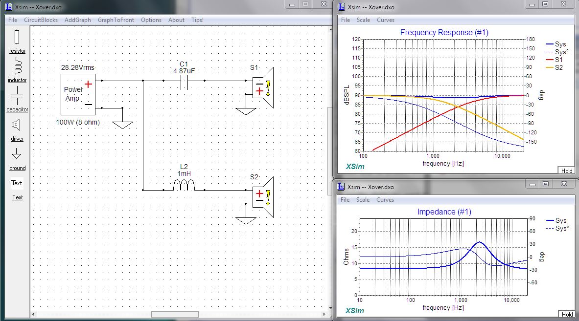

On the other hand, the damped C-RL can give a response that you won't find with first or second order.
It's about current, Allen.
His circuit was threatening to pull almost 8 amps from a 100 watt amplifier most of which was wasted in shunts to ground... it would for certain overheat the amplifier and it might even damage it. No matter what trickery the filters are up to, it's not worth it if it's going to kill an expensive piece of equipment.

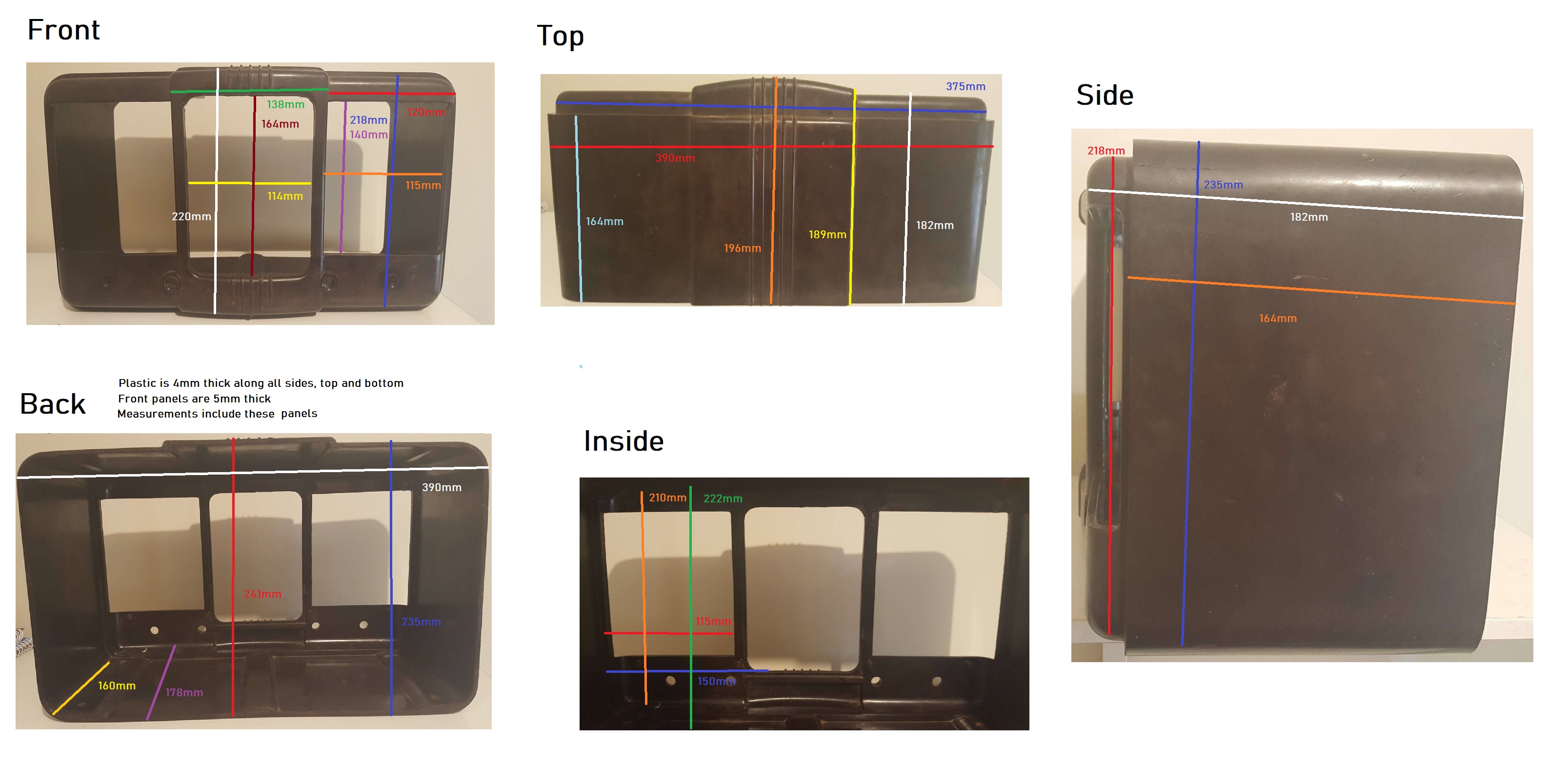

Hey guys, sorry for being awol. Im a shift worker, and im really only working on this project on my days off. I havnt yet read through all of the comments you guys have left, but what i have read looks super helpful, and im looking forawrd to reading the rest. Thanks guys. I think the enclosure im hoping for is a bit smaller than what some of you are thinking, but ill do some measurments and put up a blueprint today, along with some more detailed responces to your feedback.
Ok so heres what i have blueprintwise. I hope its not too confusing.
The bottom line is that due to bevels in the internal structure, the speakers can either be 222mm high x 160mm deep x 115-150mm wide
Or they can be 210mm high x 178mm deep x 115-145mm wide.
Logistically, those first set of measurments are preferable to me. I could maybe make them go a bit deeper, but they would be sticking out the back of the enclosure.
These measurements include whatever material will be used to make the enclosure. Please note that any vent will have to factor in the size of the front holes.
Thats assuming that a left and a right speaker make sense in this space. That was my original plan, and id like to make that happen, but Im open to suggestions. Be that smaller drivers, a different style of enclosure, a single larger speaker, or something else.
