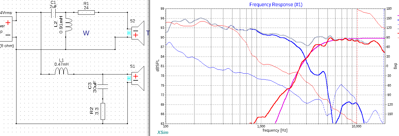

Douglas Blake Post #48 (Image 2 - I put it into Xsim myself to get all the grpahs. Please let me know if thats incorrect)
Why didn't you just download and use my DXO file then open the graphs from the menu at the top of the main window and set up the curves from the menus on each sub-window? I do wish XSim would store it's screen configuration with the project data... but it doesn't.
These all appear to me to do the job quite nicely. Out of the 3, Douglas Blake's seems to be the cheapest and simplest, so im leaning in that direction.
You might want to tinker with the part values just a bit, to be sure it's fully optimised for your drivers.

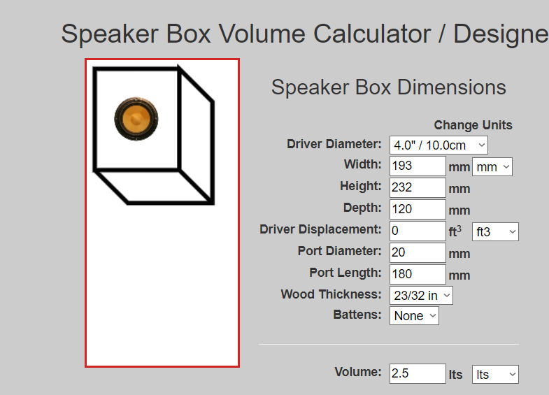

- if the TCP115-4's specs are close to correct, all the driver needs for a vented alignment is 2L. 2.5L or maybe even 3L is probably workable but I wouldn't go any larger than that. I figure you'll have about 4L plus or minus in the new cabinet design.

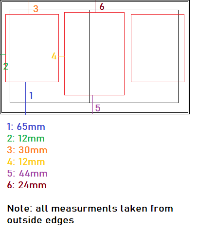

- just for the best simulation accuracy, can you give me the measurements from 1) the bottom of the unit to the bottom of the left window opening and 2) from the left side of the unit to the left window opening.
I figure i can tweak the volume of the speaker cabinet by changing the depth of the speaker boxes. If i take them from 160mm deep to 120mm then it comes out at 2.5L (image 1). I know you have reccomended that the radio be placed flush to the wall, does having a gap between the speaker box and the back of the radio shell compromise this?
Please see image 2 for clarification on where these measurments apply to:
1) 65mm (bottom of the unit to the bottom of the left window opening)
2) 12mm (from the left side of the unit to the left window opening)
3) 30mm (top of the unit to the top of the left window opening)
4) 12mm (width of pillar between windows)
5) 24mm (bottom of the unit to the bottom of the middle window opening)
6) 24mm (top of the unit to the top of the middle window opening)

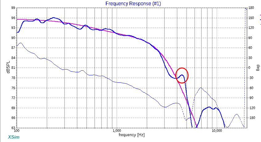

You said cheap and simple. I looked for the optimum blend of simple and doing it properly, and ended up with three components per driver.
In the first image the target (pink) includes consideration for the baffle size. The peak in the red circle is a part of the response that needs to be cut down, and here it is down at least 12dB.
There is a dip at 3kHz, this is probably not a bad thing.

That's a nice job by Allen showing 1 of the issues with the TCP115. He didn't point it out but he has also likewise attenuated the nastiest part of the tweeter response, its resonance frequency at about 1200Hz, so that it too is way down in SPL. Go back now and look at the xo sim, image 2, in your post #80 to see how both of these things are not taken care of. Not so good. But I don't think that sim was intended as anything other than an example to show current consumption effects. I'm just guessing there as it wasn't mine.

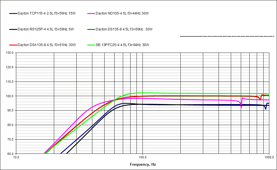

As you are looking at drivers, I'm hoping that you are putting them into a box modeling program, like Unibox (but requires Excel) or WinISD, and looking at box volume, f3, xmax and max SPL, wattage required and port requirements. Attached below shows you what I am talking about. Some drivers need bigger boxes, some go lower than others, some will play louder and some need more power to do so. I've listed everything except the port info. All of them are at their reasonable max SPL before xmax is exceeded above 50Hz and the voice coil starts traveling outside of the magnetic gap and distortion and compression start to increase. (The DS135 and the DSA135 have virtually identical responses btw so the lines overlap and can't be seen individually.)
Looking at the FR's, only the DSA135 looks to me like it will be slightly problematic for a higher xo point. The rest look fine to me although that's without doing the sims.
