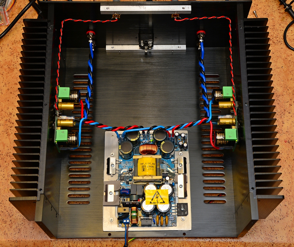

Very nice and clean layout as it should be, congratulations. Input wire should be OFC solid core twisted pair for the best SQ.
You're probably the first one implemented Coldamp SMPS, how do you like it since it has regulated output voltage?

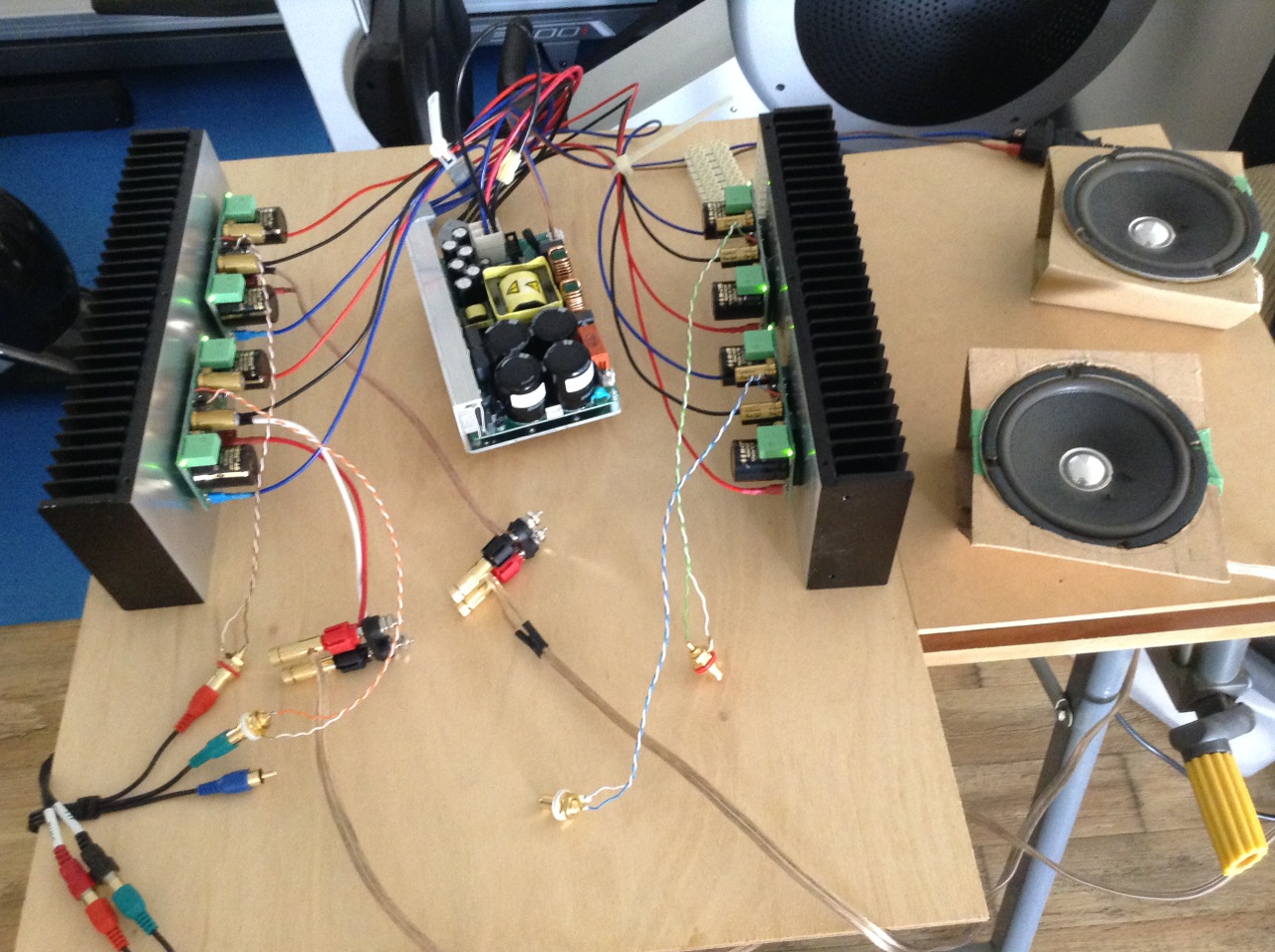

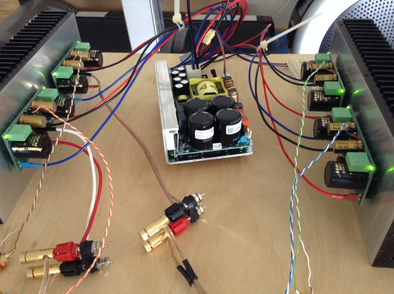

Hi Guys,
I wanted to post some pictures of my multi channel test setup as it works! 🙂
I have four channels running from one SMPS1200A180. Output voltage from power supply is measured as +/- 47 V.
The SMPS started up fine took a couple of seconds before the relay clicked and then power to all four modules was supplied.
Unfortunately my test setup let me down and I have a slight problem. I was using an ipod for input and the cable had a bad connection and this has caused some of the resistors to smoke. 😡
The problem is repeatable as when I was testing the other side it happened again! 😱
It does not stop the amp from functioning and I cannot detect any difference in the sound although as you can see the test speakers are not too revealing.

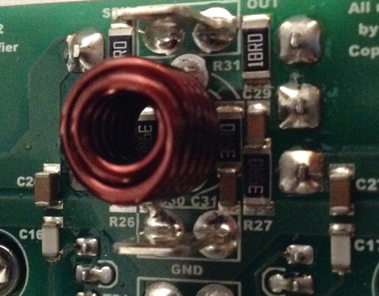

I have attached a picture showing the scorching on the resistors. The picture is not great but you can see the difference between the upper resistor where the text is whiter. I turned the power off quickly so the scorching was minimal.
The resistors affected are R26, 27, R30 and R31 the ones closest to the inductor marked as 39R0.
LC, can you tell me what part of the circuit these parts are in and if I need to replace them?

Thanks for the info. I have measured a good module and they are all 39 Ohms.
The scorched ones measure as 39, 41 and 49.
I am not sure how easy it will be to replace these as I don't have an SMD rework station.
Are the parts glued down or will they come away easily enough with a soldering iron and tweezers?
Dunno what to say... one is clearly off, but it's probably preferable to leave things as they are if you have no equipment or experience with smds.
Two normal soldering stations will suffice, but you should experiment on some less audiophile boards first. And what better excuse to buy a hot air station? 🙂

What you have to know is the heatsinks are normally part of a grounded chassis, but in your case both of them nicely floating in mid air as an electric potential concerns. It would be fine to connect heatsinks to common earth potential, also in between testing period, otherwise each heatsink will act as a nice antenna, picking up el. mag. signals and forcing them directly to module's GND potential, which is not so good. Large HF signals at amp's output cause zobel resistors to dissipate few Watts, which is quite normal but only for a short period of time. Output power mosfets can withstand these signals at much higher extent without any problem, since zobel resistors wattage is calculated to amp's full swing at 40 kHz, higher frequencies than that will make these resistors to smoke or even die in flames. Originally these are 39 Ohms, four in parallel can dissipate 3 W. In your case if they still measure 36-42 Ohms leave them as they are otherwise replacement is recommended. 😉
