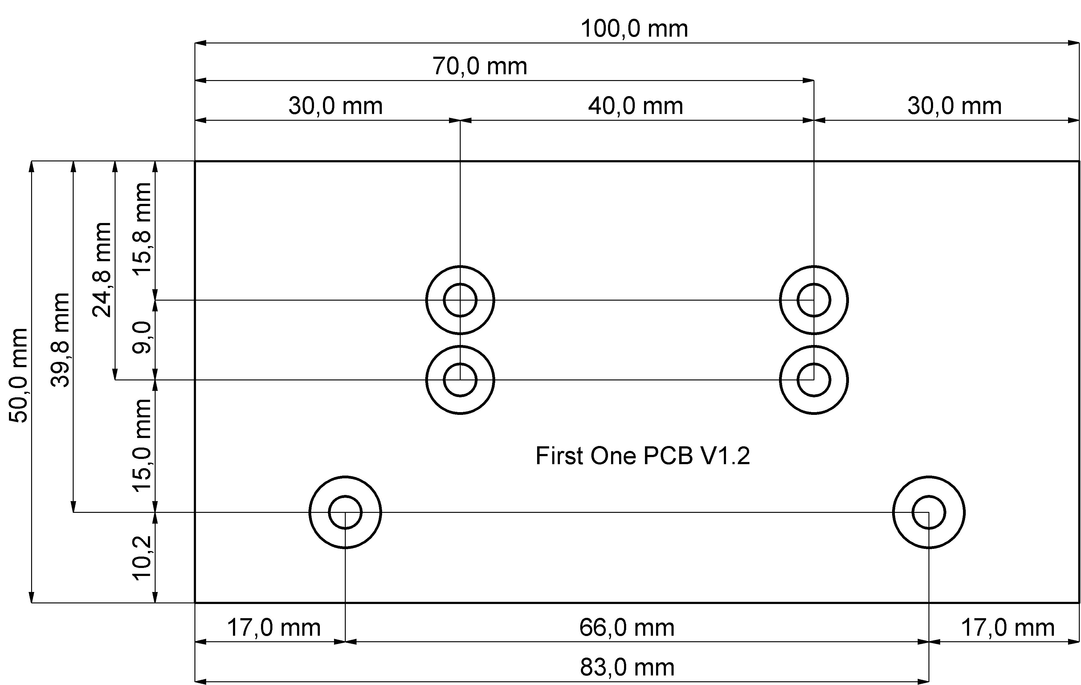

Do
Do you have a document that states what the drill pattern for the heat sink is?
Thanks,
Robert
Hi Robert
Here's the mounting holes dimensions plan. It has to be oriented as drawn, so the lower edge of the drawing to the lower edge of the heatsink, for proper heat distribution. ;)
