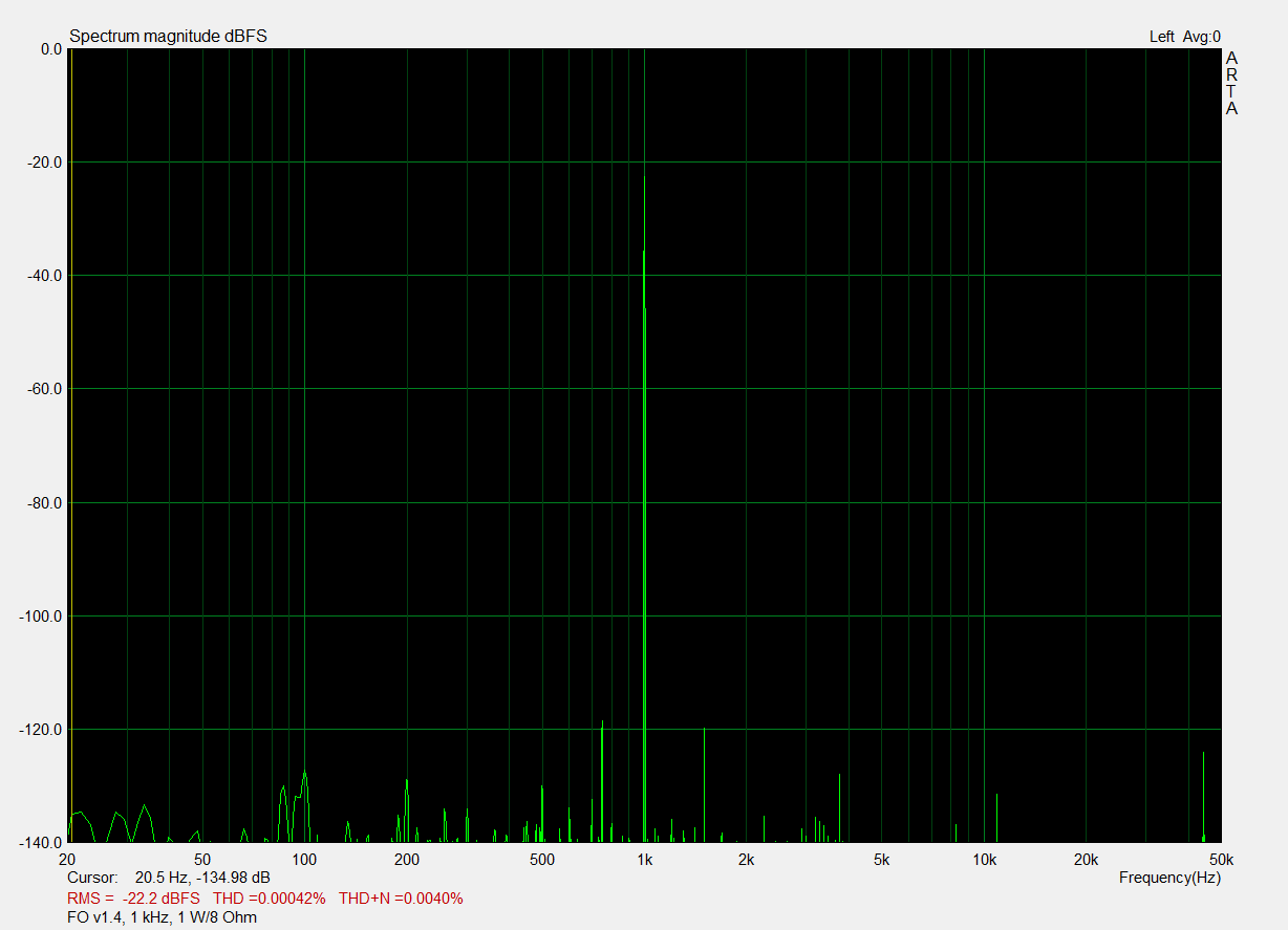

Hi guys
New Year 2015 will bring First One v1.4 and VSSA v1.5 based on initial 4 ppm THD 1 Wrms/8 Ohm real world measurements.
100 Hz is well suppressed at around -130 dB.
Stable output DC offset without DC servo.
Same size, same fixation holes layout, same power, same price.
Stay tuned, L.C.

Strange: No harmonics in your graph, where they are supposed to be ...real world measurements.
Yes, agree, still a lot to be done before official launch, but I'm well railed on the track.Wow.. I am glad 2015 is just days away!

Signal harmonics hidden bellow noise level, some signal generator - sound card and PC artefact spikes present, lowering THD+noise but that's clearly avoidable with real source connection to be present.Strange: No harmonics in your graph, where they are supposed to be ...
