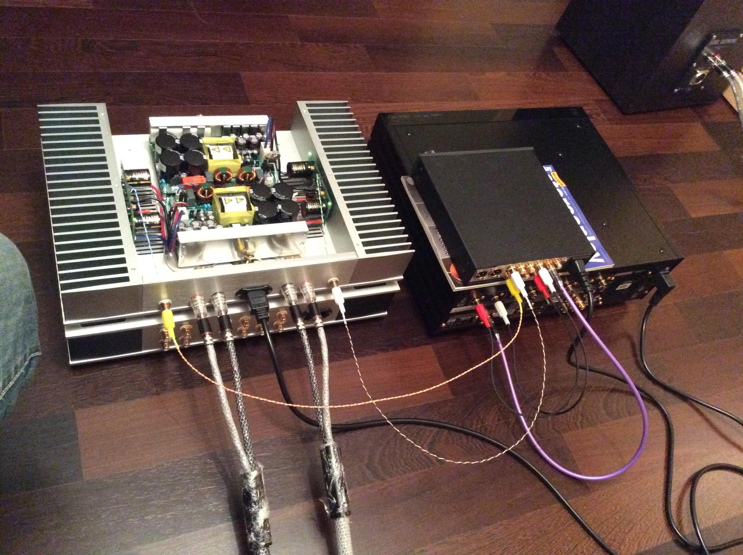

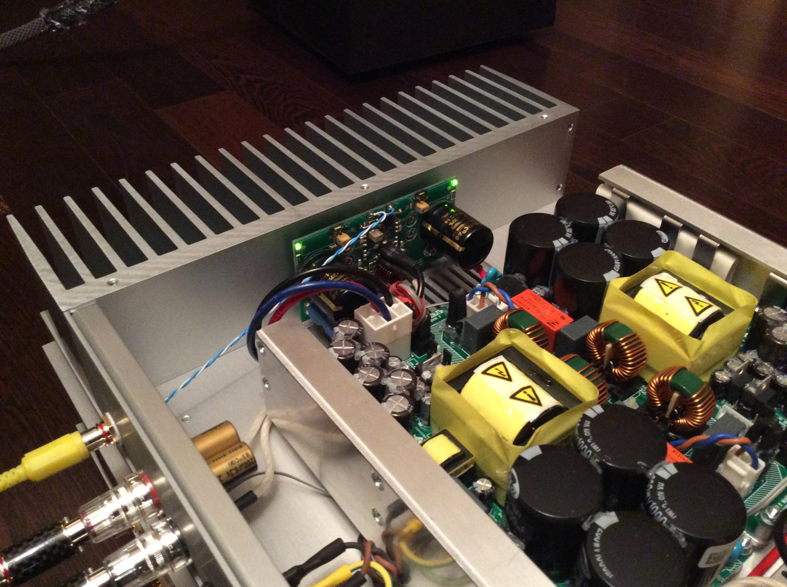

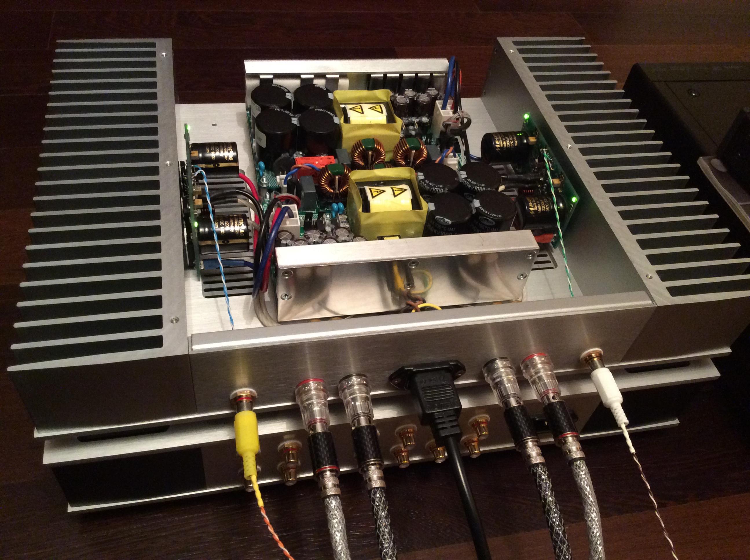

Entire stack looks like as seen in the pics, under First One v1.4 amp you can see First One preamplifier, Soul Supreme speakers are visible only in a small portion - lower edge corner.How about a few more photos of the pre-amp? What does the entire stack look like?
Preamp pics I could upload soon.
