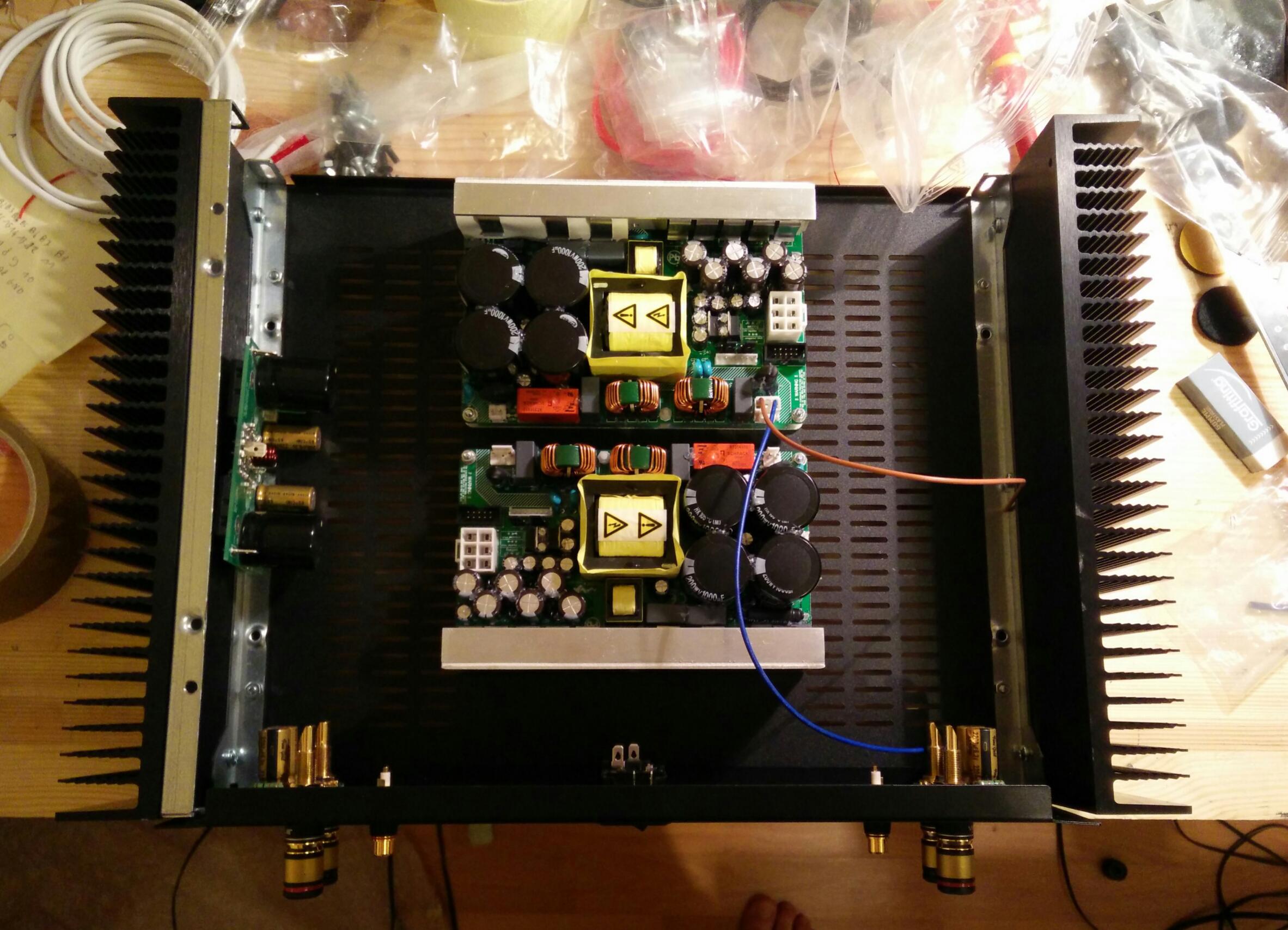

Very nice layout but be careful First One module is positioned wrong, power transistors have to be located at bottom side of the case, meaning +/- input pads to upper side of chassis, near the cover plate.I start building my first First One [emoji1]
The FO is just put inside for the picture!
But thank's I don't know the FO have up ans down
It is a matter of air movement(warm:up and cold:down),hence the heat producing parts (i.e. power transistors) must be located near the bottom of the heatsink for better cooling.
